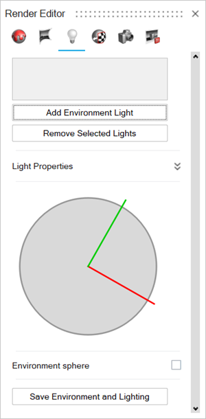

Add Environment Lights
Add ambient lighting to your scene.
On the Rendering tab, select the
Editors tool.
The Render Editor appears.
Select the Environment Lights tab.
- Next to Environment Lights, click the chevron.
Do one of the following:

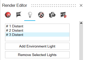

- To add an environment light at the default location, click the Add Environment Light button.
- To interactively add an environment light:
- In the Render Editor, turn on Environment sphere.
- While holding down Alt, click the desired location in the modeling window.
Note: You can add up to three environment lights.The lights are added to the list.

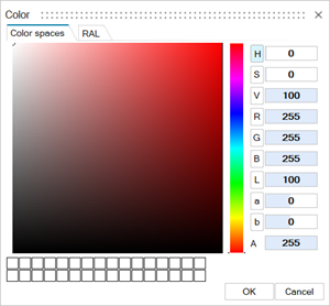

Change the color - Under Light Properties, do
- Next to Color, select preview image. By default, it is a white box.
, then click
Select a Color.
- Define the color of the light, then click
OK.

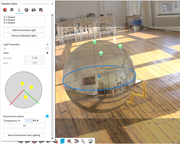

- In the modeling window, a sphere appears with light
bulbs, indicating lights and their positions within
the environment sphere. Selected lights are outlined
in yellow.
- Click a light.
- In the microdialog, next to
Color, select
, then click
Select a Color. - Define the color of the light, then click
OK.
Reposition a light In the illustration, drag a yellow circle, which represents a light in the scene.
light bulbs, indicating lights and their positions
within the environment sphere. Selected lights are
outlined in yellow.
- Drag a light.Note: To reposition multiple lights simultaneously, hold down Ctrl while dragging the lights.

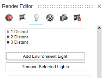

The Fit option is only available in the Render Editor. Remove a light - Select a light from the list or in the illustration.
- Click Remove Selected Lights.
Remove Selected Lights is only available in the Render Editor. -

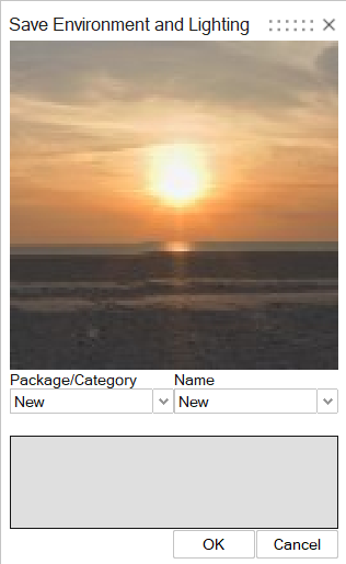

To save the environment and lighting parameters to use as a preset later, click
Save Environment and Lighting.

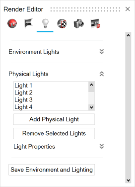

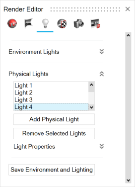

Add Physical Lights
Add point lights, which radiate light in all directions and are useful for generating soft shadows. Common examples include light bulbs and candles.
Editors tool.
- Next to Physical Lights, click the chevron.
For each light you want to add, click the Add Physical
Light button.
To modify the lights:
To Do this Turn lights on or off in the final rendering Under Light Properties, enable the On switch. Disable the switch to turn the light off. Lights that are on are highlighted yellow in the modeling window.
Lights that are off are hidden.
Change the light type Under Light Properties, from the Type dropdown menu, Point is currently the only option available. Change the unit Under Light Properties, from the Unit dropdown menu, choose from the following: - Watts/LED
- Watts/Incadescent
- Lumens
The Power value is adjusted automatically.
Adjust the power Under Light Properties, enter the Power. Change the color of a light It is recommended to use subtle, light colors for better results. - Under Light Properties, do
, then click
Select a Color.
OK.
Reposition a light In the modeling window, drag an arrow to move the light along the x-, y-, or z-axis. Change the physical size of the light Under Light Properties, enter the Size. Remove a light - Select a light from the list.
Show a light in interactive rendering mode Under Light Properties, turn on Show/Hide. Hide a light in interactive rendering mode Under Light Properties, turn off Show/Hide. -
The Save Environment and Lighting window appears.
