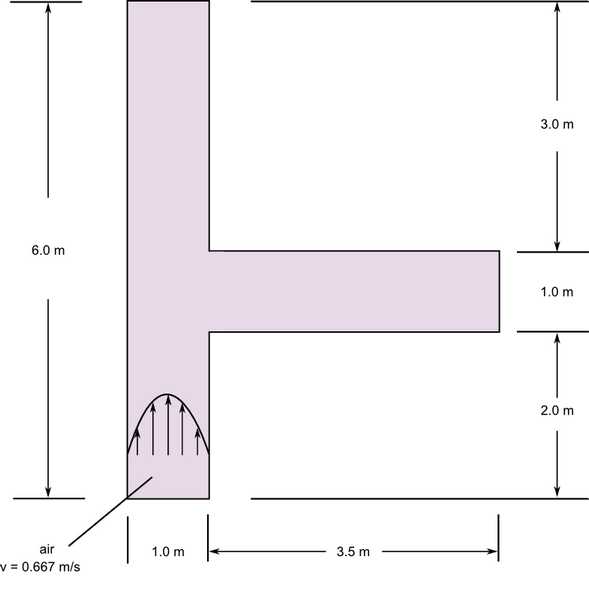

The problem consists of air flowing past a T-junction in a channel, as shown in the following image, which is not drawn to scale. Air enters the channel with an average velocity of 0.667 m/s and travels past the T-junction 2.0 m from the inlet. A portion of the flow will travel out of the branch of the channel due to the pressure difference between the bulk flow and the outlet of the branch.
Figure 1. Critical Dimensions and Parameters for Simulating Laminar Flow Past a 90° T-Junction

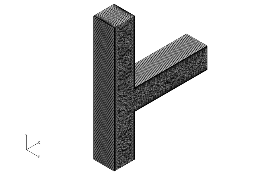

Figure 2. Mesh Used for Simulating Laminar Flow past a 90° T-Junction

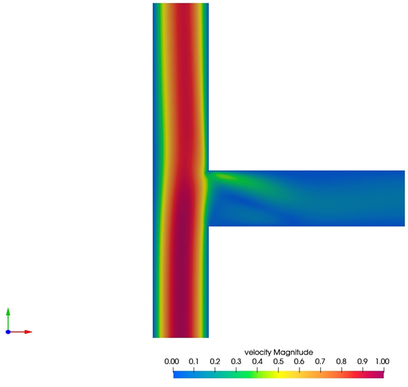

The AcuSolve solution converged to a steady state and the results reflect the mean flow conditions. As the air flows past the junction, a portion of it is diverted into the branch. A small recirculation region develops at the top of the junction and collapses before the flow exits the domain through the right branch.
Figure 3. Velocity Contours in a T-Junction
The experimental value for the fraction of flow exiting the top branch of the channel is presented with the corresponding AcuSolve result in the following table.
Table 1.
Experimental fractional flow AcuSolve fractional flow Percent deviation from experimental
Fractional flow exiting the upper branch 0.887 0.889 0.332
Summary
The AcuSolve solution compares well with experimental results for flow past a T-junction. In this application, flow is driven by a fixed flow rate at the inlet to the main branch. A portion of the flow from the main branch is diverted into the right branch of the T-junction, giving rise to recirculation just downstream of the junction. This recirculation collapses before the flow exits the side branch. The AcuSolve result for fractional flow exiting the top branch is within 0.33 percent of the experimental results.
