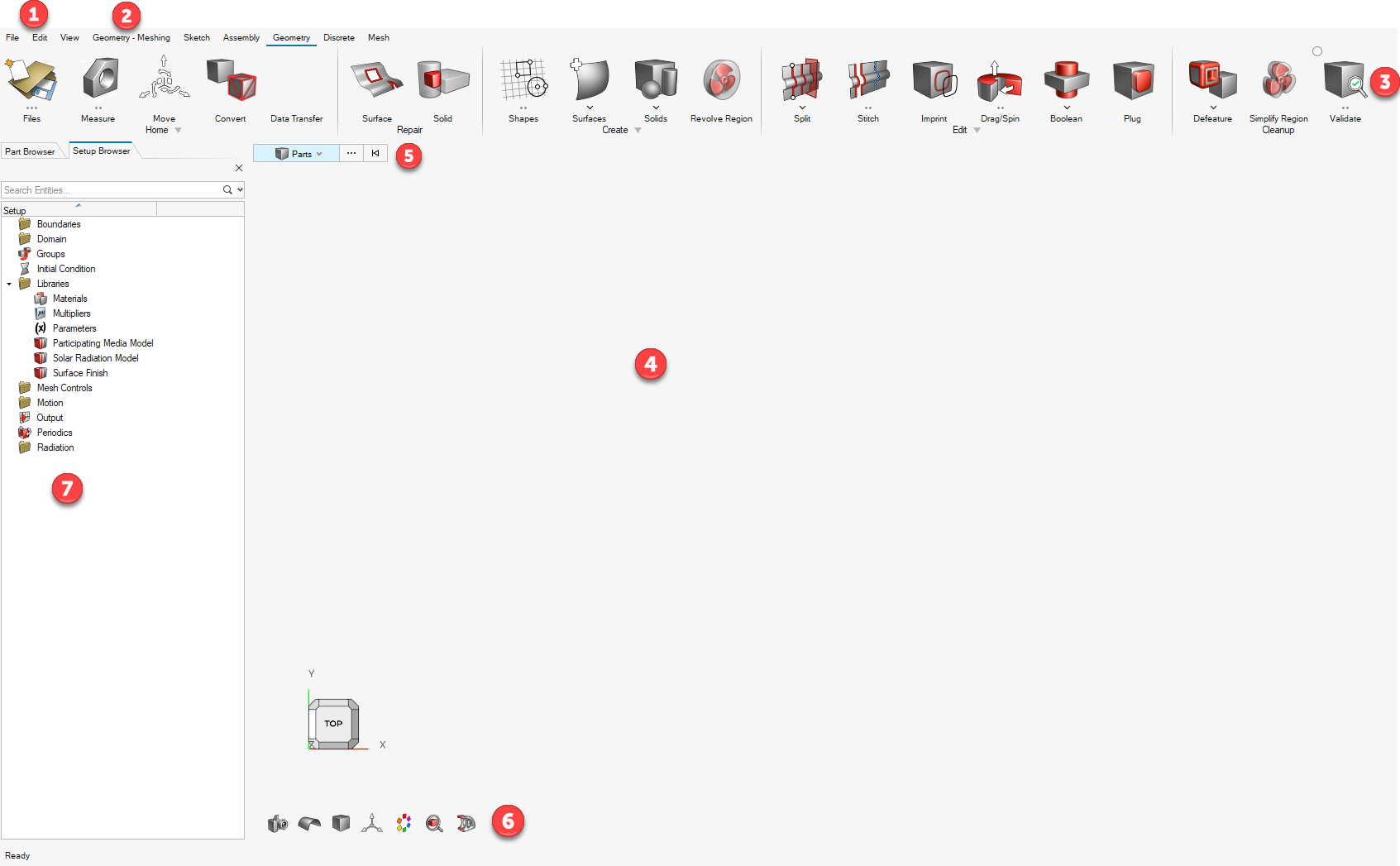

The HyperMesh CFD graphical user interface can be divided into seven general categories as shown in the figure above.
- The menu bar contains the drop-down menus for File input-output, Edit, and View operations.
- The modeling environment switcher is used to populate relevant ribbons and tools based on modeling tasks.
- Ribbons contain various functionalities and tools available in HM-CFD. Navigate
between various ribbons by clicking the ribbon tabs to the right of the modeling
environment switcher. After selecting a ribbon, the corresponding tool icons are
displayed on the screen. The functionalities of various ribbons and corresponding
tools are briefly explained in this section.
- Sketch ribbon
- The Sketch ribbon provides multiple ways to define sketching plane
by selecting planes aligned with global coordinate systems. You can
also get references of existing geometry by cutting geometry or
projecting geometry to a plane. It provides capabilities to create
sketches using multiple interactive tools. A dimensioning capability
enables you to parametrize dimensions of sketches. One of big use
case for CFD is to get cutting lines of rotating geometry and create
a non–cylindrical axisymmetric MRF region around them.
Figure 3.
- Geometry ribbon
The Geometry ribbon consists of tools for repairing, creating, editing, and validating the geometry.
When a geometry file is imported, the Repair tools can be used to detect any defects present in the CAD model like intersections, free edges, duplicates, sliver surfaces, and so on and fix those errors.
The tools available under the Create sub-section can be used to create geometric entities like points, lines, surfaces, and solids.
The tools required for performing operations like plugging cavities, stitching surfaces, and so on are available under the Edit sub-section.
The Defeature tool can be used to resolve defects or model a new geometry, while the Validate tool can be used to detect any defects present in the CAD model. This process is usually known as CAD cleanup.
Figure 4.
- Discrete ribbon
The Discrete ribbon consists of tools used for working with FE geometry. You can cap openings, connect geometry, define local or proximity-based wrap controls, enclose the model, remesh the enclosed results, and fix the mesh quality.
- Assembly ribbon
- The Assembly ribbon is useful for finding, managing, and organizing the parts in your model.
- Flow ribbon
The Flow ribbon contains tools for setting up simulation parameters, solver settings, and reference properties such as material properties, heat sources, porous media, and so on. The Setup sub-section is where you set up the physics equations and solver settings as well as create material models, multiplier functions, and parameters.
Figure 7.
The Domain sub-section contains tools for assigning reference properties such as materials, heat and momentum sources, and reference frames to volumes.Figure 8.
Surface boundary conditions such as inlets, outlets, and far fields, can be assigned using the tools under the Boundaries sub-section. By default, all the surfaces are assigned a boundary condition of type ‘auto_wall’ and are placed under Default wall. Refer to the AcuSolve Surface Processing manual for more information about auto_wall. As you assign boundary conditions to the surfaces, they are moved into the respective group.Figure 9.
- Radiation ribbon
The Radiation ribbon is where you define radiation physics, create thermal, solar, and participating media models, and apply radiation parameters.
Figure 10.
- Motion ribbon
Mesh boundary conditions and mesh-motion-related parameters can be defined using the tools available in the Motion ribbon. Parameters such as mesh motion type and mesh displacement constraints can be defined here. In addition to the mesh boundary conditions, code coupling with external codes such as OptiStruct and MotionSolve can be defined here
Figure 11.
- AcuTrace ribbon
- The AcuTrace ribbon computes particle
traces as a series of segments solving particle motion. It computes
traces for unsteady as well as steady flow fields, for flows with
mesh motion as well as without, and for flows computed on meshes
with interface surfaces. To solve a problem with AcuTrace, you must first run AcuSolve. You can set up for finite mass and
massless particles.
Figure 12.
- Mesh ribbon
Meshing parameters such as surface mesh controls, boundary layer parameters, volume mesh parameters, and zone meshing parameters can be defined here. This ribbon also has tools for local remeshing. Once all the mesh controls are defined, you can generate the mesh using the Volume tool.
Figure 13.
- Aerodynamics and Aeroacoustics Setup
- The setup ribbon is used carry out external aerodynamics and fan
noise simulations with the ultraFluidX
solver.
Figure 14.
- Solution ribbon
The Solution ribbon is used to set up monitors for any individual point, surface, or volume set output. The Field tool is used to set the nodal output frequency for the entire model. The Initialize tools are used to set the nodal initial conditions for variables like pressure, velocity, and variables specific to each turbulence model.
Figure 15.
Once the complete set up is done, the Run tool is used to launch AcuSolve. Once the AcuSolve run parameters are set, the simulation can be started, and you can monitor the status of the run using the run manager.
- Post ribbon
- The Post ribbon is where you can post-process the results. The
Visualize tools under the Post ribbon can be used to create things
like plots, streamlines, iso surfaces, and section cuts. The
Measures tools can be used to probe variables at desired
locations.
Figure 16.
- Morphing Ribbon
- The Morphing ribbon is used to morph mesh or FE geometry. You can define constraints to fix some nodes or define relative movement.
- The modeling window is where the model is displayed. The
model display can be manipulated using the view controls shown in the table below.
Clicking on the model will highlight the entity being selected and right-clicking on
an entity will give you additional options for the operations that can be done based
on the context. Some of the functions available using right-click are Show, Hide,
Isolate, Select, Advanced select, Create groups, and so on.
Button Operation Middle mouse scroll Zoom in and out Right-click hold and drag Pan the model Middle mouse click hold and drag Rotate the model Left-click Select entity Ctrl + Left-click Select multiple entities Left-click hold and drag Window select Shift + Left-click Deselect entities - The entity selector enables you to control what entities can
be selected using the left-mouse button. The selector can be set to any of the
entities shown in the figure below. When you open any tool, the selector is
automatically set to the entity (entities) which are appropriate for that
command.
Figure 18.
- The visualization of the model can be controlled using the tools available in View
Controls toolbar. The display of mesh, model coloring, section cuts, standard views,
and so on can be controlled using these tools.
Figure 19.
- The browsers show the entities and setup parameters in the model and list them in a tree structure. They can be turned on or off from the View menu. Some common functions that can be performed in all browsers are show, hide, and isolate.

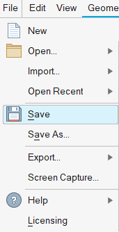

Create a new .hm database in
one of the following ways:
- From the menu bar, click .
Figure 20.
- From the Home tools, Files tool group, click the Save As tool.
Figure 21.

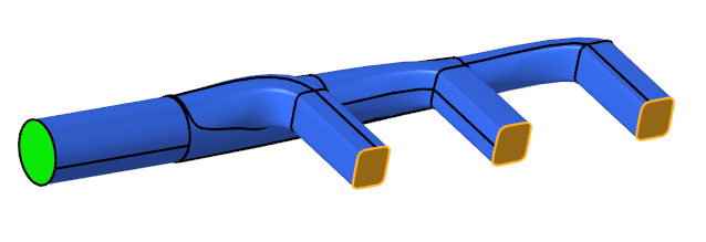

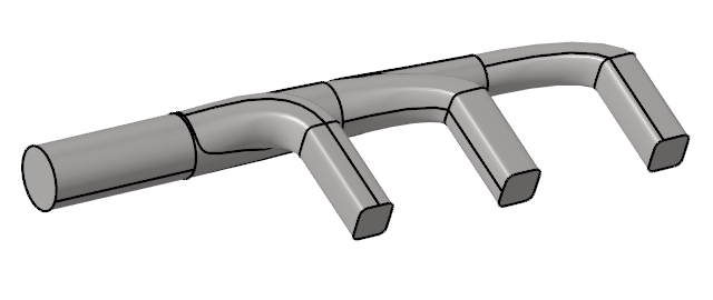

Import and Validate the Geometry
Import the Geometry
- In the Import File dialog, browse to your working directory and then select ACU-T1000_manifold.x_t and click Open.
In the Geometry Import Options dialog, leave all the
default options unchanged and then click Import.
Figure 22.
Once the geometry is loaded, rotate and observe the features of the model.

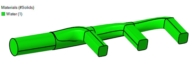

Assign Material Properties
Figure 29.

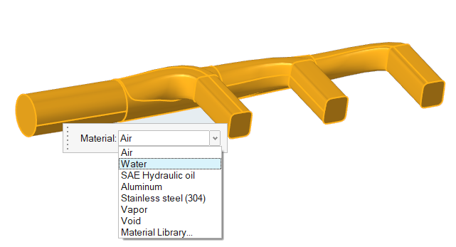

From the modeling window, click anywhere on the
manifold.
The entire manifold geometry is highlighted and a Material microdialog appears.
Figure 30.
- Click the drop-down menu and select Water from the list of materials.
On the guide bar, click
to execute the command.
The changes made in the tool are not effective until they are executed by clicking the icon.Once the command is executed, the color of the geometry changes to indicate the material assigned to the volume. In this case, there is only one volume in the geometry so there is a single color. Alternatively, if there are multiple volumes with different materials assigned, the model will be displayed accordingly with distinct colors for each material assigned.Figure 31.
to exit the
tool.

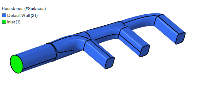

Assign the Flow Boundary Conditions

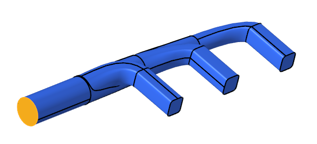

The current model has one inlet, three outlets, and walls for the rest of the surfaces. When a geometry model is imported into HyperMesh CFD, all the surfaces are placed in the Default Wall (i.e. Type = auto_wall). As you start assigning the surface boundary conditions, those surfaces are moved into a new boundary condition group. All the surface boundary condition tools are placed under the Boundaries sub-section of the Flow ribbon.
From the Flow ribbon, Profiled
tool group, click the Profiled Inlet tool.
Figure 32.
In the modeling window, click the surface of the
inlet.
Figure 33.
Observe that a new group named "Inlet" is created under the Boundaries list in the top-left corner of the modeling window. Once the current command is executed, the highlighted surface will be moved into the Inlet group. -

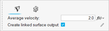

In the microdialog, enter a value of
2.0 m/sec for Average velocity.
Figure 34.
The color of the inlet surface in the modeling window is updated.Note: The color assigned to the surfaces is random. Therefore, the color of the surfaces shown in the images below might be different from what you see on your screen.Figure 35.

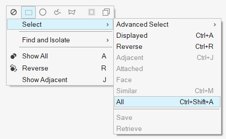

Right-click in the modeling window and go to .
Figure 40.
All the surfaces in the model are highlighted and a dialog for surface mesh parameters appears. -

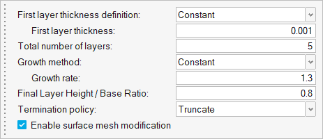

Define the Boundary Layer Mesh Parameters
From the Mesh ribbon, click the Boundary Layer tool.
Figure 42.

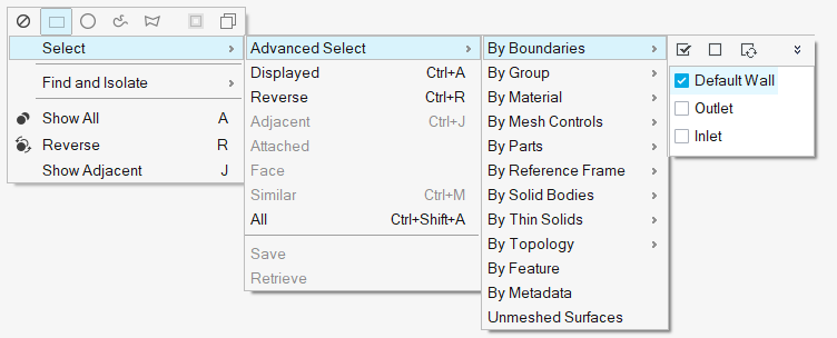

Figure 43.
All the wall surfaces are highlighted and a dialog for boundary layer parameters appears. -
Enter the values in the dialog as shown in the figure below.
Figure 44.

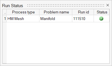

Click Mesh.
Once the meshing process has started, the Run Status dialog appears. To view the status of the meshing process, right-click on the process row and select View log file.Once the meshing is done, the run status is updated accordingly, and you are automatically moved to the Solution ribbon.
Figure 47.

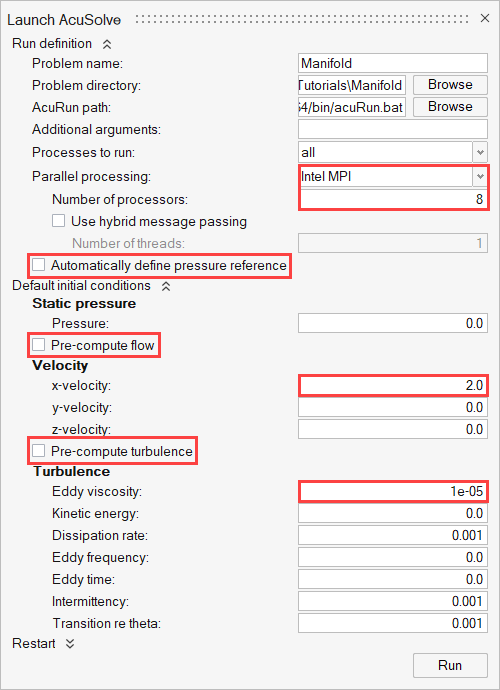

Run AcuSolve
Figure 48.
- In the Launch AcuSolve dialog, verify that the Problem directory and AcuRun path are pointing to the correct location.
- Set the Parallel processing option to Intel MPI.
- Deactivate the Automatically define pressure reference option.
- Expand the Default initial conditions menu.
- Deactivate the Pre-compute flow option and enter 2.0 m/s for x-velocity.
- Deactivate the Pre-compute turbulence flow option and enter 1e-5 m2/s for Eddy viscosity.
Leave the remaining options as default and click
Run to launch AcuSolve.
Figure 49.

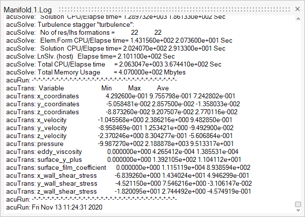

The Run Status dialog opens again and the AcuSolve run appears on the list. -
Right-click on the AcuSolve run and select
View log file.
A summary of the run printed in the dialog indicates that AcuSolve has finished running the simulation. Once the solution is converged, the Status will be updated accordingly.
Figure 50.

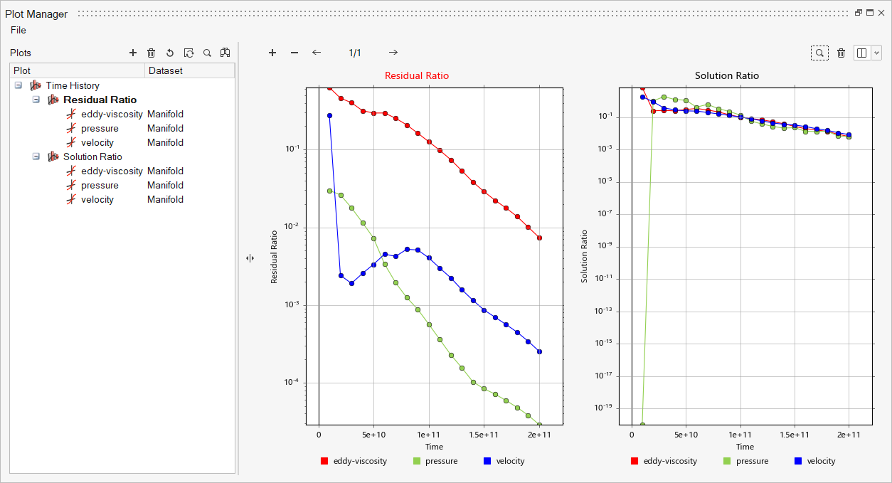

In the Run Status dialog, right-click on AcuSolve run and select Plot time
history to launch the Plot Manager.
Figure 51.
The above plot shows the residual and solution ratios of the equations as the solution progresses through each time step. The convergence check is performed on the residual and solution increment ratios of each equation in the problem. For the residual, the ratio of the residual norm over the norm of the forces of the systems is used. For the solution increment, the ratio of the solution increment norm over the solution norm is used. These ratios are computed separately for each solution field, such as pressure and velocity.
Once the pressure and velocity residual ratios reach a value less than the specified convergence tolerance (0.001), the solution is considered to be converged. By default, the eddy viscosity convergence tolerance is set to a magnitude of one order higher than the specified convergence tolerance (0.01).
Once the pressure and velocity solution ratios reach a value less than the specified convergence tolerance (0.01), the solution is considered to be arrived at steady state. The eddy viscosity solution ratio convergence tolerance is set to a magnitude of one order higher than the specified solution ratio convergence tolerance (0.1).

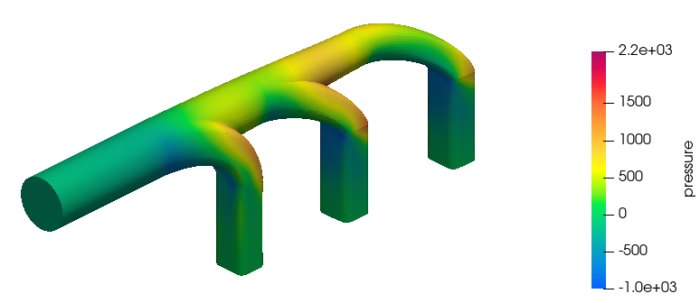

Create Pressure Contours on Boundary Surfaces
Click the Boundary Groups tool.
Figure 52.
Select all surfaces in the model by holding the left mouse button, dragging,
and drawing a rectangle across the manifold.
Figure 53.

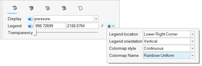

- In the microdialog, set the Display variable to pressure.
Activate the Legend toggle and click
to reset the range.
Click
and set the Colormap Name to Rainbow
Uniform.
Figure 54.
Click
on the guide bar.
The pressure legend is in Pa.
Figure 55.
- In the Post Browser, right-click on Boundary Group 4 and select Rename. Name it Pressure_plot.

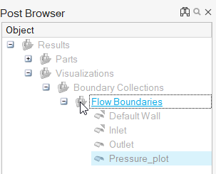

In the Post Browser, turn off the display of the boundary
surfaces by clicking on the icon next to Flow Boundaries.

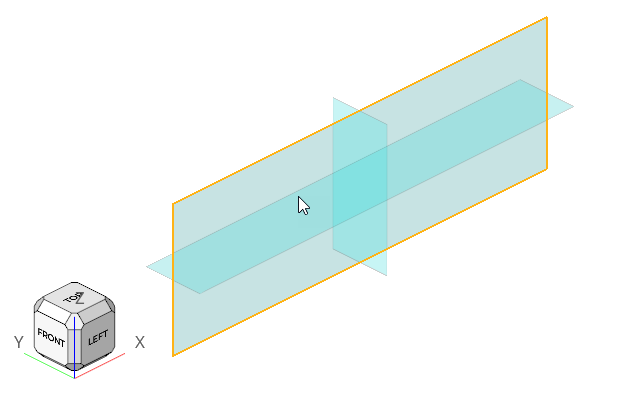

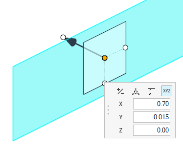

Click the Slice Planes tool.
Figure 57.
Select the x-z plane in the modeling window.
Figure 58.
In the microdialog, click
to adjust the plane with the Vector tool.
In the Vector tool dialog, click
to
define the coordinates of the center of plane. Set the value of Y to
-0.015 and press Enter.
Figure 59.
- Press Esc twice.
In the slice plane microdialog, click
to
create the slice plane.

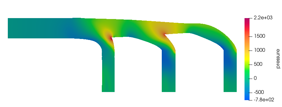

- In the display properties microdialog, set the Display variable to pressure.
to reset the range.
Click
Uniform.
Figure 60.
Click
on the guide bar.
Figure 61.

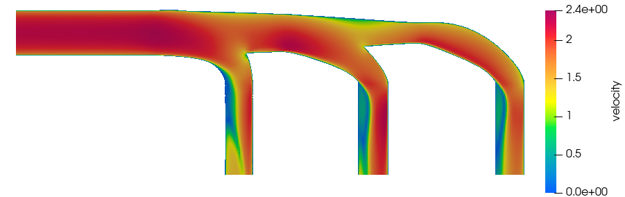

- In the Post Browser, right-click on Slice Plane 1 and select Edit.
In the microdialog, change the Display variable to
velocity (m/s) then click
on the
guide bar.
Figure 62.
