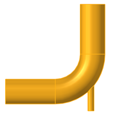

The problem characteristics shown here determine if the flow is laminar or turbulent by calculating the Reynolds number in the pipe. The diameter of the large inlet is 0.1 m, and the inlet velocity (v) is 0.4 m/s. The diameter of the small inlet is 0.025 m, and the inlet velocity is 1.2 m/s.
Figure 1. Schematic of Mixing Elbow
The fluid in this problem is water with the following properties that do not change with temperature: a density (ρ) of 1000 kg/m3 and a molecular viscosity (μ) of 1 X 10-3 kg/m-sec.

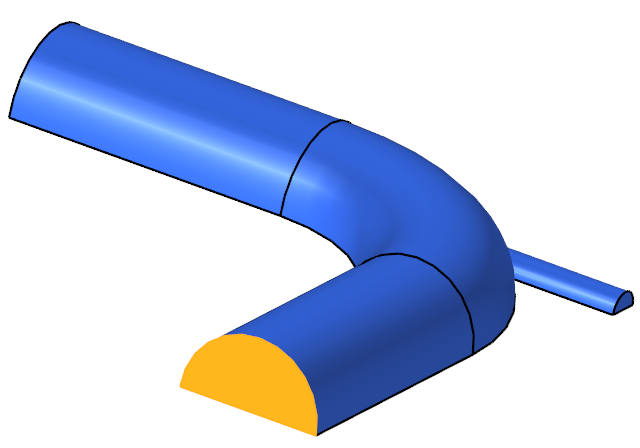

The large inlet of the mixing elbow will be defined as a profiled inlet based on average velocity.
  1. From the Flow ribbon, Profiled tool group, click the Profiled Inlet tool.
    Figure 10.

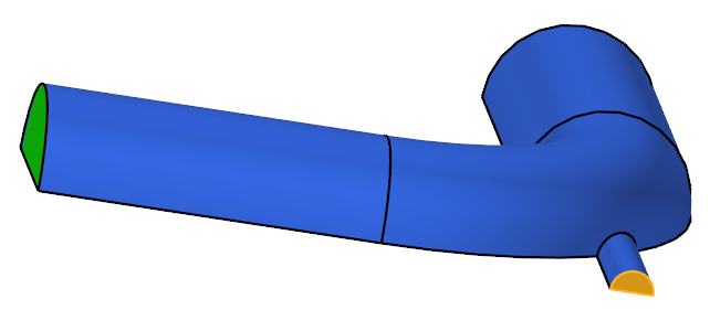

  2. Click the face of the large inlet.
    Figure 11.

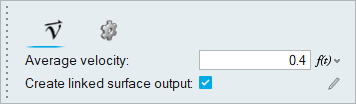

  3. In the microdialog, enter a value of 0.4 m/s for Average velocity.
    Figure 12.

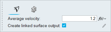

  2. In the microdialog, enter a value of 1.2 m/s for Average velocity.
    Figure 14.

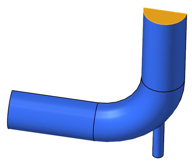

Set Boundary Conditions for the Symmetry Plane
This geometry is symmetric about the XY midplane, and can therefore be modeled with half of the geometry. In order to take advantage of this, the midplane needs to be identified as a symmetry plane. The symmetry boundary condition enforces constraints such that the flow field from one side of the plane is a mirror image of that on the other side.
  1. From the Flow ribbon, click the Symmetry tool.
    Figure 18.

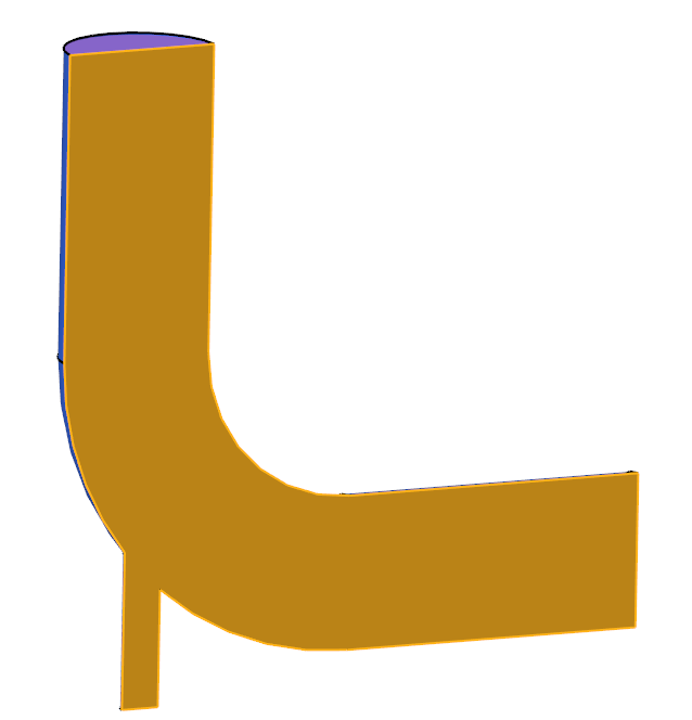

  2. Select the face of the symmetry plane.
    Figure 19.
  3. In the microdialog, accept the default symmetry conditions.
    Figure 20.
  4. On the guide bar, click to execute the command and exit the tool.

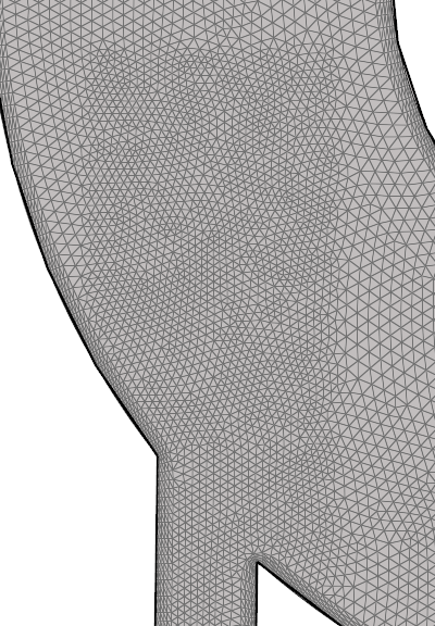

    Tip: Right-click on the mesh job and select View log file to view a summary of the meshing process.
  5. From the back side of the model, observe the refined mesh around the small inlet.

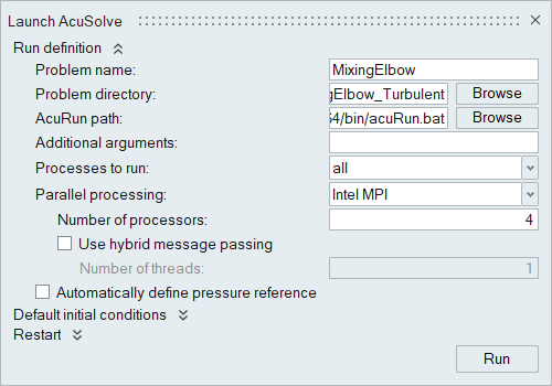

Run AcuSolve
  1. From the Solution ribbon, click the Run tool.
    Figure 24.
    The Launch AcuSolve dialog opens.
  2. Set the Parallel processing option to Intel MPI.
  3. Optional: Set the number of processors to 4 or 8 based on availability.
  4. Deactivate the Automatically define pressure reference option.
  5. Leave the remaining options as default and click Run to launch AcuSolve.
    Figure 25.
    The Run Status dialog opens. Once the run is complete, the status is updated and you can close the dialog.

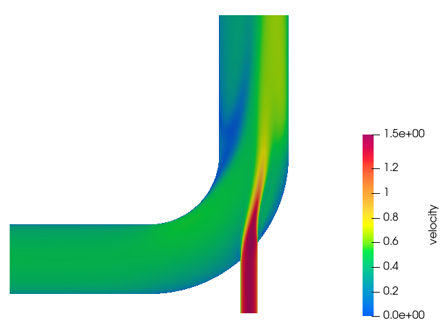

  6. In the display properties microdialog, set the display to velocity and activate the Legend toggle.
  7. Click and set the Colormap Name to Rainbow Uniform.
    Figure 26.
  8. Click on the guide bar to show the velocity magnitude (m/s) contour.
    Figure 27.

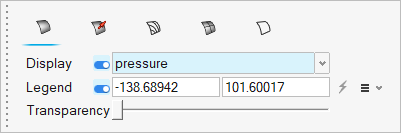

  9. Again, right-click on the Symmetry and select Edit.

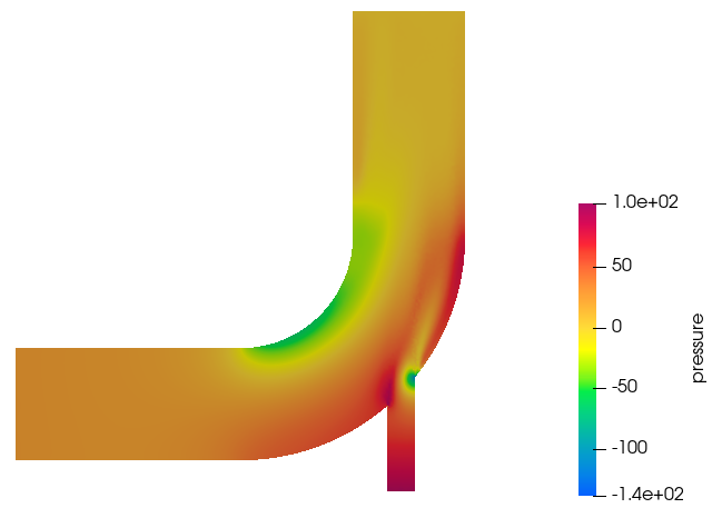

  10. Display the pressure (Pa).
  11. Click to reset the range.
    Figure 28.
  12. Click on the guide bar to show the pressure (Pa) contours.
    Figure 29.
