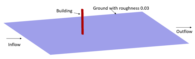

The problem to be addressed in this tutorial is shown schematically in Figure 1. As an example, this problem shows the capability of Atmospheric Boundary Layer modelling in AcuSolve.
In this tutorial, you will simulate the air flow over a building with a ground roughness of 0.03 m. In this case, User Defined Atmospheric Roughness Type is considered.

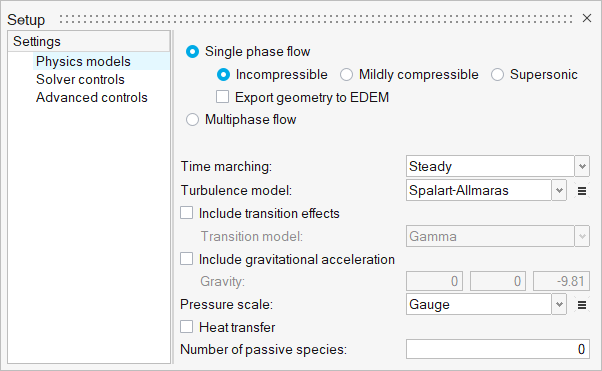

The Setup dialog opens. -
Under the Physics models setting:
Figure 5.

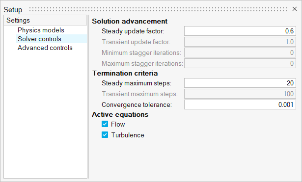

- Click the Solver controls setting.
Set the Steady update factor to 0.6 and the Steady
maximum steps to 20.
Figure 6.

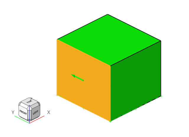

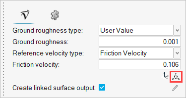

Click the inlet face highlighted in the figure below.
Figure 9.
- In the microdialog, select User Value for the Ground roughness type.
Set the Friction Velocity to 0.106 m/s.
The atmospheric boundary layer inflow should have a roughness of 0.001 m if the standard turbulence wall function has a roughness of 0.03 m on the ground because the relationship between inflow roughness and standard wall roughness has an empirical ratio of 30.

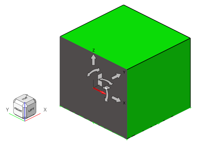

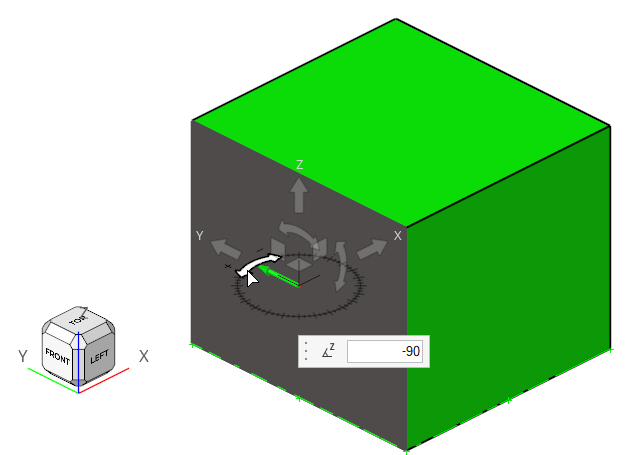

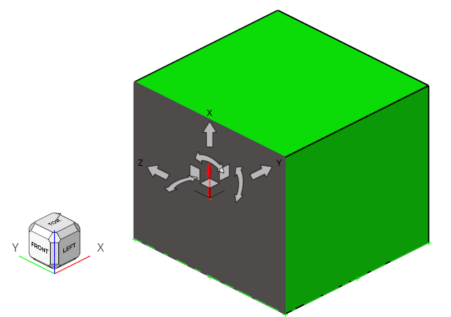

Click the Move tool icon
Figure 10.
Select the z rotation arrow, set it to
-90 degrees, then press Enter.
Figure 11.
Verify the atmospheric flow direction (y) is aligned to the global coordinate
X.

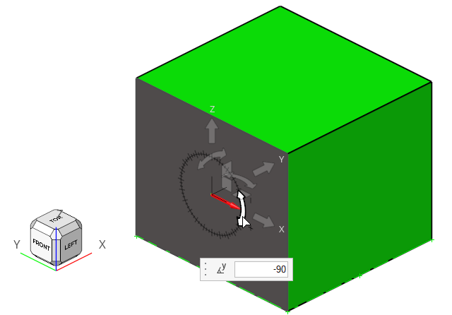

Figure 12.
Select the y rotation arrow, set it to
Figure 13.
Verify the ground normal direction (x) align to the global coordinate Z.

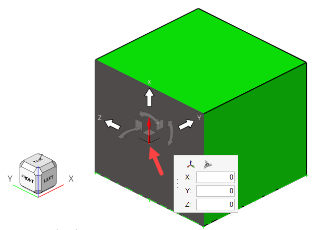

Click the origin of the coordinate (marked by the arrow), set the atmospheric
ground origin to (0, 0, 0), and press Enter.
Figure 15.

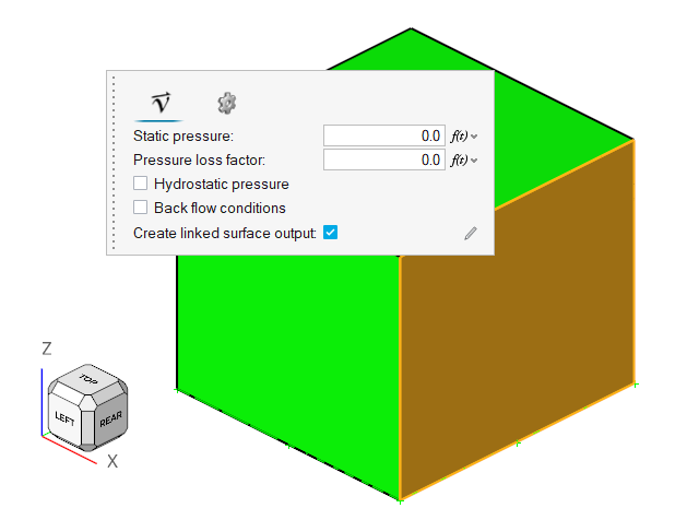

Click the Outlet tool.
Figure 16.
Select the face highlighted in the figure below, verify that both the static
pressure (Pa) and the pressure loss factor are 0 in the
microdialog, then click
on the
guide bar.
Figure 17.

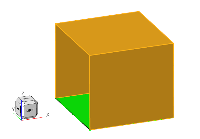

Click the Slip tool.
Figure 18.
- Hide the Atmospheric boundary and the Outlet using the Boundaries legend.
Select the top surface and the two sides as shown in the figure below then
click
on the guide bar.
Figure 19.

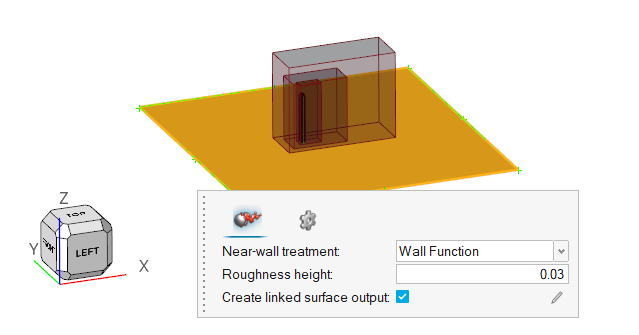

Click the No Slip tool.
Figure 20.
- Hide the Slip surfaces using the Boundaries legend.
- Select the bottom surface as shown in the figure below.
Set the Roughness height to 0.03 m.
Figure 21.
On the guide bar, click
to execute

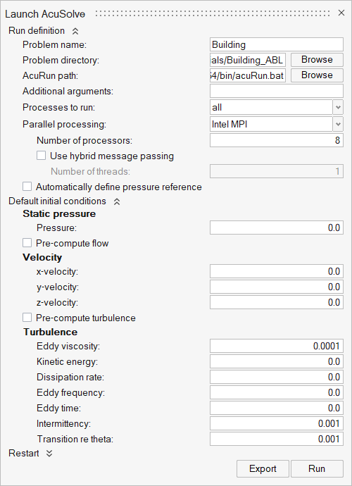

Run AcuSolve
Figure 22.
- Set the Parallel processing option to Intel MPI.
- Uncheck the Automatically define pressure reference option.
- Expand Default initial conditions and uncheck the Pre-compute flow and Pre-compute turbulence options.
- Set all the velocity components to 0 m/s and the eddy viscosity to 0.0001 m2/s.
Leave the remaining options as default and click
Run to launch AcuSolve.

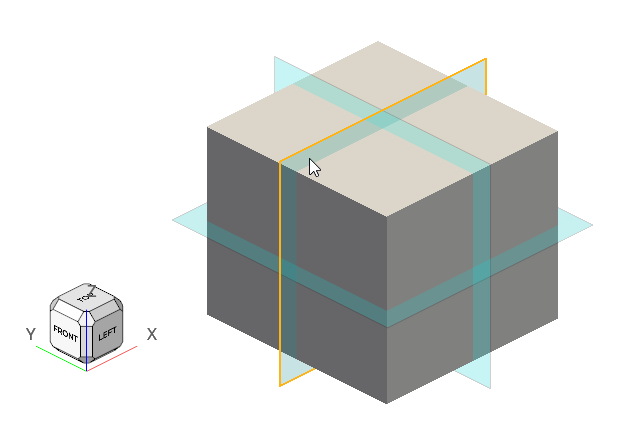

Click the Slice Planes tool.
Figure 24.
Select the slice plane shown below.
Figure 25.
In the slice plane microdialog, click
to
create the slice plane.

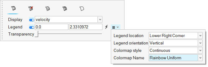

- In the display properties microdialog, set the display to velocity and activate the Legend toggle.
Click
and set the Colormap name to Rainbow
Uniform.

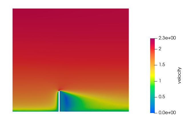

Figure 26.
- Isolate Slice Plane 1.
- Click the Left face on the View Cube to orient the slice plane.
Click
on the guide bar to show the velocity (m/s)
contours.
Figure 27.
