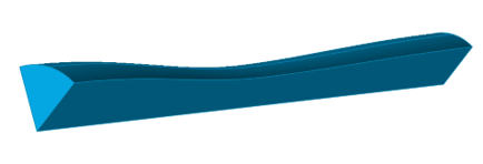

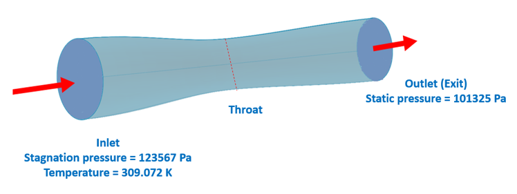

Problem Description
The exit to throat area ratio of the nozzle is 1.5. The radius at the inlet is 0.892 m, while the radius at the outlet is 0.691 m. The inlet stagnation pressure and the inlet temperature are 123,567 Pa and 309.072 K, respectively. The static pressure at the outlet is set to 101,325 Pa. The fluid in this problem is air, where the flow is assumed inviscid (viscosity and conductivity are zero) and density is based on the ideal gas model.

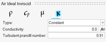

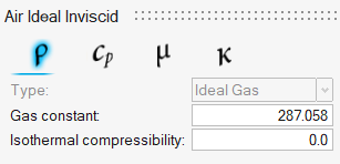

- Keep the default values for the Gas constant and the Specific heat and set the Viscosity and Conductivity values to 0.
Rename the model to Air Ideal Inviscid.

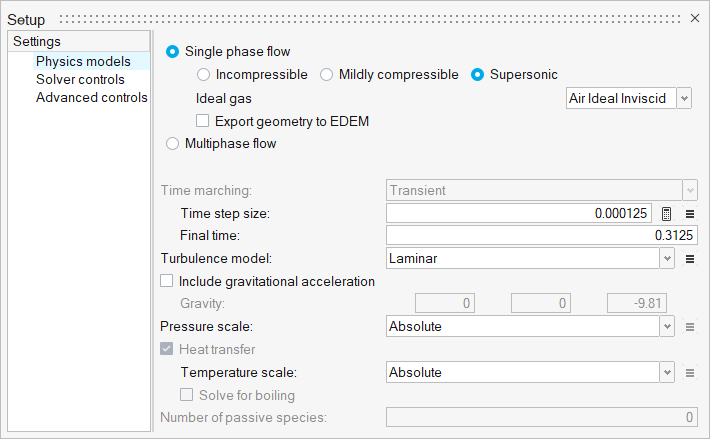

Under the Physics models setting:
- Select the Supersonic radio button under Single phase flow.
- Set the Ideal gas model to Air Ideal Inviscid.
- Set the Time step size to 0.000125.
- Set the Final time to 0.3125.
- Verify that the Turbulence model is set to Laminar.

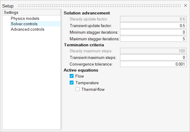

- Click the Solver controls setting.
Set the Transient update factor to 0.5.
Note: Since we are interested in a solution that reaches a steady state, the transient update factor can be set to a non-zero value without affecting the solution accuracy.
Set the Maximum stagger iterations to 5.
Figure 9.

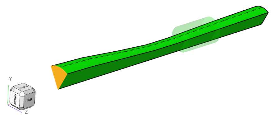

Click on the inlet face highlighted in the figure below.
Figure 12.

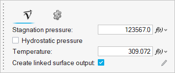

In the microdialog, enter the following values for the
stagnation pressure and temperature.
Figure 13.

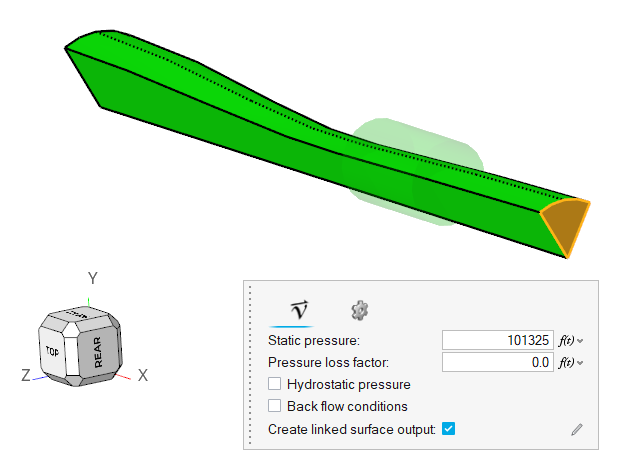

Click the Outlet tool.
Figure 14.
Select the face highlighted in the figure below, enter the
101325 as the static pressure value, and then click
on the guide bar.

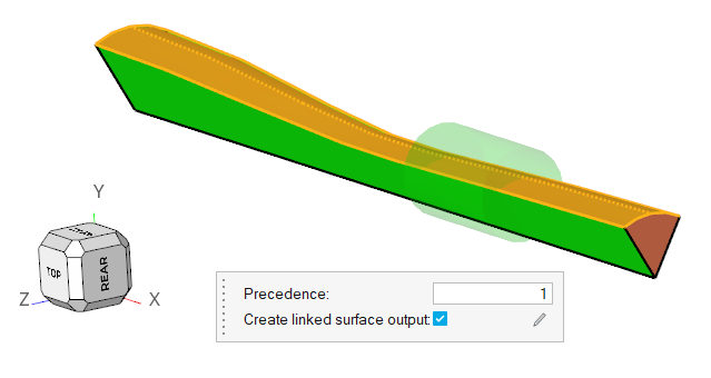

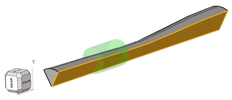

Click the Slip tool.
Figure 16.
Select the face highlighted in the figure below and then click
on the
guide bar.

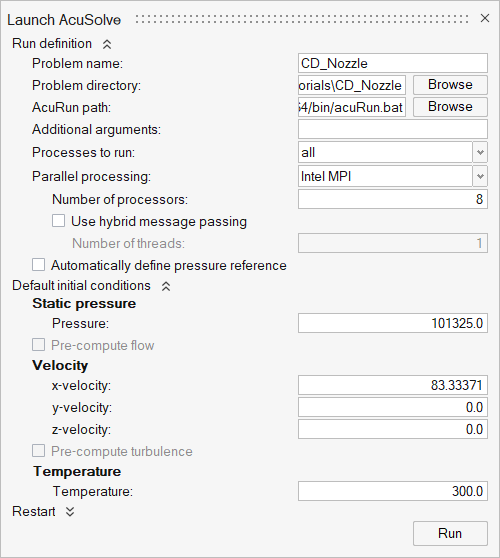

Run AcuSolve
Figure 23.
- Set the Parallel processing option to Intel MPI.
- Expand Default initial conditions and enter the values as shown below.
Leave the remaining options as default and click
Run to launch AcuSolve.

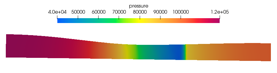

In this step, you will check the contours of pressure on a mid slice plane.
- Once the solution is completed, navigate to the Post ribbon.
- From the menu bar, click .
Select the AcuSolve log file in your problem
directory to load the results for post-processing.
The solid and all the surfaces are loaded in the Post Browser.
Figure 25.
Move the animation slider to the end to load the last time step data.
Figure 26.
Click the Slice Planes tool.
Figure 27.
- Select the x-y plane in the modeling window.
In the slice plane microdialog, click
to
create the slice plane.

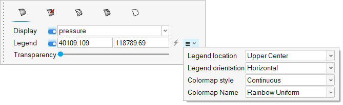

- In the display properties microdialog, set the display to pressure and activate the Legend toggle.
Click
and set the Legend location to Upper
Center, the Legend Orientation to
Horizontal, and the Colormap name to
Rainbow Uniform.
Figure 28.
Click
on the guide bar.

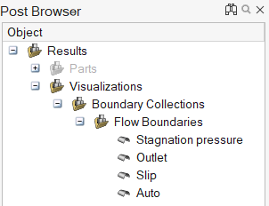

In the Post Browser, hide the Flow
Boundaries surfaces to display the pressure contours on the
slice plane.

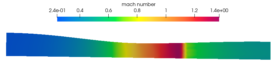

Figure 29.
Similarly, you can display the Mach number contour.Figure 30.
