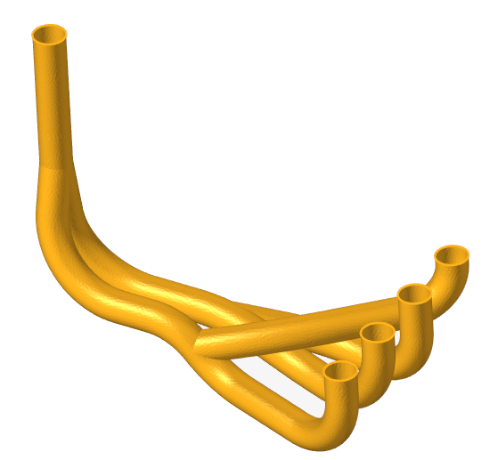

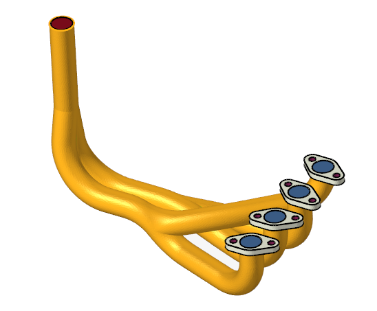

The problem to be addressed in this tutorial is shown schematically in Figure 1. It consists of an exhaust manifold with four inlets and one outlet. The inlets have flanges with holes for steel bolts to attach the manifold. The body of the manifold is made up of stainless steel.
Figure 1. Schematic of Exhaust Manifold
The diameter of the inlets is 0.036 m; the inlet velocity (v) is 8.0 m/s; and the temperature (T) of the fluid entering the inlets is 700 K. The diameter of the outlet is 0.036 m. The pipe wall has a thickness of 0.003 m and the flanges have a thickness of 0.01 m.
The combustion mixture enters the inlets and heat is transferred through conduction inside the manifold. The heat transfer causes deformations and stress in the manifold body which can be simulated using OptiStruct.

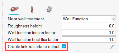

The nodal surface output needs to be activated for all the surfaces in order to create the OptiStruct input deck from the acuOptiStruct command.

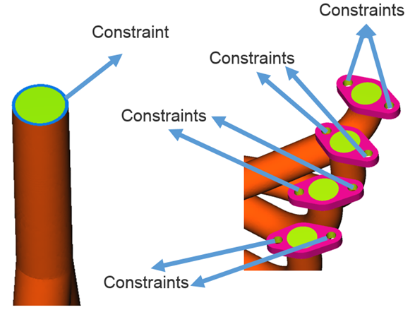

For this simulation, the constrained surfaces are the flange bolts and Outlet end of the manifold. These surfaces will be constrained in all six degrees of freedom (Translation and Rotation). The default value of zero is used.
The stress analysis type is selected as steady linear where the deformations are in the elastic range; that is, the stresses, σ, are assumed to be linear functions of the strains, ε, Hooke's law can be used to calculate the stresses.

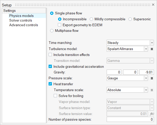

Set Up Flow
  1. From the Flow ribbon, click the Physics tool.
    Figure 5.
    The Setup dialog opens.
  2. Under the Physics models setting:
    1. Set Time marching to Steady.
    2. Select Spalart-Allmaras as the Turbulence model.
    3. Activate the Include gravitational acceleration and Heat transfer options.
    Figure 6.

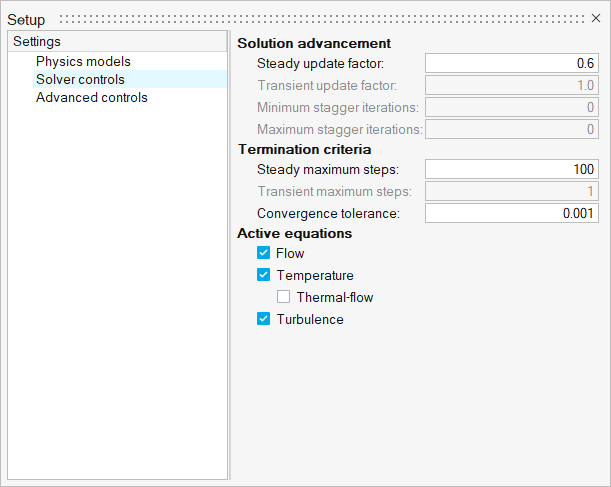

  3. Click the Solver controls setting.
  4. Verify the following parameters.
    Figure 7.

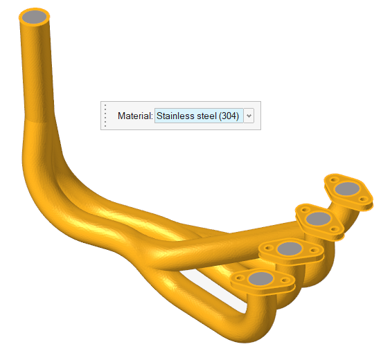

  2. Select the exhaust volume.
  3. In the microdialog, select Stainless steel (304) from the drop-down.
    Figure 9.
  4. On the guide bar, click to execute the command and remain in the tool.

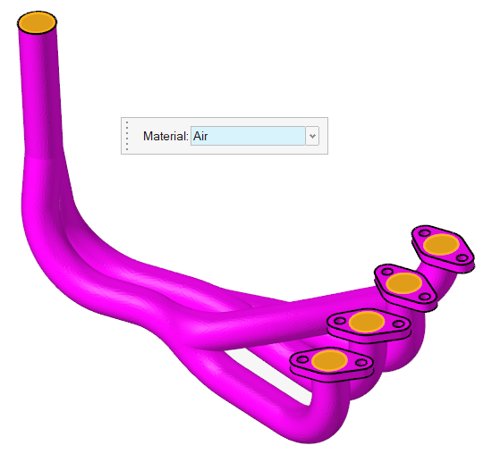

  5. Select the air volume.
  6. In the microdialog, select Air from the drop-down.
    Figure 10.
  7. On the guide bar, click to execute the command and exit the tool.

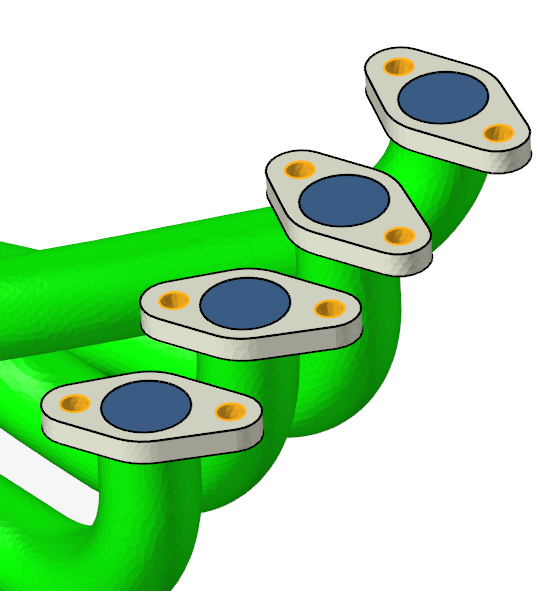

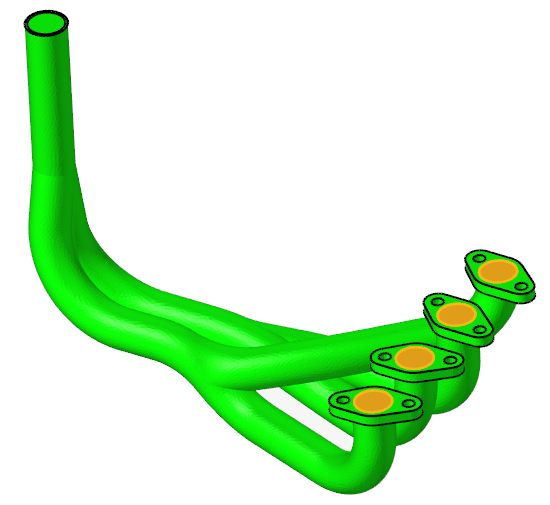

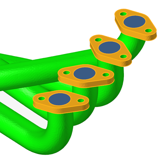

  2. Select the manifold inlets highlighted in the figure below.
    Figure 12.

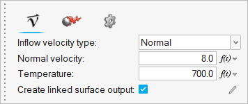

  3. In the microdialog, set the Inflow velocity type to Normal, the Normal velocity to 8.0 and the Temperature to 700.
    Figure 13.

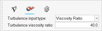

  4. Click the Turbulence tab in the microdialog. Set the input type to Viscosity Ratio and the viscosity ratio value to 40.
    Figure 14.

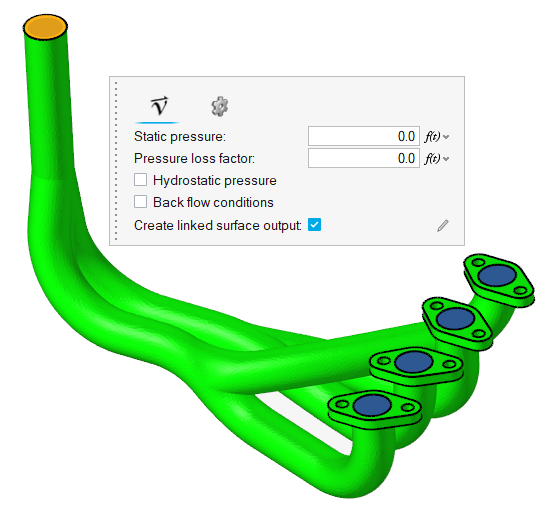

  7. Select the face highlighted in the figure below and verify that both the static pressure and the pressure loss factor are set to 0.
    Figure 16.

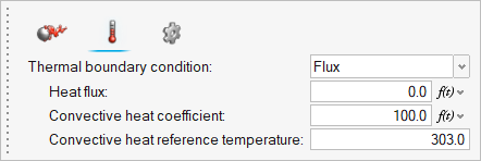

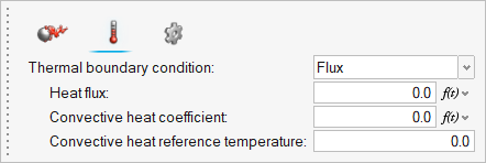

  11. In the microdialog, click the Temperature tab, set the Convective heat coefficient to 100, and the Convective heat reference temperature to 303.
    Figure 19.

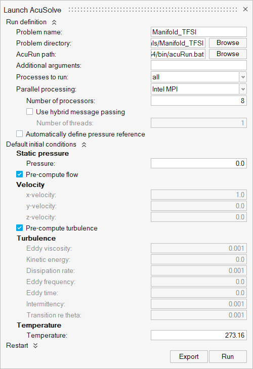

  1. From the Solution ribbon, click the Run tool.
    Figure 27.
  2. Set the Parallel processing option to Intel MPI.
  3. Optional: Set the number of processors to 4 or 8 based on availability.
  4. Deactivate the Automatically define pressure reference option.
  5. Expand Default initial conditions and check that the Pre-compute flow and Pre-compute turbulence options are activated.
  6. Set the Temperature to 273.16.
  7. Leave the remaining options as default and click Run to launch AcuSolve.

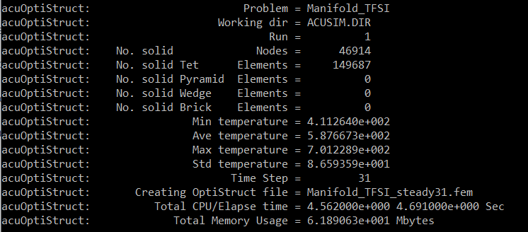

  2. Execute the following command:
    acuOptiStruct -solids “Exhaust Steel” -spcsurfs “Flange_Bolts – Output”,”Outlet_End – Output” -spcsurfsdof 123456,123456 -spcsurfsdofvals 0,0 -type sl
    You should see a similar output as below when the command executes successfully.

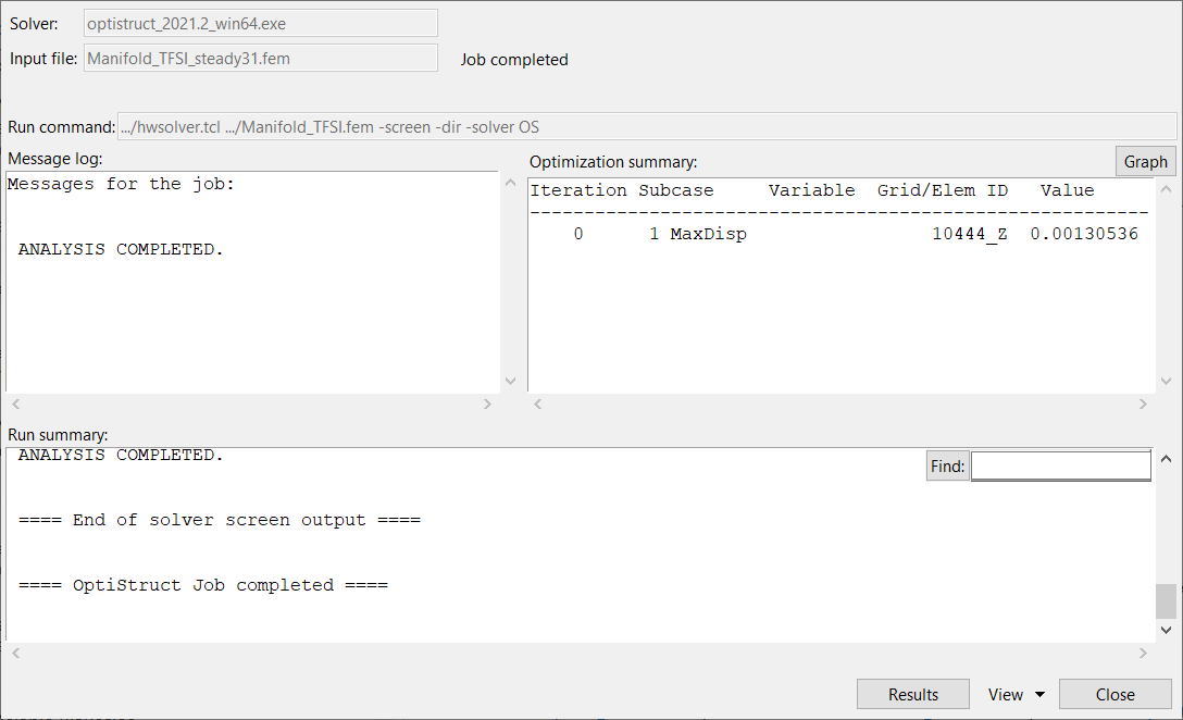

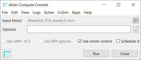

  1. Start OptiStruct from the Windows Start menu by clicking Start > Altair <version> > Compute Console.
  2. Click next to Input file(s).
  3. Browse to the location that you are using as your working directory.
  4. Select the .fem file.
    Figure 30.
  5. Click Run to run the case.

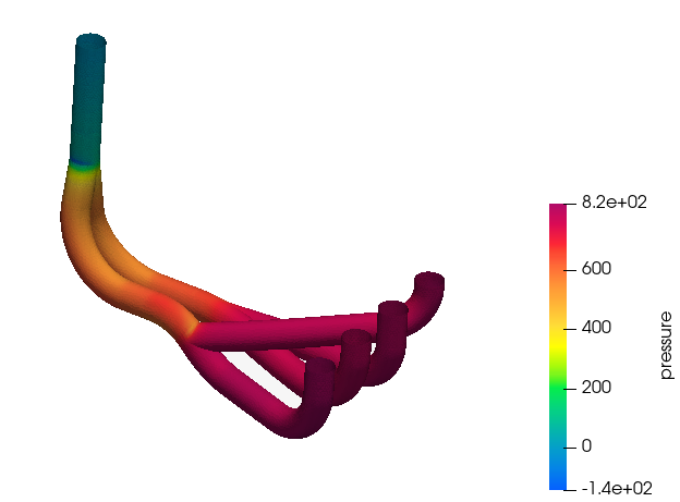

Post-Process the Results with HM-CFD Post
  1. Once the solution is completed, navigate to the Post ribbon.
  2. From the menu bar, click File > Open > Results.
  3. Select the AcuSolve log file in your problem directory to load the results for post-processing.
    The solid and all the surfaces are loaded in the Post Browser.

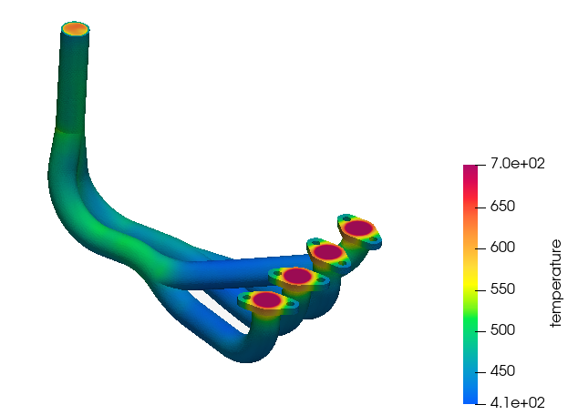

  4. Click the Boundary Groups tool.
    Figure 32.
  5. Select all the surfaces.
  6. In the microdialog, set the display to temperature and activate the Legend toggle.
  7. Click and set the Colormap name to Rainbow Uniform.
    Figure 33.
  8. Click on the guide bar.
    Figure 34.

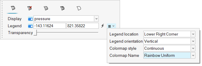

  9. In the Post Browser right-click on Fluid_Walls and select Edit.
  10. In the microdialog, change the display to pressure and activate the Legend toggle.
  11. Click and set the Colormap name to Rainbow Uniform.
    Figure 35.
  12. Hide all other flow boundaries.
    Figure 36.

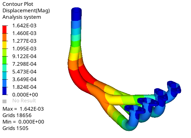

    Observe that this model contains only the solid domain since only the solid is included while generating the OptiStruct solver deck.
  6. Click on the Results toolbar to open the Contour panel.
  7. In the panel area, set the Result type to Displacement (v).
  8. Click Apply to plot the displacement magnitude contours.
    Figure 37.

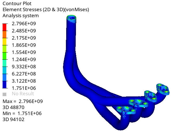

  9. Change the Result type to Element Stresses (2D & 3D) (t) and select vonMises from the drop-down below.
  10. Click Apply.
