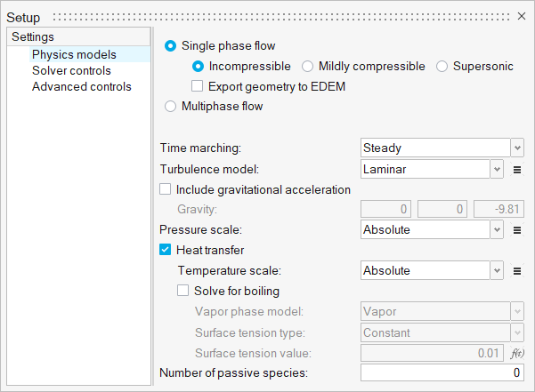

The Setup dialog opens. -
Under the Physics models setting:
- Set Time marching to Steady.
- Set the Turbulence model to Laminar.
- Activate the Heat transfer checkbox.

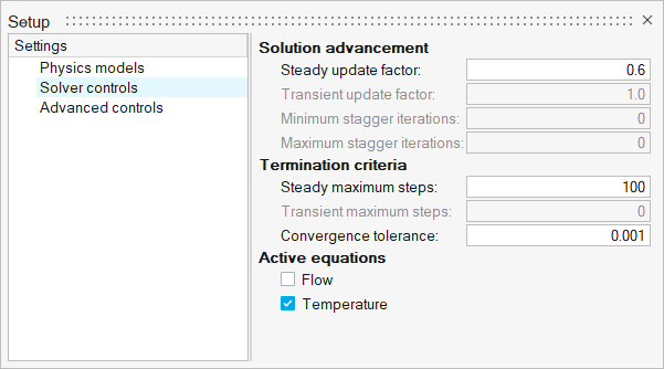

- Click the Solver controls setting.
Deactivate the Flow checkbox.
In this tutorial, you will only be solving for the temperature field.

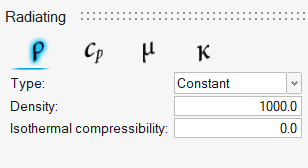

- In the new dialog, rename the material to Radiating by clicking the name in the top-left corner.

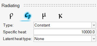

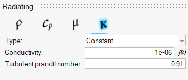

Enter the following values for each of the material property tabs then close
the dialog.
- Density – 1000 kg/m3
- Specific Heat – 10000 J/kg-K
- Viscosity – 1e-5 kg/m-sec
- Conductivity – 1e-6 W/m-K

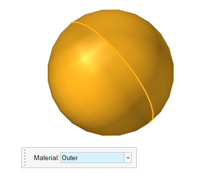

Select the outer solid and assign the Outer material
model from the microdialog.

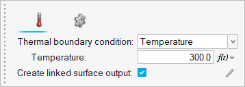

In the microdialog, assign a
Temperature boundary condition at
300 K.

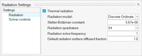

Activate the Thermal radiation checkbox and set the
Radiation model to Discrete Ordinate.
Figure 14.
- Set the Radiation quadrature to S4.
- Verify that the Default radiation surface diffused fraction is set to 1.

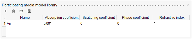

From the Participating Media tools, click the
Model tool.
Figure 17.
The Participating media model library opens. -
Click
and create a model with the following properties.
Figure 18.

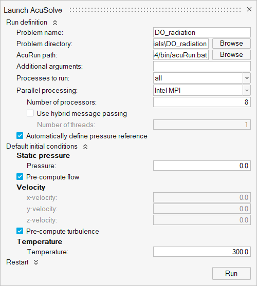

- Set the Parallel processing option to Intel MPI.
- Expand Default initial condition and set the Temperature to 300 K.
Leave the remaining options as default and click
Run to launch AcuSolve.

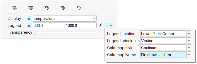

- In the display properties microdialog, set the display to Temperature and activate the Legend toggle.
Click
and set the Colormap Name to Rainbow
Uniform.

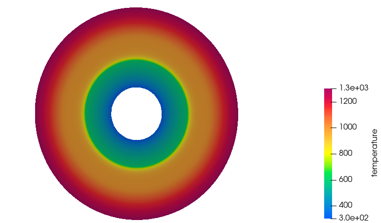

Figure 27.
Click
on the guide bar then press F
to fit the section cut to the screen.
Figure 28.
