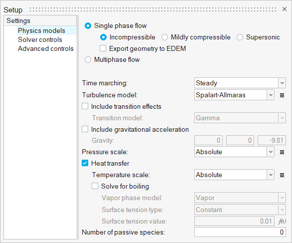

Under the Physics models setting:
- Verify that Time marching is set to Steady.
- Select Spalart-Allmaras as the Turbulence model.
- Activate the Heat transfer checkbox.
Figure 5.

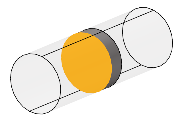

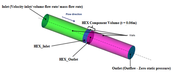

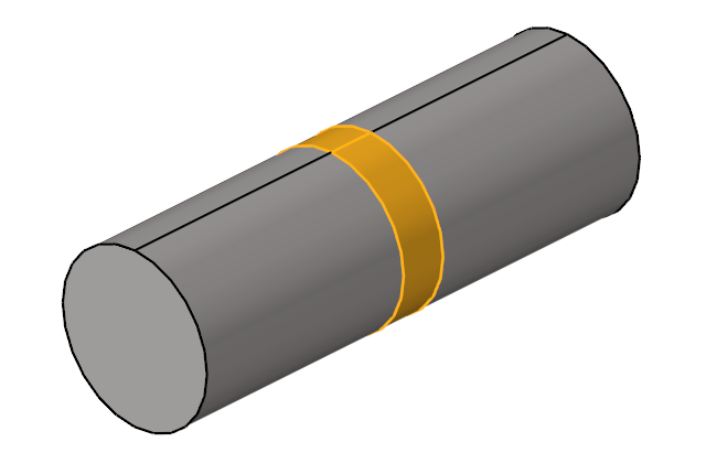

Select the middle solid as the heat exchanger component volume.
Figure 8.

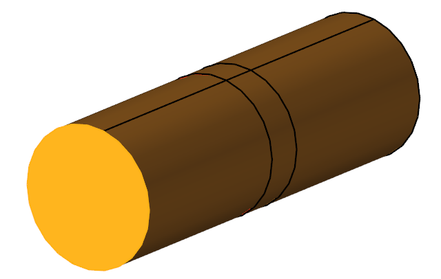

On the guide bar, click Inlet
then select the face shown below as the inlet of the heat exchanger
component.
Figure 9.

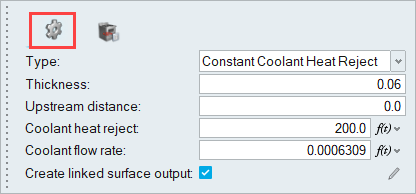

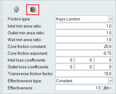

In the microdialog, enter the following
parameters:
Figure 10.
Figure 11.
to execute

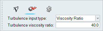

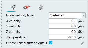

In the microdialog, enter the following values for the
Momentum and Turbulence tabs.
Figure 14.
Figure 15.

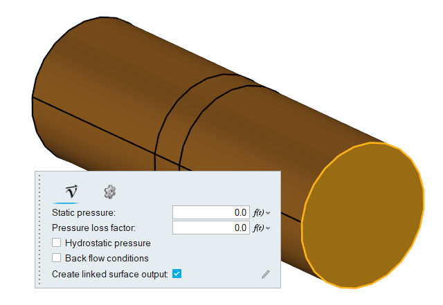

Click the Outlet tool.
Figure 16.
Select the face highlighted in the figure below and then click
on the
guide bar.
Figure 17.

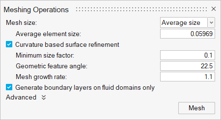

In the Meshing Operations dialog, set the Mesh growth rate
to 1.1 (if not set already).
Figure 19.
Click Mesh.
The Run Status dialog opens. Once the run is complete, the status is updated and you can close the dialog.Tip: Right-click on the mesh job and select View log file to view a summary of the meshing process.

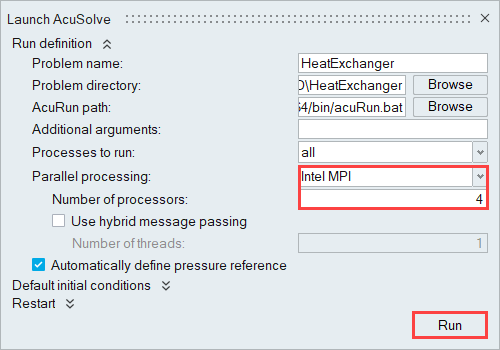

The Launch AcuSolve dialog opens. - Set the Parallel processing option to Intel MPI.
Leave the remaining options as default and click
Run to launch AcuSolve.

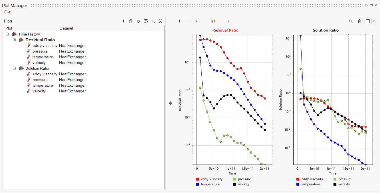

Post-Process with the Plot Tool

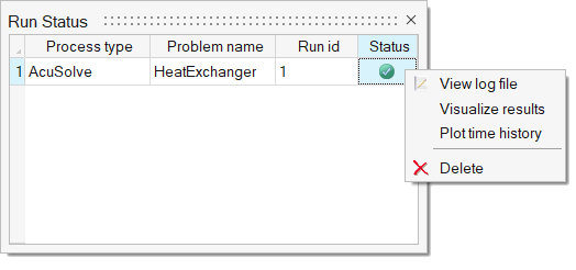

In the Run Status dialog, right-click on the AcuSolve run.
Figure 22.
Select Plot time history to plot the residual and
solution ratios.
Figure 23.

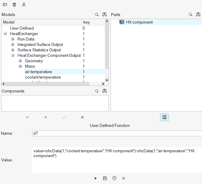

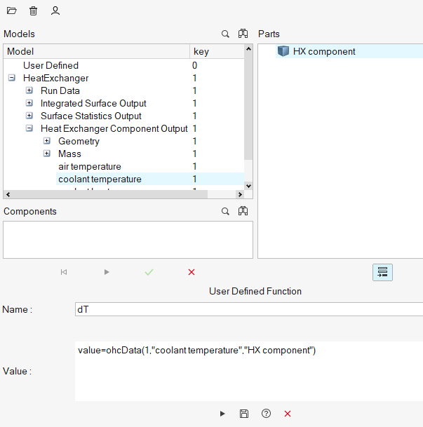

- Right-click User Defined under the Model panel to create a user defined function.
- In the Data Tree, expand Heat Exchanger Component Output then select coolant temperature.
- In the Name field, enter dT.
- In the Value field, type value=.
Under Parts, choose HX component then click
to insert the field as part of the value, as shown
below.
Figure 24.

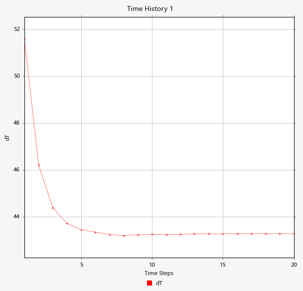

- Type - at the end of the user defined function value.
In the Data Tree, select air temperature, then pick
HX component and click
to insert the field as part of the value.
Click
to add the user defined function.
Figure 25.
Click the x axis to switch to Time Steps.
Figure 26.
As shown in the plot above, the temperature rise is 43.3K.
