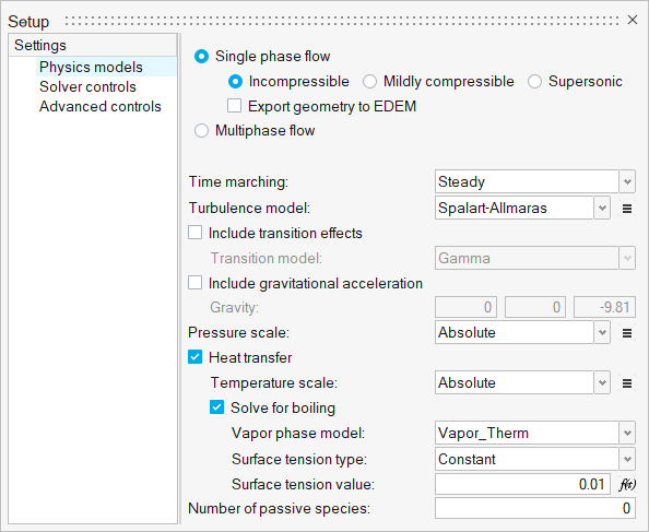

The Setup dialog opens. -
Under the Physics models setting:
- Verify that Time marching is set to Steady.
- Select Spalart-Allmaras as the Turbulence model.
- Activate the Heat transfer checkbox.
- Click the Solve for boiling checkbox to activate Nucleate Boiling.
- Select Vapor_Therm for the Vapor phase model.
- Check that the Surface tension type is set to Constant and set the Surface tension value to 0.01.

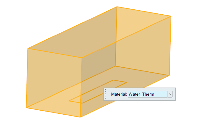

Assign Material Properties
Figure 6.
- Select the model solid.
Select Water_Therm from the Material drop-down
menu.

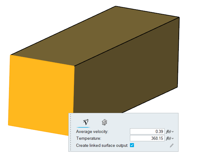

- Click on the inlet face, highlighted in the figure below.
In the microdialog, enter 0.39
for the Average velocity and 368.15 for the
Temperature.
Figure 9.

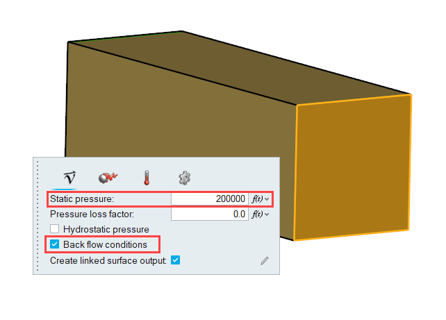

Click the Outlet tool.
Figure 10.
Select the face highlighted in the figure below, set the Static pressure to
200000, and activate the Back flow
conditions.

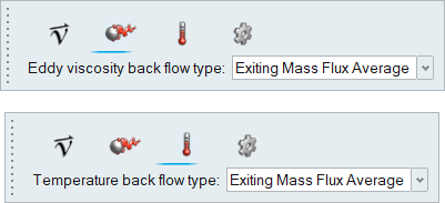

Figure 11.
In the Turbulence and Temperature tabs, set the back flow type to
Exiting Mass Flux Average
Figure 12.

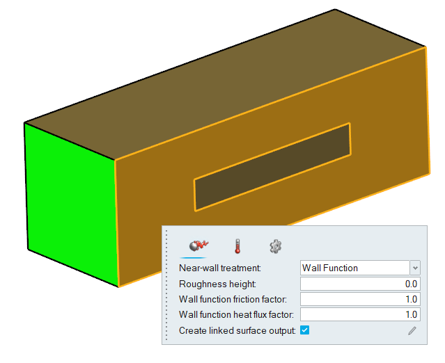

Click the No Slip tool.
Figure 13.
Select the face highlighted in the figure below then click
on the guide bar.
Figure 14.

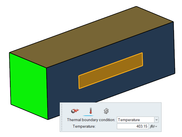

- Select the next face highlighted in the figure below.
In the microdialog, click the
Temperature tab, set the Thermal boundary condition
to Temperature and set the temperature value to
403.15.
Figure 15.

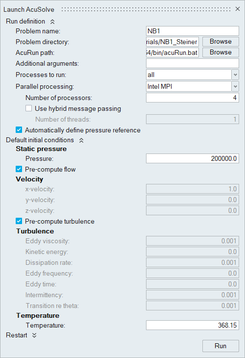

Run AcuSolve
Figure 19.
The Launch AcuSolve dialog opens. - Set the Parallel processing option to Intel MPI.
Expand Default initial conditions and enter the values
as shown below to define the initial conditions.
Figure 20.
Click Run to launch AcuSolve.

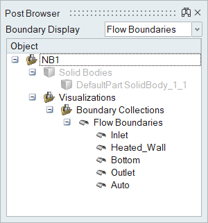

The solid and all the surfaces are loaded in the Post Browser.
Figure 22.
- To check the temperature contours on the Heated_Wall and Bottom surfaces, right-click on those surfaces in the Post Browser and select Isolate.

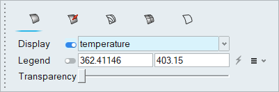

A surface coloring microdialog opens.
Set the Display option to Temperature.
Figure 23.

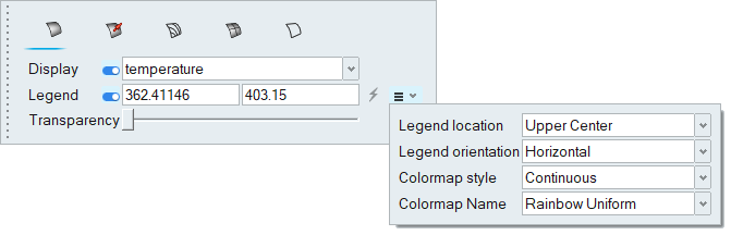

Activate the Legend radio button then click
and set the legend properties as
shown below.
Figure 24.

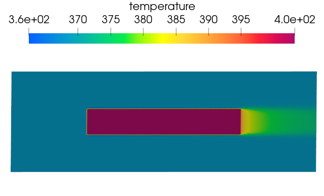

The temperature contours are displayed on the model.Figure 25.
