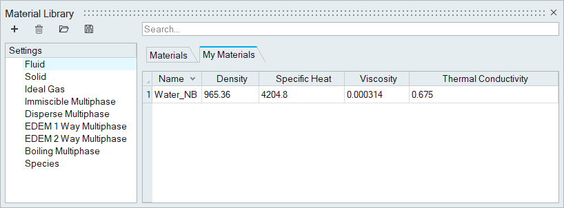

From the Flow ribbon, click the Material Library tool.
Figure 4.
The Material Library dialog opens. - Under Settings, click Fluid, then click the My Materials tab.
Verify that the material Water_NB has the properties shown below.
Figure 5.

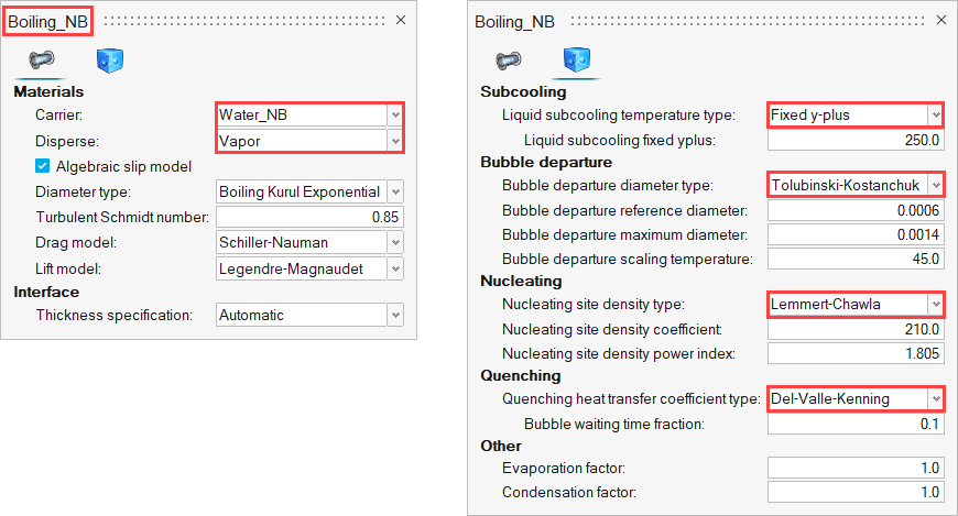

- Under Settings, click Boiling Multiphase, then click the My Materials tab.
Click
to create a new material.
Name the material Boiling_NB and verify the following
properties in the microdialog.
Figure 6.

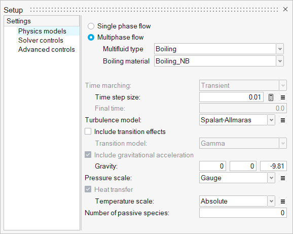

The Setup dialog opens. -
Under the Physics models setting:
- Activate the Multiphase flow radio button.
- Set the Multifluid type to Boiling and the Boiling material to Boiling_NB.
- Ensure that the Time step size is 0.01.
- Select Spalart-Allmaras as the Turbulence model.
- Set the Gravity value to -9.81 in the z direction.
Set the Pressure scale to Gauge then click
besides the drop-down and set the Absolute
pressure offset to 200000.
Figure 8.

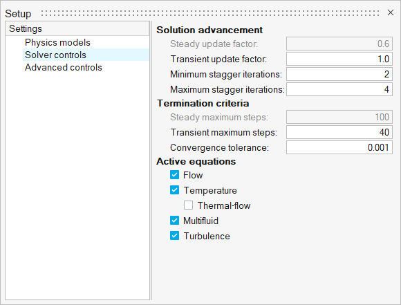

Click the Solver controls setting and verify that:
- Minimum stagger iteration is set to 2.
- Maximum stagger iteration is set to 4.
- Transient maximum step is set to 40.
- The Flow, Temperature, Multifluid, and Turbulence checkboxes are activated.
Figure 9.

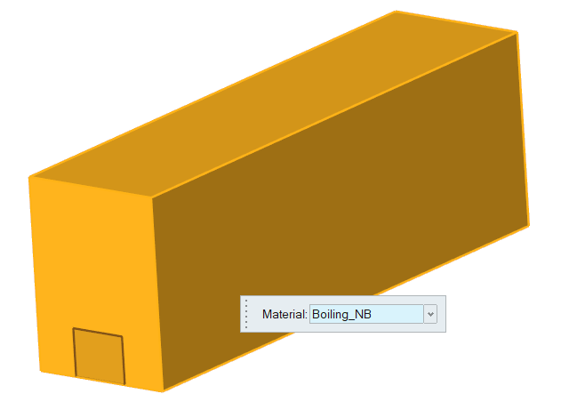

- Select the model solid.
Select Boiling_NB from the Material drop-down
menu.
Figure 11.

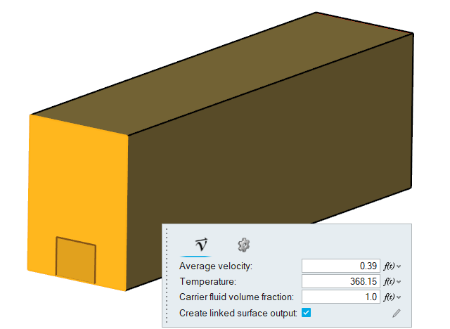

From the Flow ribbon, Profiled
tool group, click the Profiled Inlet tool.
Figure 12.
- Click on the inlet face, highlighted in the figure below.
In the microdialog, enter 0.39
for the Average velocity and 368.15 for the
Temperature.
Figure 13.

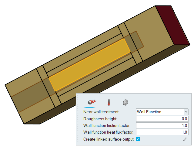

Click the No Slip tool.
Figure 16.
Select the face highlighted in the figure below to create the Heated_wall
face.
Figure 17.

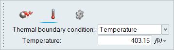

Click the Temperature tab in the microdialog, set the
Thermal Boundary condition to Temperature, and set the
Temperature value to 403.15.
Figure 18.

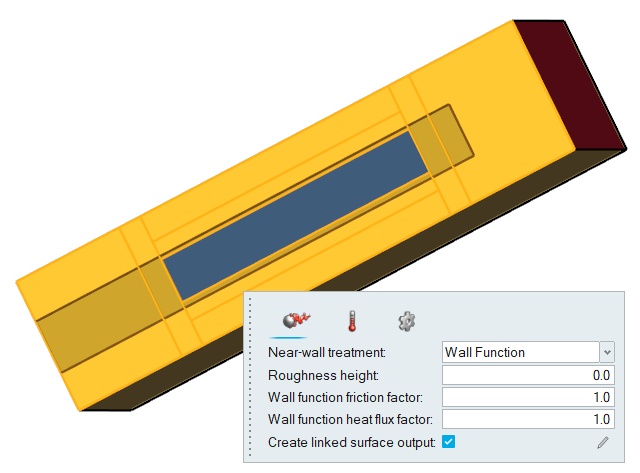

In the Boundaries legend, right-click on Wall, select
Rename, and enter
Heated_wall.
Figure 19.
Select the 8 highlighted surfaces shown in the figure below to create the
Bottom_wall faces then click
on the guide bar.
Figure 20.
- In the Boundaries legend, rename Wall to Bottom_wall.

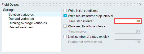

The Field Output dialog opens. -
Set the Time step interval to 10.
Figure 22.

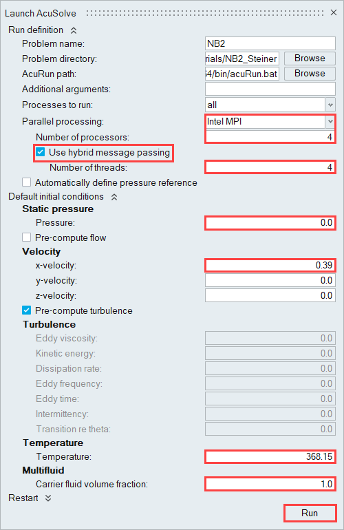

Figure 25.
The Launch AcuSolve dialog opens. - Set the Parallel processing option to Intel MPI.
- Check the box for Use hybrid message passing and set the number of threads to the same as the number of processors.
Expand Default initial conditions and enter the values
as shown below to define the initial conditions.
Figure 26.
Click Run to launch AcuSolve.

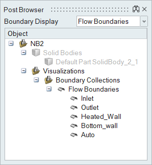

The solid and all the surfaces are loaded in the Post Browser.
Figure 27.
- To check the contours of volume fraction of vapor on the Heated_Wall and Bottom_wall surfaces, right-click on those surfaces in the Post Browser and select Isolate.

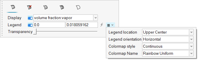

- Select all the surfaces on the model.
- In the microdialog, set the Display option to volume fraction vapor.
Activate the Legend radio button then click
and set the legend properties as
shown below.

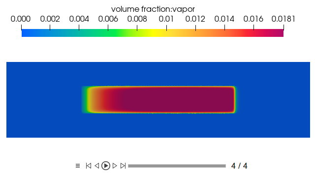

Figure 29.
Click
on the guide bar.
Move the slider at the bottom of the modeling window to
4/4.
The volume fraction of vapor contours are displayed on the model.
Figure 30.
