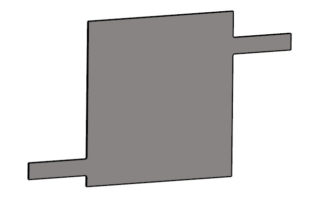

Import and Validate the Geometry
Import the Geometry
- From the menu bar, click .
- In the Import File dialog, browse to your working directory then select ACU-T4001_tank2D.x_t and click Open.
In the Geometry Import Options dialog, leave all the
default options unchanged then click Import.
Figure 3.
Figure 4.

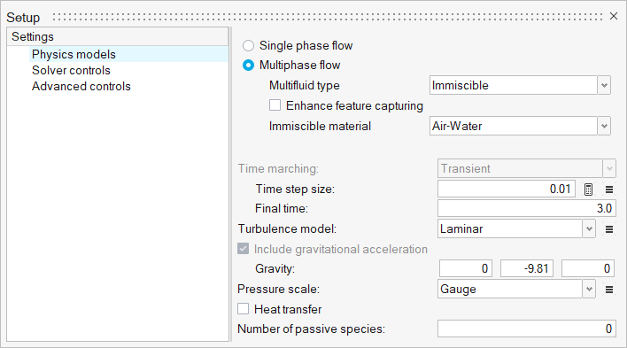

The Setup dialog opens. -
Under the Physics models setting:
- Activate the Multiphase flow radio button.
- Set the Multifluid type to Immiscible and the Immiscible material to Air-Water
- Set the Time step size to 0.01 and the Final time to 3.0
- Select Laminar as the Turbulence model.
- Set the gravity to -9.81 m/sec2 in the y direction.
Figure 8.

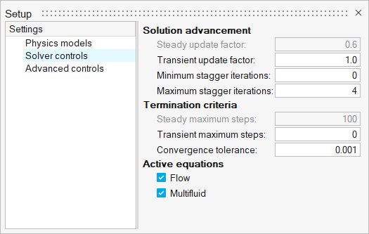

Click the Solver Controls setting and set the Maximum
stagger iterations to 4.

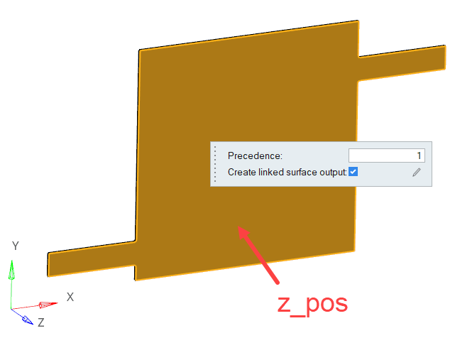

Select the right most face on the positive z-axis, as shown in the figure
below.
Figure 12.
- In the Boundaries legend, double-click on Slip, rename it to z_pos and press Enter.

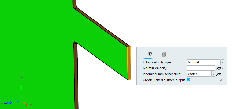

Select the inlet surface shown in the figure below.
Figure 14.
In the microdialog,
- Set the Inflow velocity type to Normal.
- Set the Normal velocity to 1.5 m/s.
- Select Water as the incoming immiscible fluid.
On the guide bar, click

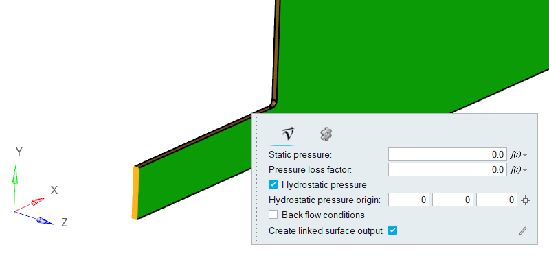

Click the Outlet tool.
Figure 15.
Select the outlet surface shown in the figure below.
Figure 16.
- In the microdialog, activate Hydrostatic pressure.
to execute

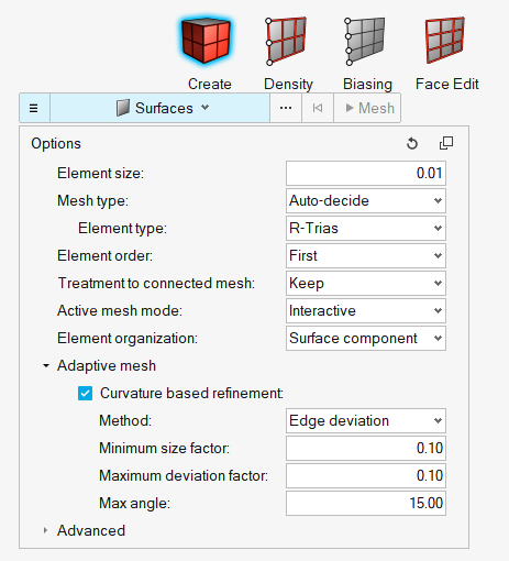

From the Mesh ribbon, click the Interactive tool.
Figure 17.
By default, the Create should be selected from the secondary ribbon. -
Click
on the guide bar to open the options menu, then make the following
changes:
Figure 18.
- On the guide bar, change the entity selector to Solids then select the solid in the modeling window.
- Click Mesh in either the microdialog or on the guide bar to generate the surface mesh.
- Once the surface mesh is created, press Esc to exit out of the tool.

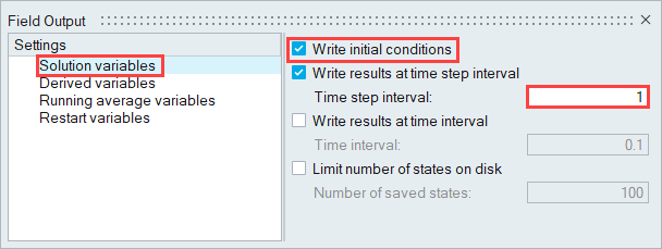

From the Solution ribbon, click the Field tool.
Figure 21.
The Field Output dialog opens. - Click the Solution variables setting.
- Activate the Write initial conditions option.
- Verify that the Write results at time step interval option is active.
Set the Time step interval to 1.
Figure 22.

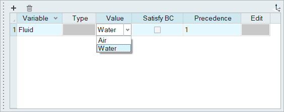

the top-left corner, select Fluid, then click in empty
space in the dialog.
Change the Value field to Water.

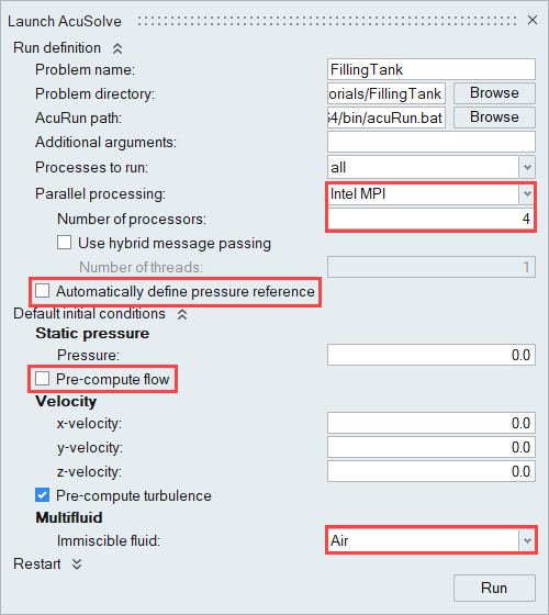

Figure 28.
The Launch AcuSolve dialog opens. - Set the Parallel processing option to Intel MPI.
- Deactivate the Automatically define pressure reference option.
- Expand the Default initial conditions tab and deactivate the Pre-compute flow option.
- Set the x-velocity to 0.
- Set the Immiscible fluid to Air (if not already set).
Leave the remaining options as default and click
Run to launch AcuSolve.

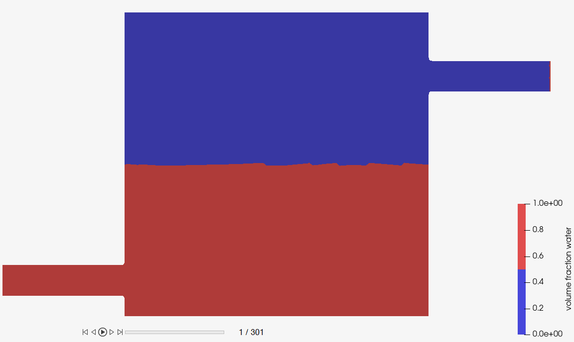

Click the Top face on the View Cube to align the
model.
Figure 30.
- Right-click on the z_pos boundary in the Post Browser and select Edit.
- In the display properties microdialog, set the display to volume fraction water.
Activate the Legend toggle and click
to refresh the range.
Click
, set the Colormap style to
Filled, the Number of colors to
2, and the Colormap Name to Rainbow
Desaturated.
Figure 31.
Click
on the guide bar.
Click
at the bottom of the modeling window to view a live animation of the flow.
