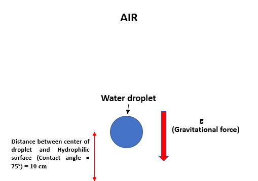

Problem Description
The Open File dialog opens. - Browse to the directory where you saved the model file. Select the HyperMesh file ACU-T4003_FallingDroplet.hm and click Open.
- Click .
Create a new directory named ContactAngle and navigate into this directory.
- Enter FallingDroplet as the file name for the database, or choose any name of your preference.

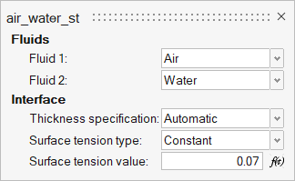

In the new dialog, rename the material to air_water_st
by clicking the name in the top-left corner, then enter the properties shown
below.
Figure 5.
Figure 6.

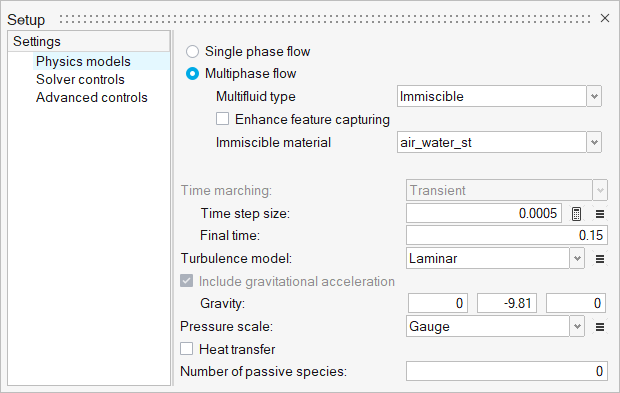

The Setup dialog opens. -
Under the Physics models setting:
- Activate the Multiphase flow radio button.
- Set the Multifluid type to Immiscible and the Immiscible material to air_water_st
- Set the Time step size to 0.0005 and the Final time to 0.15
- Select Laminar as the Turbulence model.
- Set the gravity to -9.81 m/sec2 in the y direction.
Figure 7.

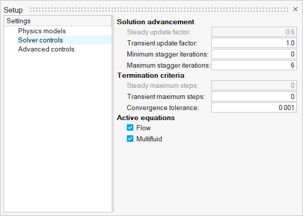

Click Solver controls and verify the following:
- Minimum stagger iterations: 0
- Maximum stagger iterations: 6
- The Flow and Multifluid checkboxes are activated.
Figure 8.
- Close the dialog and save the model.

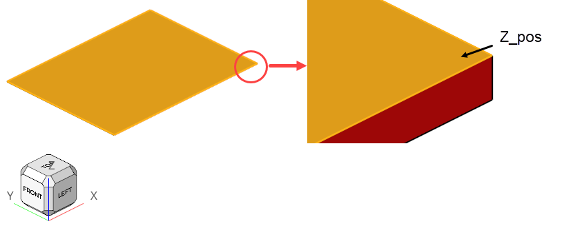

From the Flow ribbon, click the Symmetry tool.
Figure 10.
Click
on the View Controls toolbar and
set the model orientation to Isometric.
Select the Z-Positive face, as highlighted below.
Figure 11.
- In the Boundaries legend, double-click on Symmetry and rename it to Z_pos

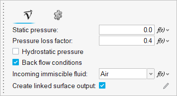

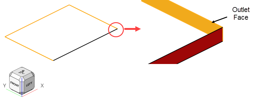

Click the Outlet tool.
Figure 12.
- In the Boundaries legend, right-click on Default Wall and select Isolate.
Click
Select the top and side faces, as highlighted below.
Figure 13.
In the microdialog, set the following properties then
click
on the guide bar.
Figure 14.

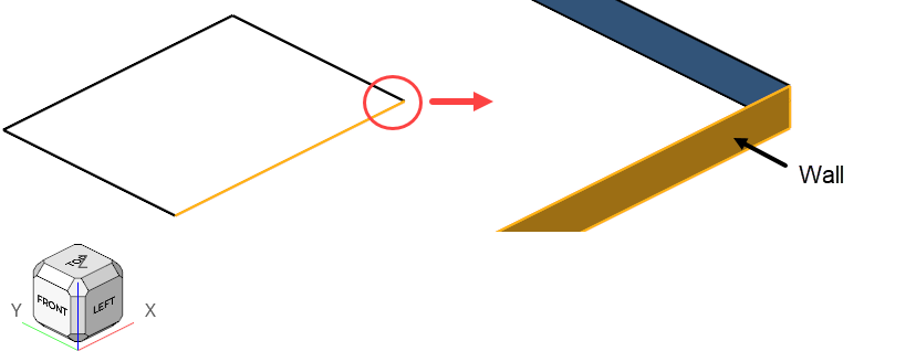

Click the No Slip tool.
Figure 15.
- In the Boundaries legend, Isolate the Default Wall then Show the Outlet faces.
Select the face highlighted below.
Figure 16.

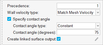

In the microdialog, activate the Specify
contact angle checkbox, set the Contact angle value to
75, then click
on the
guide bar.

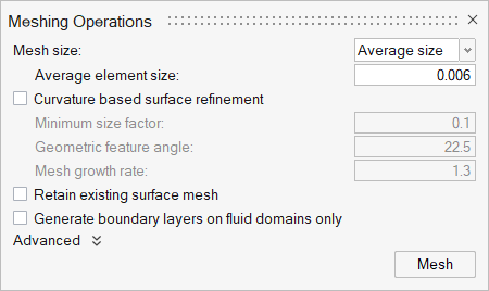

Generate the Mesh
From the Mesh ribbon, click the
Volume tool.
Figure 18.
The Meshing Operations dialog opens. - Check that the Average element size is 0.006.
Accept all other default parameters.
Figure 19.
Click Mesh.
The Run Status dialog opens. Once the run is complete, the status is updated and you can close the dialog.Tip: Right-click on the mesh job and select View log file to view a summary of the meshing process.

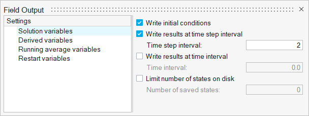

From the Solution ribbon, click the Field tool.
Figure 20.
The Field Output dialog opens. - Click the Solution variables setting.
- Activate the Write initial conditions checkbox.
Verify that the Write results at time step interval
checkbox is active.
Figure 21.

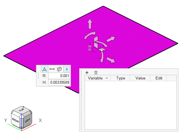

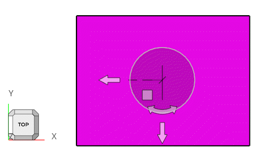

From the Solution ribbon, Zones tool group, click the Cylinder tool.
Figure 22.
- Select the Top face on the View Cube to orient the model.
Double-click on the geometry to create the cylinder-shaped zone then press
Esc.
Figure 23.

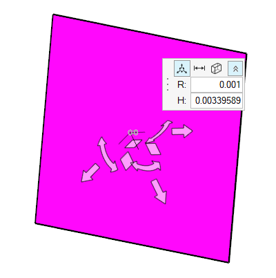

- To provide the dimensions of the cylinder, right click on Nodal initial condition cylinder in the legend and select Edit.
In the microdialog, click the icon on the right to
expand the menu, then set the radius to 0.001 and the
height to 0.00339589
Figure 24.

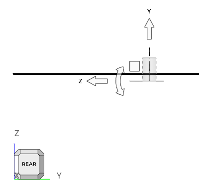

Select the Rear face on the View Cube and verify that
cylinder zone is passing over the domain completely as shown in below
figure.
Figure 27.

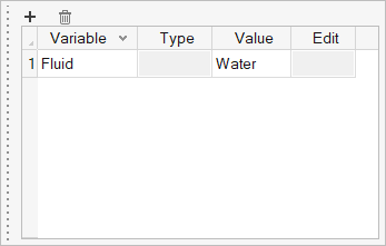

In the initial condition dialog, click
, select
Fluid, then left-click in empty space.
Change the fluid to Water.
Figure 28.

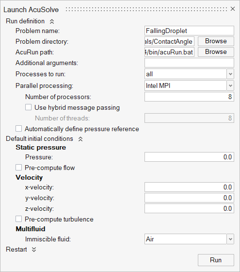

Run AcuSolve
Figure 29.
- Set the Parallel processing option to Intel MPI.
Leave the remaining options as default and click
Run to launch AcuSolve.
Figure 30.
The Run Status dialog opens. Once the run is complete, the status is updated and you can close the dialog.Tip: While AcuSolve is running, right-click on the AcuSolve job in the Run Status dialog and select View Log File to monitor the solution process.

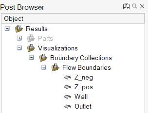

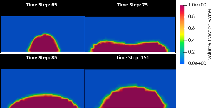

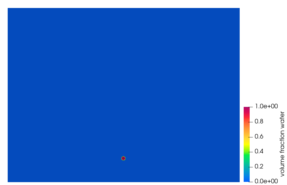

- To check the contours of volume fraction of water on the solid, right-click on Z_pos in the Post Browser and select Isolate.
Right-click on Z_pos again and select
Edit.

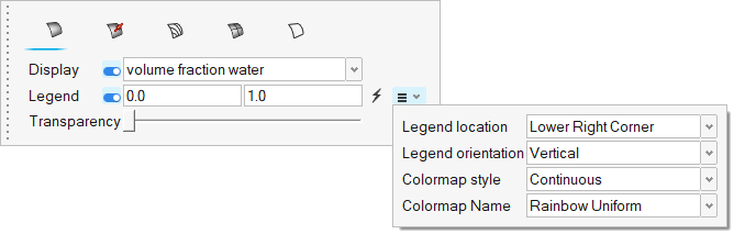

A microdialog for surface coloring opens.
- Set the display to volume fraction water and toggle on the Legend radio button.
Click
in the same dialog and to verify the legend
properties shown below.
You will be able to see the contours of volume fraction of water at time step=1.Figure 32.
Figure 33.
Make sure the time scale at the bottom of modelling window is at time step =1.
Click on the bar to see the falling of droplet and interaction of it with
surface at time step = 65, 75, 85 and final time step (where 1 time step = 2
secs).
Figure 34.
Figure 35.
