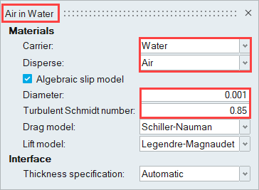

Name the material Air in Water and assign the properties
shown below.
Figure 5.
Figure 6.

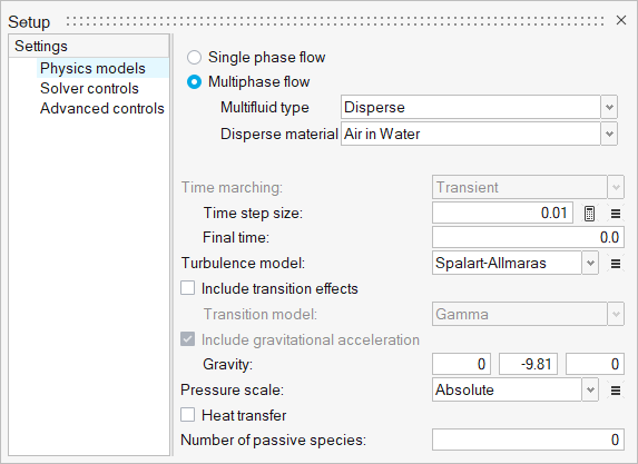

The Setup dialog opens. -
Under the Physics models setting:
- Activate the Multiphase flow radio button.
- Set the Multifluid type to Disperse and the Disperse material to Air in Water
- Set the Time step size to 0.01.
- Select Spalart-Allmaras as the Turbulence model.
- Set the gravity to -9.81 m/sec2 in the y direction.
Figure 7.

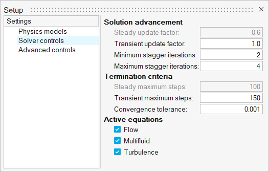

Click the Solver controls setting and verify that:
- Minimum stagger iteration is set to 2.
- Maximum stagger iteration is set to 4.
- Transient maximum step is set to 150.
- The Flow, Multifluid, and Turbulence checkboxes are activated.
Figure 8.

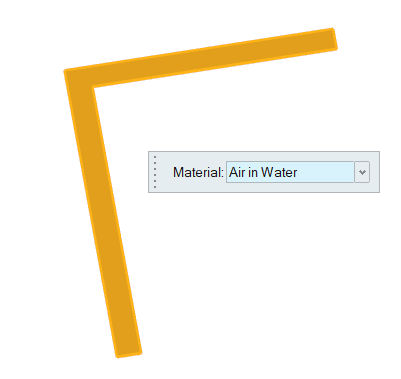

- Select the model solid.
Select Air in Water from the Material drop-down
menu.
Figure 10.

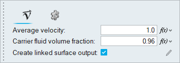

In the microdialog, enter 1.0
for the Average velocity and 0.96 for the Carrier fluid
volume fraction.
Figure 13.

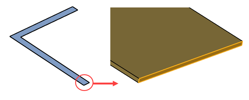

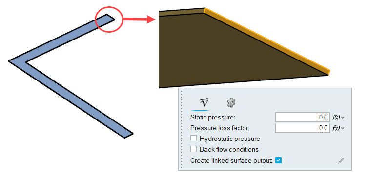

Click the Outlet tool.
Figure 14.
Select the face highlighted in the figure below then click
on the
guide bar.
Figure 15.

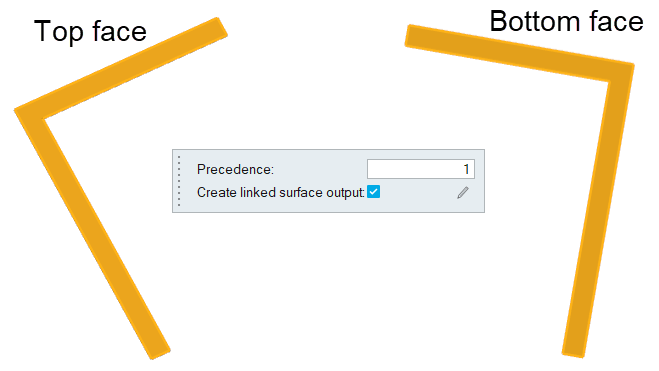

Click the Slip tool.
Figure 16.
Select the top and bottom faces highlighted below then click
on the
guide bar.
Figure 17.

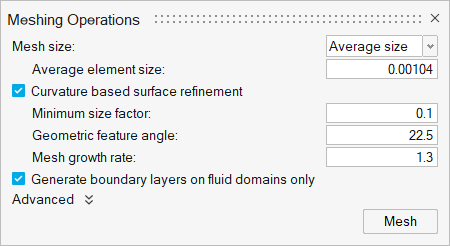

In the Meshing Operations dialog, set the Average Element
size to 0.00104 (if not set already).
Figure 19.
Click Mesh.

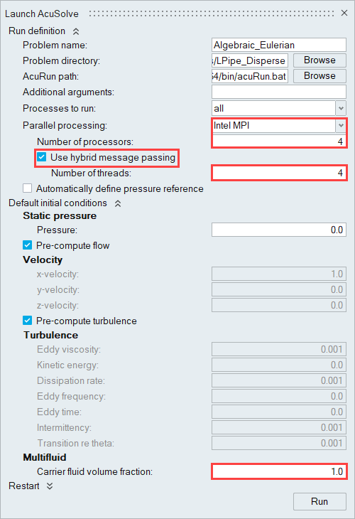

The Launch AcuSolve dialog opens. - Set the Parallel processing option to Intel MPI.
- Check the box for Use hybrid message passing and set the number of threads to the same as the number of processors.
Expand Default initial conditions and verify that the
Carrier field volume fraction is 1.0.
Figure 21.
Click Run to launch AcuSolve.

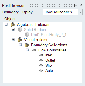

The solid and all the surfaces are loaded in the Post Browser.

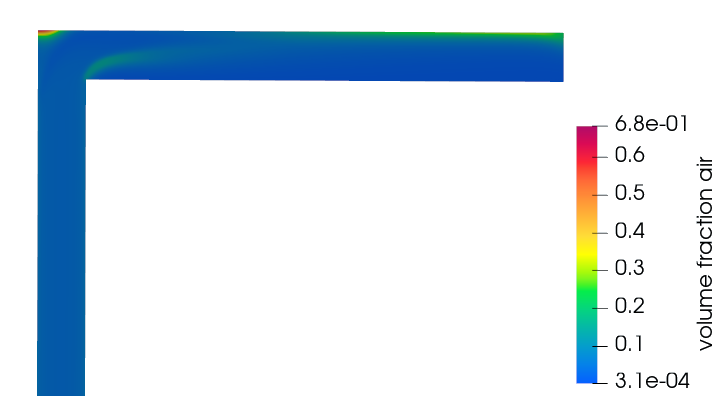

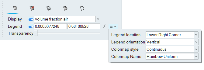

- In the microdialog, set the Display option to Volume fraction air.
Activate the Legend radio button then click
and set the Colormap name to
Rainbow Uniform.
Figure 23.
The volume fraction of air contours are displayed on the model.Figure 24.
