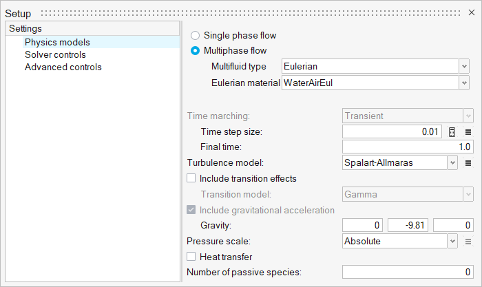

The Setup dialog opens. - Under the Physics models setting, select the Multiphase flow radio button.
- Change the Multifluid type to Eulerian.

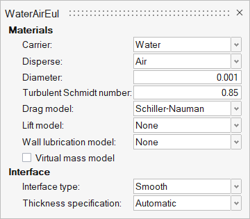

- In the microdialog, click on the top-left corner and change the name to WaterAirEul.
- Set the Carrier field to Water and the Disperse field to Air.
Set the diameter, drag model, and other parameters as shown in the image
below.

- Set Time step size and Final time to 0.01 and 1, respectively. Select Spalart-Allmaras for the Turbulence model.
Set the gravity to 0, -9.81, 0 and the pressure scale to
Absolute.

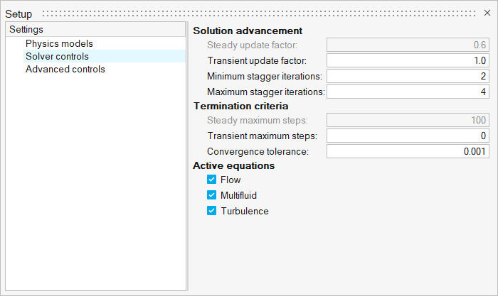

Click the Solver controls setting and set the Minimum
and Maximum stagger iterations to 2 and
4, respectively.
Figure 7.
- Close the dialog and save the model.

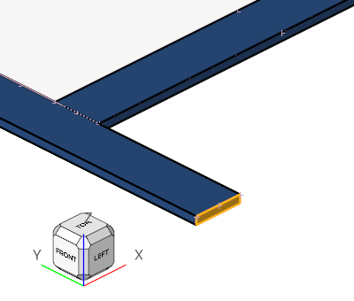

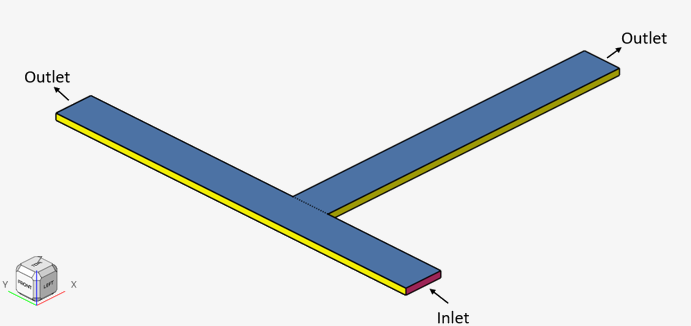

Click the inlet face highlighted in the figure below.

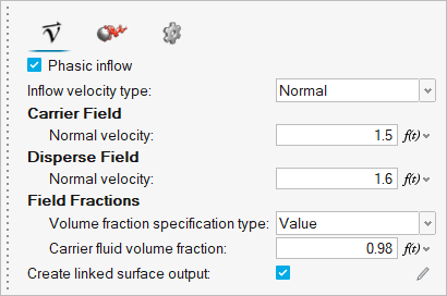

- In the microdialog, activate Phasic inflow and then change the inflow velocity type to Normal.
- Enter a value of 1.5 and 1.6 m/s for the Normal velocity of the Carrier Field and Disperse Field, respectively.
Set the Volume fraction specification type to Value and
set the Carrier fluid volume fraction to 0.98.
Figure 11.

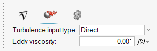

Click the Turbulence tab in the microdialog. Set the Turbulence input type to
Direct and the Eddy viscosity to
0.001.
Figure 12.
Note: When phasic inflow is active, Turbulence input type = Direct should be used. -

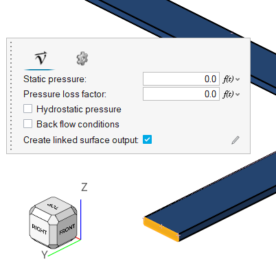

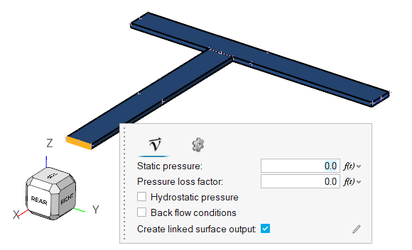

Click the Outlet tool.
Figure 13.
Select the face highlighted below and verify the settings in the microdialog.
Figure 14.
On the guide bar, click
to execute the command and remain in the
tool.
With the Outlet tool still active, select the face highlighted below after
rotating the model. Then click
on the
guide bar.
Figure 15.

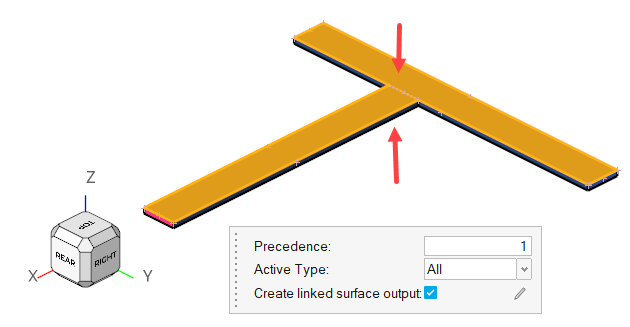

Click the Slip tool.
Figure 16.
Select the top and bottom faces highlighted below then click
on the
guide bar.
Figure 17.

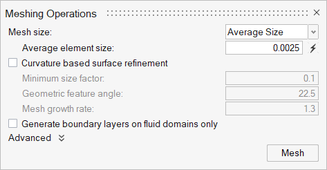

In the Meshing Operations dialog, check that the Average
Element size is set to 0.0025.
Figure 19.
Click Mesh.

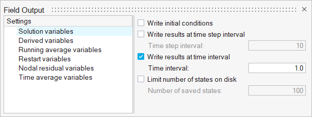

The Field Output dialog opens. - Check the box for Write Initial Conditions.
Set the time interval to 1.
Figure 21.

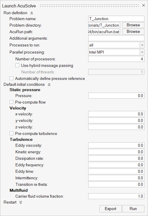

The Launch AcuSolve dialog opens. - Set the Parallel processing option to Intel MPI.
Expand Default initial conditions, uncheck
Pre-compute flow, and set the velocity values to
0. Uncheck Pre-compute
Turbulence.
Figure 23.
Click Run to launch AcuSolve.

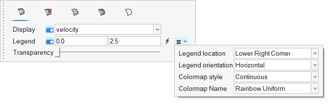

- In the microdialog, set the display variable to velocity.
- Activate the Legend toggle and set the legend limits to 0 and 2.5, respectively.
Click
and set the colormap properties as shown
below.
Figure 25.

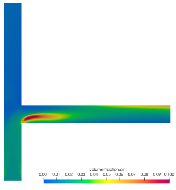

Figure 26.
- In the Post Browser, right-click Boundary Group 7 and select Edit.
- In the microdialog, change the display variable to volume fraction: air and set the legend limits to 0 and 0.1.
Click
on the guide bar to create the volume fraction contour
plot.
Figure 27.
