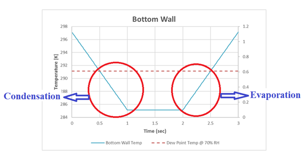

From the above plot, we can see that the Air volume initial temperature is set to 297.15 K. The Bottom Wall temperature drops to 285.13 K over 1 sec, maintains 285.13 K for 1 sec, and then rises back to 297.15 K over 1 sec. The dew point temperature of the air at 70% RH is 291.14 K and is reached at 0.5 and 2.5 sec. On the whole we can see that both condensation and evaporation occurs when the dew point temperature is reached, as explained above.

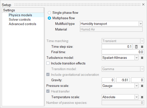

Under the Physics models setting:
- Select the Multiphase flow radio button.
- Set the Multifluid type to Humidity transport.
- Set the Time step size to 0.1 s and the Final time to 10 s.
- Set the Turbulence model to Spalart-Allmaras.
- Set the Gravity to (0,-9.81,0).
Set the Pressure scale to Gauge and click
. In the microdialog, set the Absolute pressure offset to 101325 Pa
then press Esc.

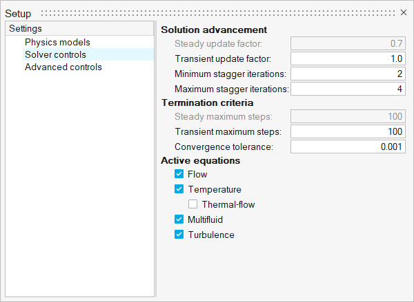

- Click the Solver controls setting.
Set the Minimum stagger iterations to 2 and the Maximum
to 4.
Figure 7.

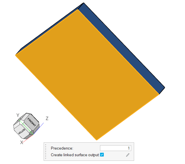

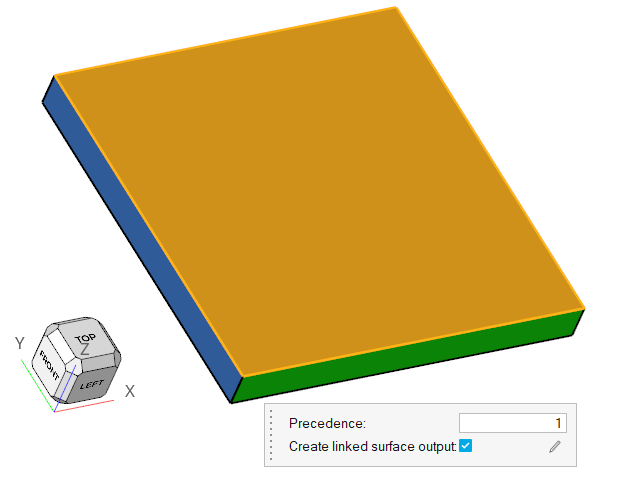

Select the bottom surface (the surface with the minimum y-coordinate).
Figure 9.

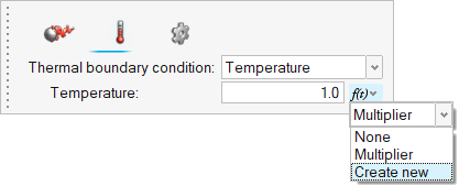

- In the microdialog, click on Temperature tab and set the Thermal boundary condition to Temperature.

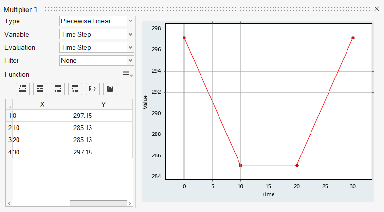

Set the Temperature to 1, expand the multiplier function
drop-down, and select Create new.
Figure 10.
- In the multiplier dialog, set the Type to Piecewise Linear.
- Set the Variable to Time Step.
Click
twice to add two rows.
Enter the values as shown in the figure below then close the dialog.
Figure 11.

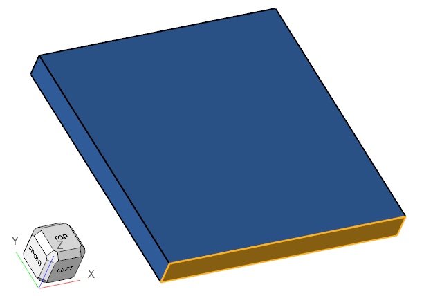

Click the Slip tool.
Figure 12.
Select the surface with the maximum z-coordinate.
Figure 13.
- In the Boundaries legend, double-click on Slip and rename it to z_pos.

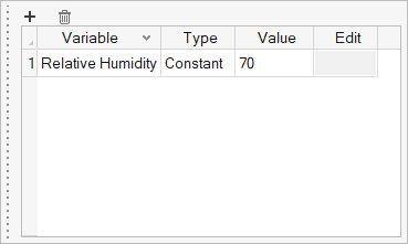

In the dialog, click
, select Relative Humidity
from the list of variables then click on the white space in the dialog.
Set the value to 70.

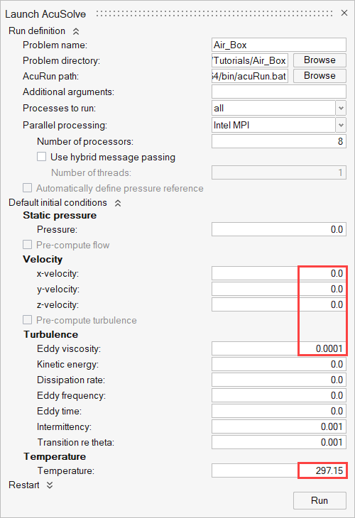

Run AcuSolve
Figure 17.
- Set the Parallel processing option to Intel MPI.
- Expand Default initial conditions and enter the values as shown below.
Leave the remaining options as default and click
Run to launch AcuSolve.

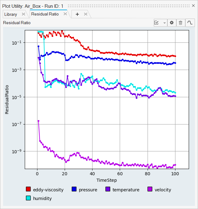

Click the Plot tool.
Figure 19.
In the Plot Utility dialog, double-click on
Residual Ratio to plot the residuals.
Figure 20.

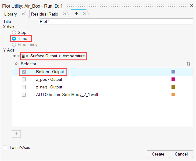

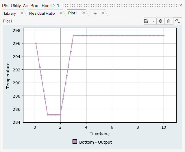

- Set the X-Axis to Time.
To set the Y-Axis variable, click
and then double click on
temperature under Surface Output from the list of
variables.
In the list of surface outputs, select Bottom -
Output.
Figure 21.
Click Create.
Figure 22.

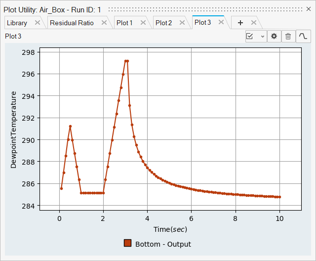

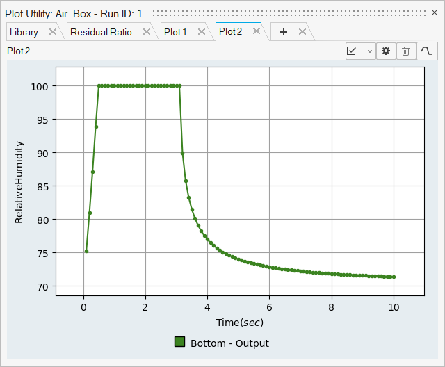

Similarly, view the plots for Relative Humidity and Dewpoint Temperature.
Figure 23.
Figure 24.

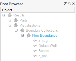

The solid and all the surfaces are loaded in the Post Browser.
In the Post Browser, click on the icon beside
Flow Boundaries to turn off the display of all the
surfaces.

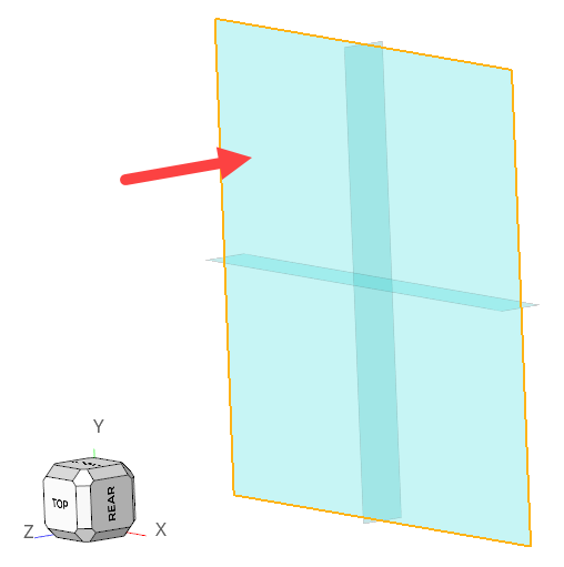

Select the x-y plane in the modeling window.
Figure 28.
In the slice plane microdialog, click
to
create the slice plane.

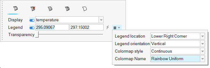

- In the display properties microdialog, set the display to temperature.
Click
then activate the Legend
toggle.
Click
and set the Colormap Name to Rainbow
Uniform.
Figure 29.

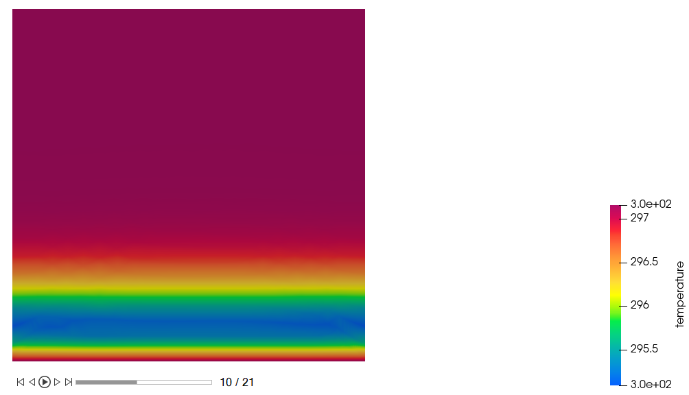

On the guide bar, click
to
create the temperature contour plot.

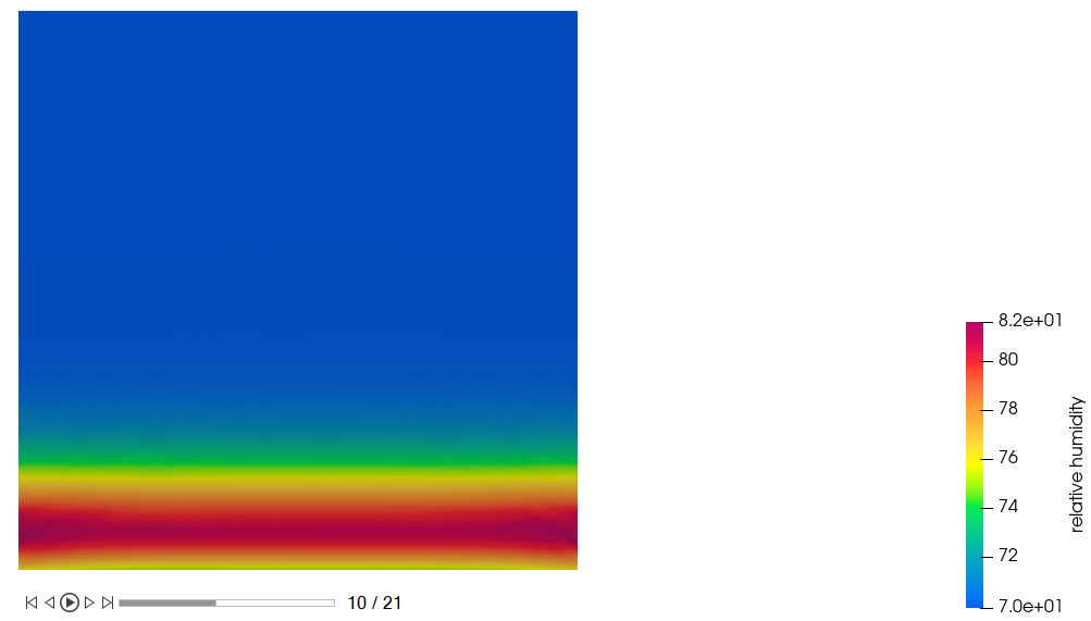

Figure 30.
Hide the temperature contour, then repeat the steps 6-12 to create a similar
contour plot for relative humidity.

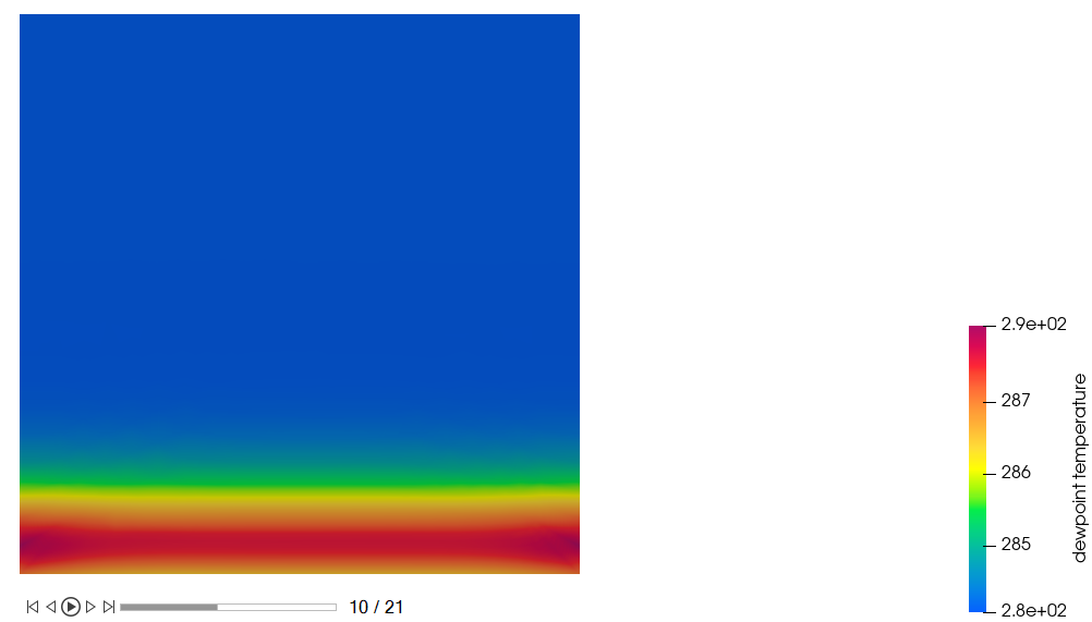

Figure 31.
Hide the relative humidity contour, then repeat the steps 6-12 to create a
similar contour plot for dew point temperature.
Figure 32.
