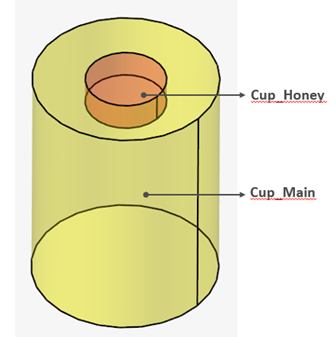

The problem to be addressed in this tutorial is shown schematically in Figure 1. It consists of two sections, Cup_Honey and Cup_Main. Honey enters from Cup_Honey to Cup_Main and mixes with water.

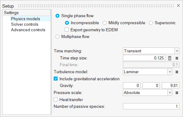

  2. Under the Physics models setting:
    1. Set Time marching to Transient.
    2. Set the Time step size to 0.125 sec.
    3. Select Laminar as the Turbulence model.
    4. Check the Include Gravitational Acceleration option and set the gravity to 9.81 m/s2 in the z direction.
    5. Set the Number of passive species to 1.

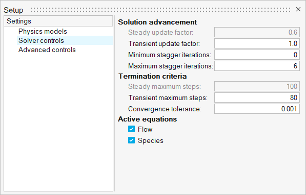

  3. Click the Solver controls setting then set the Transient maximum steps to 80.
    Figure 7.
  4. Close the dialog and save the model.

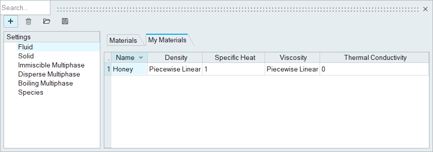

  2. Under Settings, click Fluid, then click the My Materials tab.
  3. Click to create a new material.

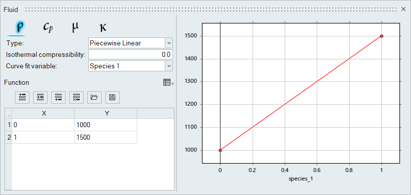

  4. For density:
    1. Change the type to Piecewise Linear.
    2. Define the Curve fit variable as Species 1.
    3. Click twice under Function then enter 1000 kg/m3 and 1500 kg/m3 in the Y column for the density of water and honey, respectively.
    Figure 9.

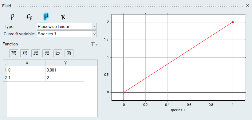

  5. Similarly, define the viscosity (kg/m-sec) values for water and honey according to the figure below.
    Figure 10.
  6. Close the material editing dialog, then rename the Fluid material to Honey.

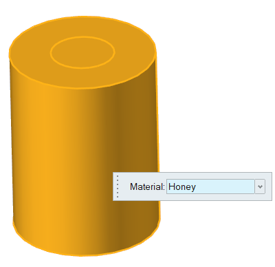

  8. Select both model volumes.
  9. Select Honey from the Material drop-down menu.
    Figure 13.
  10. On the guide bar, click to execute the command and exit the tool.

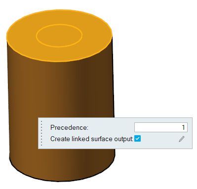

  1. From the Flow ribbon, click the Slip tool.
    Figure 14.
  2. Select the top two surfaces highlighted in the figure below then click on the guide bar.
    Figure 15.

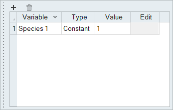

    3. In the microdialog, click and select Species 1 from the list.
    4. Set the Type to Constant and the Value to 1.

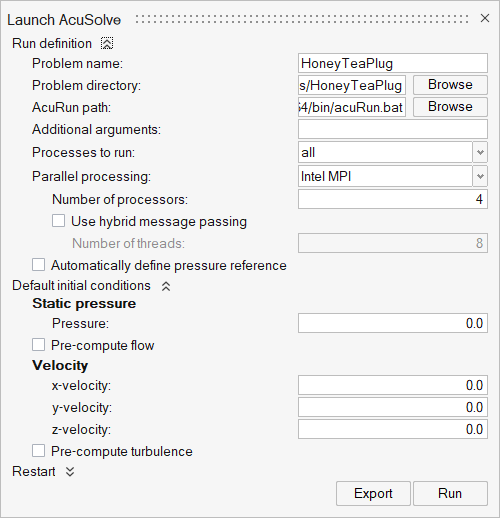

    The Launch AcuSolve dialog opens.
  2. Set the Parallel processing option to Intel MPI.
  3. Optional: Set the number of processors to 4 or 8 based on availability.
  4. Uncheck the Automatically define pressure reference option.
  5. Expand Default initial conditions and uncheck the Pre-compute flow and Pre-compute turbulence options.
  6. Set all the velocity components to 0 m/s.
  7. Leave the remaining options as default and click Run to launch AcuSolve.

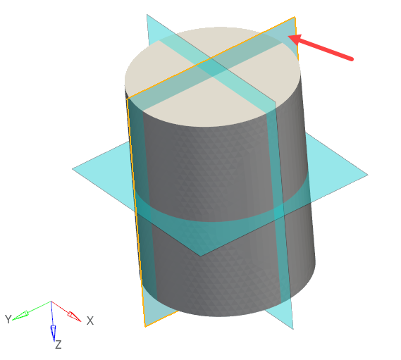

  4. From the Post ribbon, click the Slice Planes tool.
    Figure 24.
  5. Select the plane shown in the figure below.
    Figure 25.

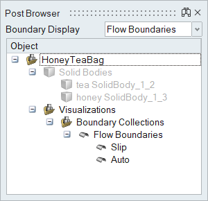

  6. In the Post Browser, hide the Slip and Auto surfaces.

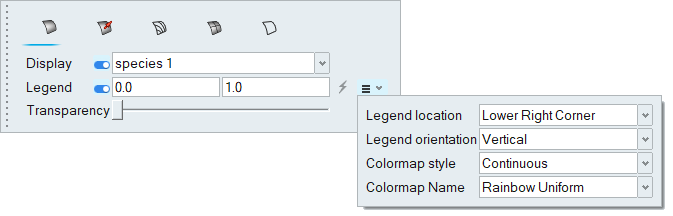

  8. In the display properties microdialog, change the Display option to species 1.
  9. Activate the Legend radio button then click and set the Colormap name to Rainbow Uniform.
    Figure 26.
  10. Click on the guide bar.

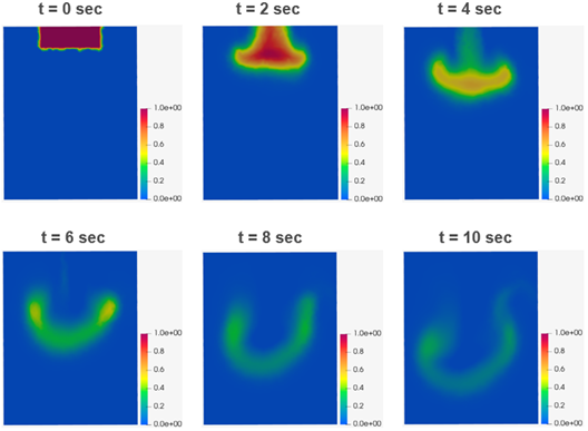

  12. Adjust the time scale to show 2 sec, 4, sec, 6 sec, 8 sec, and 10 sec.
    The distribution of species 1 (honey) at those times is shown below.

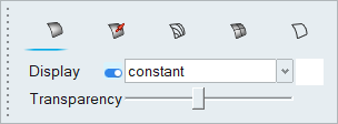

  16. In the microdialog, move the Transparency slider to the middle to add a transparency effect.

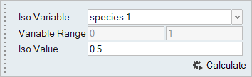

    Figure 31.

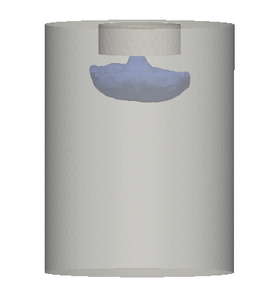

  19. In the Iso-function microdialog, change the Iso Variable to species 1 and set the Iso Value to 0.5
    Figure 32.
  20. Click Calculate then click .
    Figure 33. Distribution of species at 3 sec
