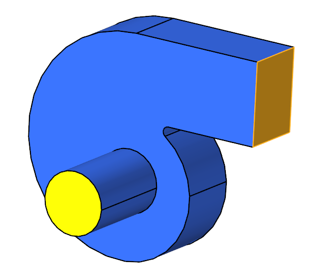

The problem to be addressed in this tutorial is shown schematically in Figure 1 and Figure 2. It consists of a centrifugal blower with forward curved blades. The fluid through the inlet plane enters the hub of the blade wheel, radially accelerates due to centrifugal force as it flows over the blades, and then exits the blower housing through the outlet plane.
Figure 1. Schematic of Centrifugal Blower

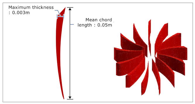

The fan blades have a mean chord length and width of 0.05 m. The maximum thickness of the blades is 0.003 m.
Figure 2. Schematic of Fan Blades

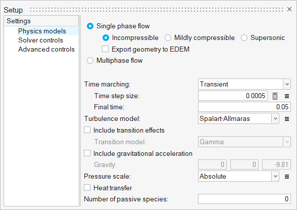

  2. Under the Physics models settings:
    1. Set Time marching to Transient.
    2. Set the Time step size to 0.0005 and the Final time to 0.05.
    Figure 5.

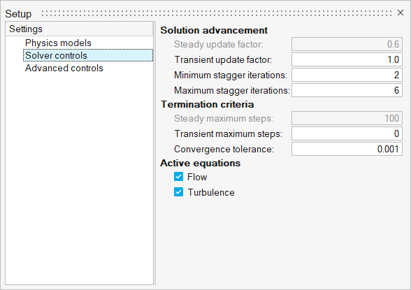

  3. Click Solver controls.
  4. Set the Minimum stagger iterations and Maximum stagger iterations to 2 and 6, respectively.
    Figure 6.

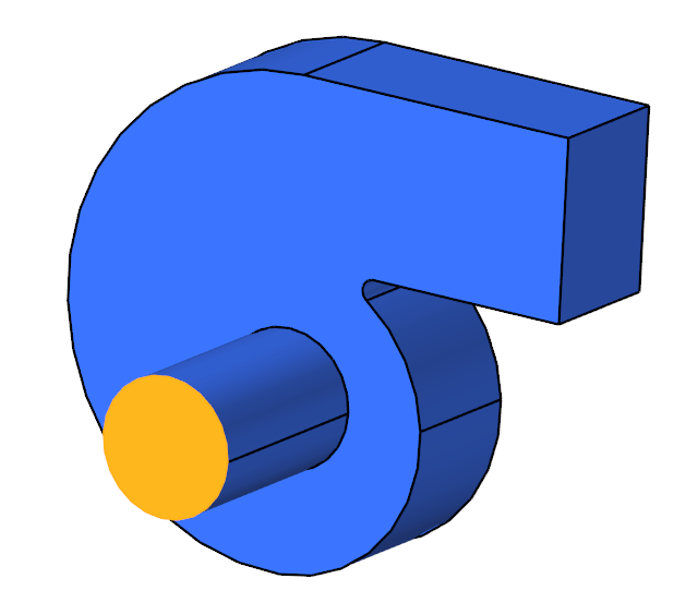

  1. From the Flow ribbon, Pressure tool group, click the Stagnation Pressure tool.
    Figure 7.
  2. Click the face of the inlet.
    Figure 8.

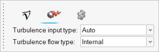

  3. In the microdialog, click the Turbulence tab.
  4. Set the Turbulence input type to Auto.
  5. Set the Turbulence flow type to Internal.
    Figure 9.

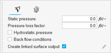

  8. Click the Outlet tool.
    Figure 10.
  9. Click the face of the outlet.
    Figure 11.
  10. In the microdialog, make sure both Static pressure and Pressure loss factor are 0.
    Figure 12.

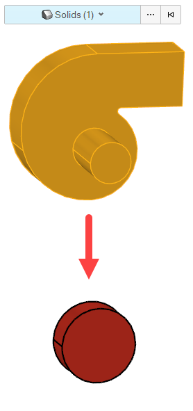

  1. Hide the housing solid.
    1. Set the entity selector to Solids.
    2. Select the centrifugal housing.
    3. Right-click and select Hide or press H on your keyboard.
    Figure 14.

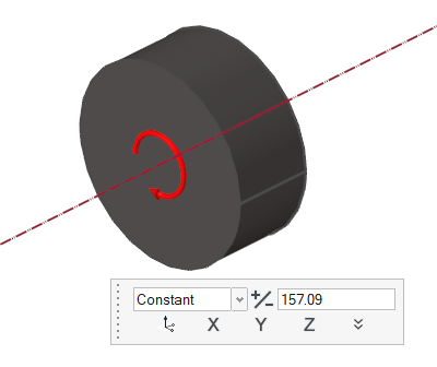

  2. Click the Rotation tool.
    Figure 15.

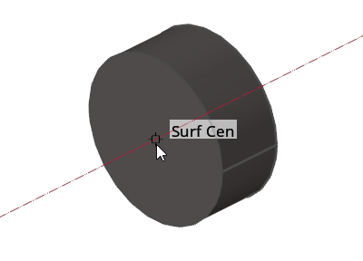

  3. Select the solid in the modeling window.
  4. On the guide bar, click Axis.
  5. Define the axis of rotation.
    1. Use the Surf Center snap point to place the axis in the middle of the centrifugal blower.
      Figure 16.
    2. In the microdialog, click Z to align the axis with the global z axis.
    3. Click to change the rotational direction.
    4. Enter a value of 157.09 in the text field.
    Figure 17.

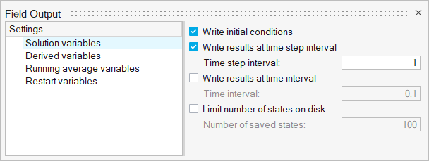

Define Nodal Output Frequency
  1. From the Solution ribbon, click the Field tool.
    Figure 18.
    The Field Output dialog opens.
  2. Check the Write initial conditions checkbox.
  3. Check the Write results at time step interval checkbox.
  4. Set the Time step interval to 1.
    Figure 19.

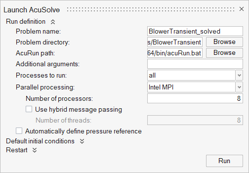

  1. From the Solution ribbon, click the Run tool.
    Figure 20.
  2. Set the Parallel processing option to Intel MPI.
  3. Optional: Set the number of processors to 4 or 8 based on availability.
  4. Deactivate the Automatically define pressure reference option.
  5. Leave the remaining options as default and click Run to launch AcuSolve.

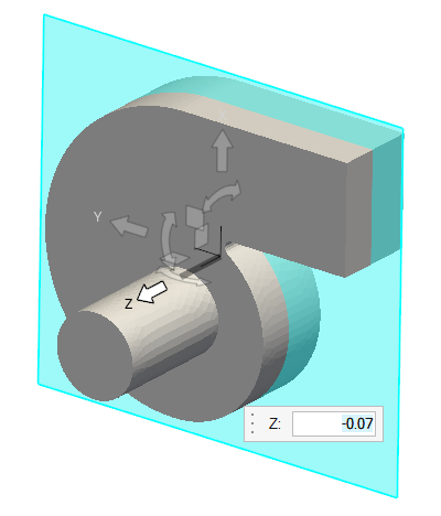

  4. Click the Slice Planes tool.
    Figure 22.
  5. Select the x-y plane in the modeling window.
  6. In the microdialog, click and move the plane along its normal direction a distance of -0.07.
    Figure 23.
  7. Press Esc to exit the Move tool context.
  8. In the slice plane microdialog, click to create the slice plane.

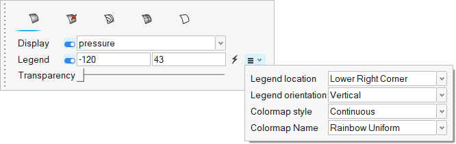

  9. In the display properties microdialog, toggle the Legend radio button and set the bounds to -120 and 43.
  10. Click and set the Colormap Name to Rainbow Uniform.
    Figure 24.

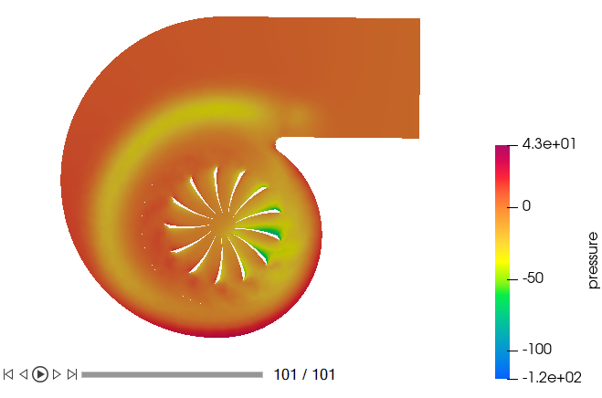

  13. Click the play button on the Animation toolbar.
    Figure 25.
  14. Go to File > Export > Results to save the pressure contour animation.
