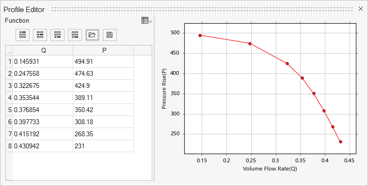

Click
beside P-Q Curve Type to open
the Profile Editor.
Click
, browse to the location where
you saved fanPQcurve.csv, and open it.
Figure 14.
Note: Units for volume flow (Q) and Pressure Rise (P) are, respectively, m3/sec and Pa. -

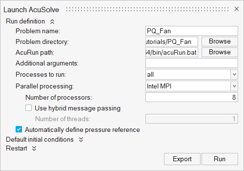

The Launch AcuSolve dialog opens. - Set the Parallel processing option to Intel MPI.
Leave the remaining options as default and click
Run to launch AcuSolve.

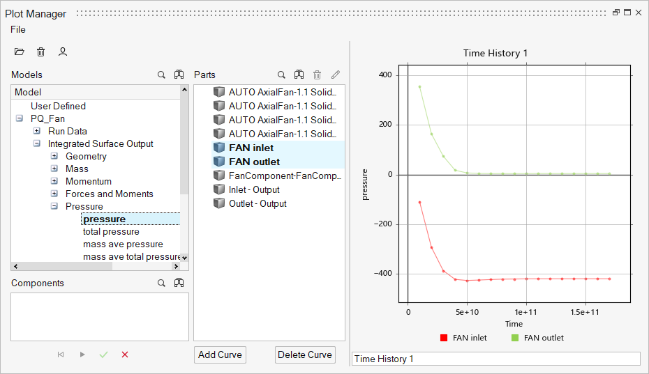

Click
to create a new plot.
- In the Data Tree, expand then select pressure.
Under Parts, select Fan_inlet and
Fan_oultet to display pressure at the inlet and
outlet.
Figure 32.

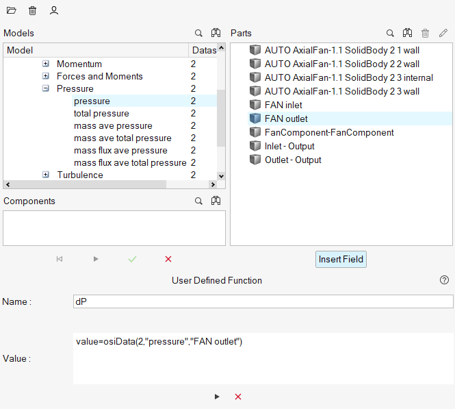

- Right-click User Defined under the Model panel to create a user defined function.
- In the Name field, enter dP.
- In the Value field, type value=.
Under Parts, choose FAN outlet then click
Insert Field to insert the field as part of the
value, as shown below.
Figure 33.

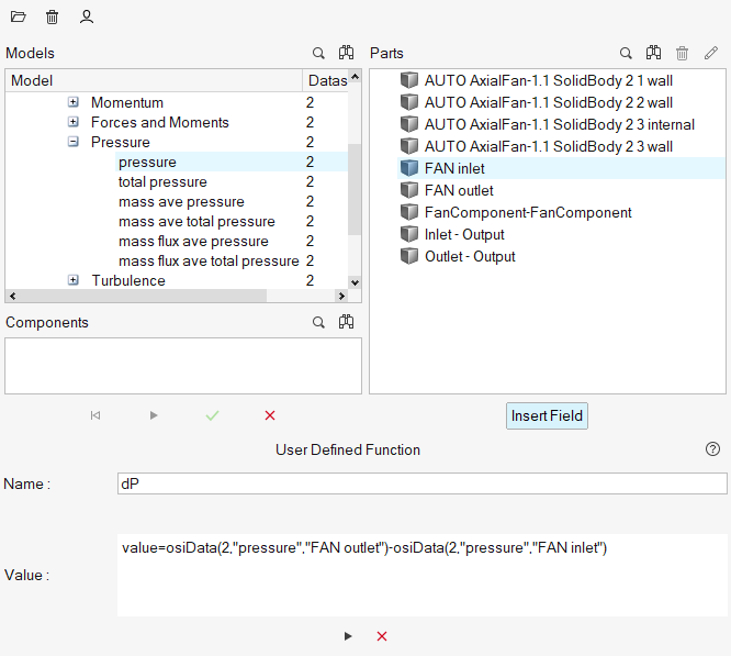

- Type - at the end of the user defined function value.
- Under Parts, choose FAN inlet then click Insert Field to insert the field as part of the value.
Click
to add the user defined function.

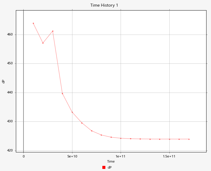

Click the x axis to switch to Time Steps.
Figure 35.
From the above figure, the pressure got stabilized at around the 6th iteration and remains constant with pressure difference between the FAN_inlet and FAN_outlet of 423.97 Pa for a given volume flow rate 0.322675 m3/sec, which is very near compared to the reference pressure increase of 424.9 Pa.
