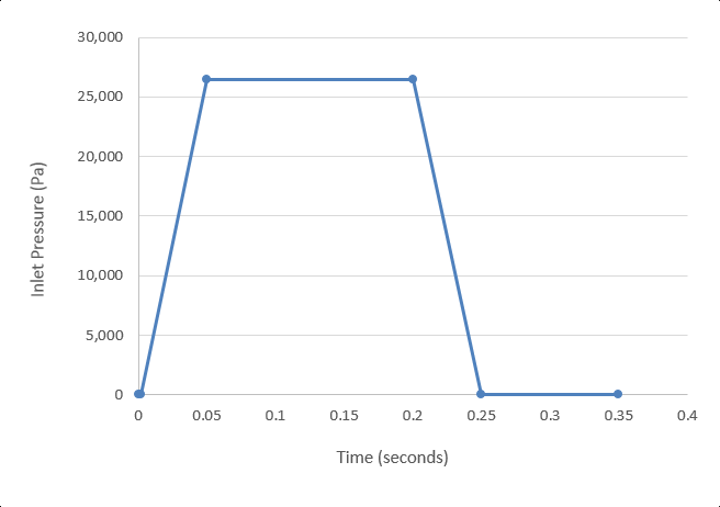

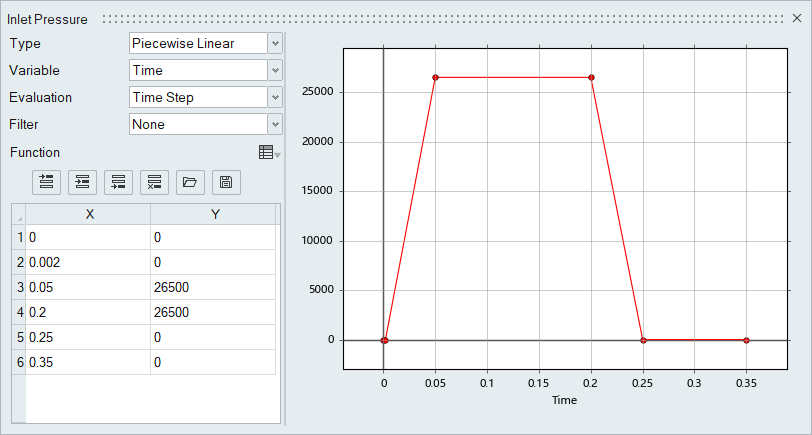

Create a Multiplier Function for the Inlet Pressure
From the Flow ribbon, click the arrow next to the
Setup tool set, then select Multipliers.
Figure 11.
Click
in the
Multiplier Library dialog.
- In the multiplier creation dialog, change the name of the multiplier function to Inlet Pressure by clicking on the top-left corner.
- Set the Type to Piecewise Linear.
- Verify that the Variable is set to Time and Evaluation is set to Time Step.
Click
four
times to add four rows to the bottom of the table.
Enter the table values according to the image below.
Figure 12.

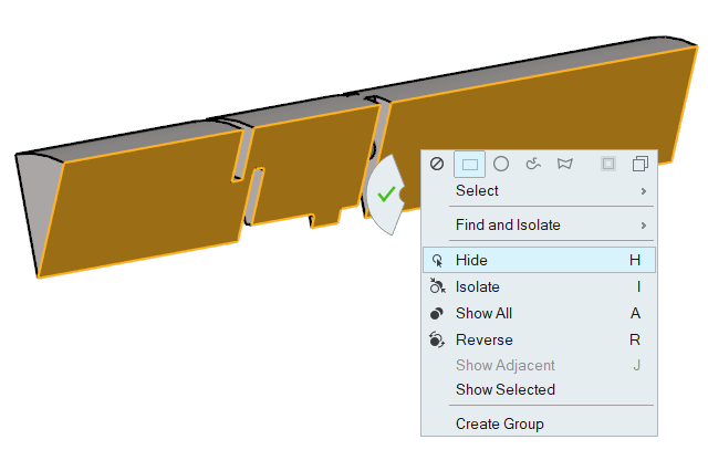

For convenience, hide the Front_symmetry and Back_symmetry faces in the
modeling window by selecting the four surface and
then pressing H on the keyboard or by right-click and
selecting Hide from the context menu.

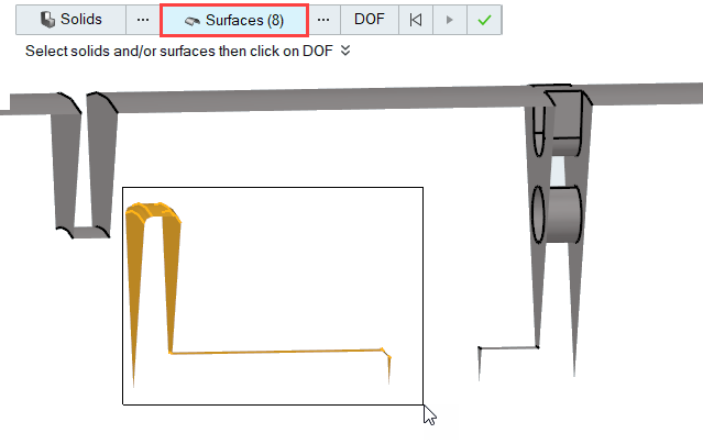

Select the valve wall surfaces, shown in the figure below, by using box
selection (hold and drag the left mouse button).
The number of surfaces selected should be 8, which will show on the guide bar.
Figure 27.

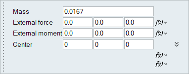

- On the guide bar, click on DOF then click anywhere on the valve wall surfaces in the modeling window.
In the microdialog that appears, enter the following
values:
- Mass: 0.0167 kg
- Center: (0, 0, 0)
Figure 28.

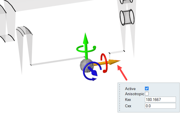

- Click on the X-displacement arrow in the modeling window.
In the microdialog, enter a value of
180.1667 kg/sec2 for Kxx, the stiffness of
the spring.
Figure 29.

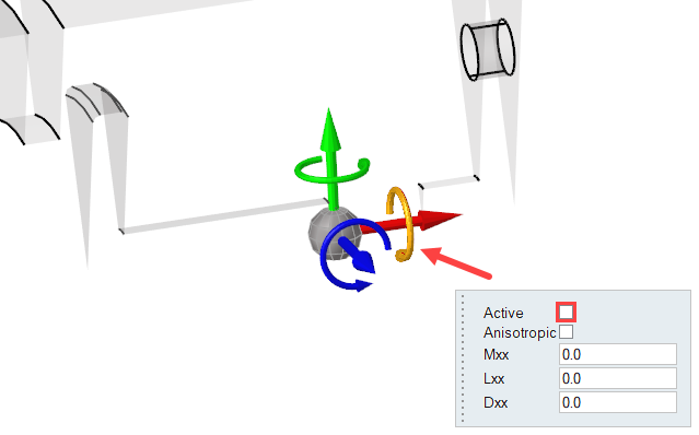

Click on the X-rotation arrow and de-activate it.
Figure 30.
Similarly, click on the remaining four arrows (Y-displacement, Y-rotation,
Z-displacement, and Z-rotation) and de-activate them.
This will ensure that the valve body translates only in the x-direction.

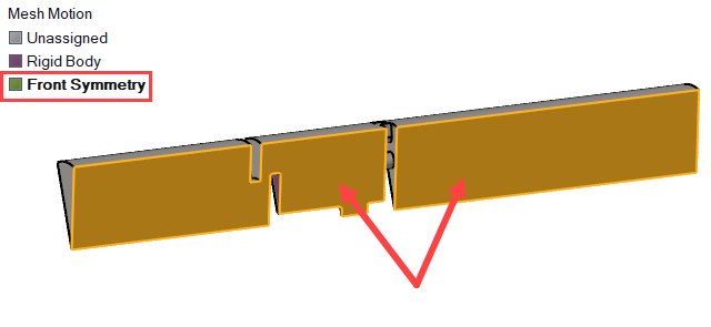

- Select the two front symmetry surfaces shown in Figure 32.
In the Mesh Motion legend, rename Planar Slip to
Front_symmetry by double-clicking on the name.
Figure 32.

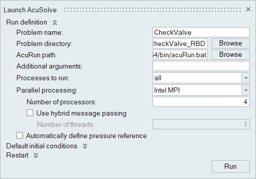

Launch AcuSolve
Figure 49.
- Set the Parallel processing option to Intel MPI.
- Deactivate the Automatically define pressure reference option.
Leave the remaining options as default and click
Run to launch AcuSolve.
Figure 50.
The Run Status dialog opens. Once the run is complete, the status is updated and you can close the dialog.

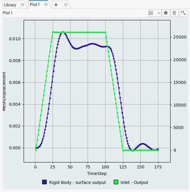

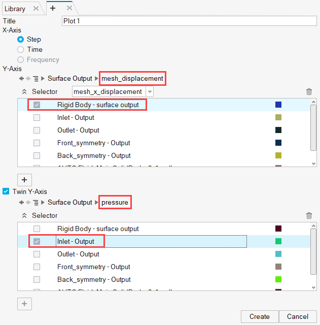

Monitor Results
From the Solution ribbon, click the Plot tool.
Figure 51.
Click
next to the Library tab.
Keep the X-axis set to Step. For the Y-axis, click the
tree browser
and select
mesh_displacement under Surface Output.
mesh_x_displacement is selected by default for the coordinate direction. - Check the box for Rigid Body - surface output under Selector.
- Check the box for Twin Y-Axis.
- Click the tree browser for the second Y-axis and select pressure under Surface Output.
Check the box for Inlet - Output under Selector.
Figure 52.
Click Create.
Figure 53.

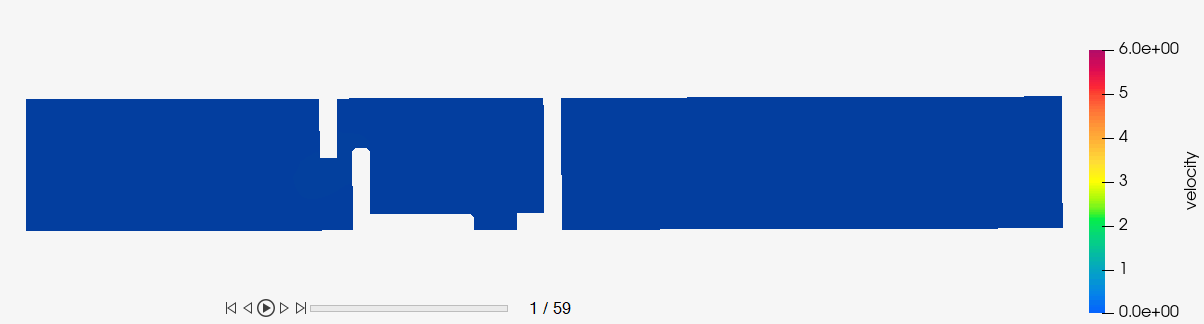

- In the Post Browser, right-click on Front_symmetry and select Isolate.
- Right-click on Front_symmetry once more and select Edit.
- In the display properties microdialog, set the display to velocity.
- Activate the Legend toggle and set the max velocity to 6.0.
Click
and set the Colormap Name to Rainbow
Uniform.
Figure 55.
Click
on the guide bar.
Click
at the bottom of the modeling window to view a live animation of the flow.
Figure 56.

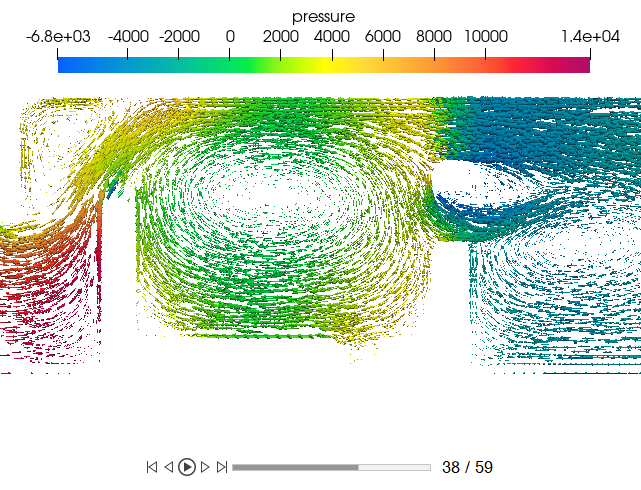

Display Pressure Contours and Velocity Vectors on a Section Cut
- Right-click in the modeling window and select Show All.
Click the Slice Planes tool.
Figure 57.
- Select the plane perpendicular to the z-axis.
Make sure the View Cube is aligned with the Top face.
Figure 58.
Click
in the slice plane microdialog.

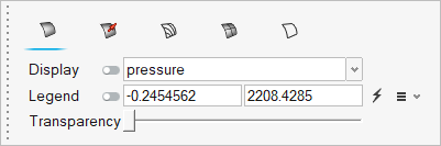

Turn off the Display in the Contour tab of the display
properties microdialog.
Figure 59.

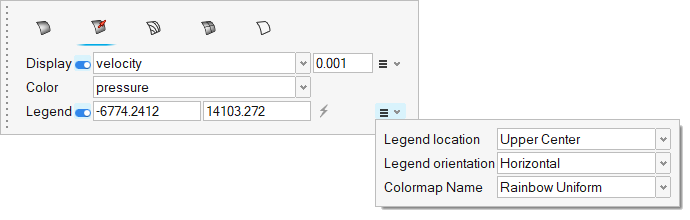

- Click the Vector Display tab.
- Turn the Display on, set the variable to velocity, and the value to 0.001.
- Set the Coloring to pressure.
Activate the Legend toggle and click
to reset the range.
Click
, set the Legend location to Upper
Center, the Legend orientation to
Horizontal, and the Colormap Name to
Rainbow Uniform.
Figure 60.
Click
on the guide bar.
In the Post Browser, right-click on Slice Plane
1 and select Isolate.
Figure 61.
