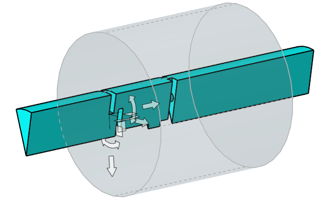

The pipe has an inlet diameter of 0.08 m and is 0.3 m long. The check-valve assembly is 0.085 m downstream of the inlet. It consists of a plate 0.005 m thick with a centered orifice 0.044 m in diameter and a shutter with an initial position 0.005 m from the opening, simulating a nearly closed condition. The shutter plate is 0.05 m in diameter and 0.005 m thick. The shutter plate is attached to a stem 0.03 m long and 0.01 m in diameter. The mass of the shutter and stem is 0.2 kg and its motion is affected by a virtual spring with a stiffness of 2162 N/m. The motion of the valve shutter is limited by a stop mounted on a perforated plate downstream of the shutter.
Note that AcuSolve's internal rigid-body-dynamics solver is not able to simulate contact. Therefore, this problem is formulated to avoid contact between the valve and the stop.
- Scale up the fluid forces calculated by AcuSolve
by a factor of 12 to represent the full load on the device when the
displacement of the body is computed.
Using this approach, the full stiffness of the valve spring is used in the rigid-body solution, and the full mass of the valve is used.
- Scale down the mass of the valve and the stiffness of the spring to by a
factor of 12 to match the fraction of the valve geometry to be
modeled.
Using this approach, the loading passed to the rigid-body solver is not scaled.
This second approach is used in this tutorial; the scaled mass of 0.0167 kg and the scaled stiffness of 180.1667 N/m will be used

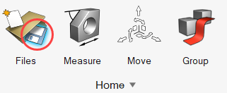

Create a new .hm database in
one of the following ways:
- From the menu bar, click .
- From the Home tools, Files tool group, click the Save As tool.

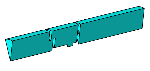

Import and Validate the Geometry
Import the Geometry

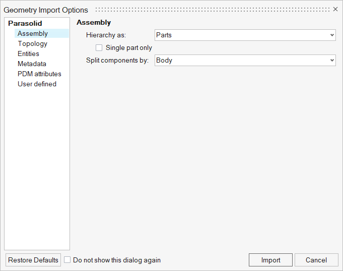

- In the Import File dialog, browse to your working directory then select ACU-T5201_pressureCheckValve.x_t and click Open.
In the Geometry Import Options dialog, leave all the
default options unchanged then click Import.
Figure 4.
Figure 5.

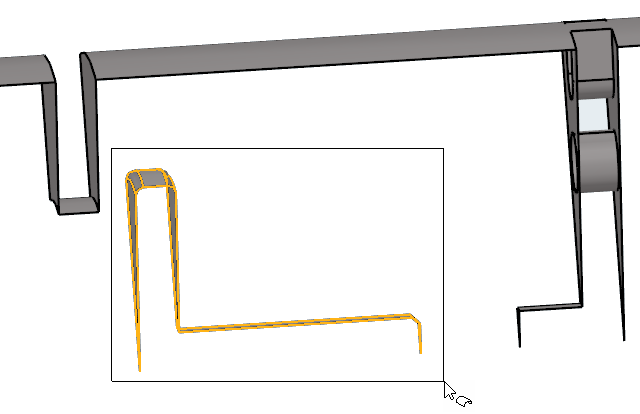

From the Geometry ribbon, click the Validate tool.
Figure 6.
The Validate tool scans through the entire model, performs checks on the surfaces and solids, and flags any defects in the geometry, such as free edges, closed shells, intersections, duplicates, and slivers.The current model does not have any of the issues mentioned above. Alternatively, if any issues are found, they are indicated by the number in the brackets adjacent to the tool name.
Observe that a blue check mark appears on the top-left corner of the Validate icon. This indicates that the tool found no issues with the geometry model.Figure 7.
- Press Esc or right-click in the modeling window and swipe the cursor over the green check mark from right to left.

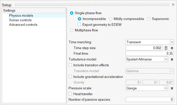

Under the Physics models setting:
- Set Time marching to Transient.
- Set the Time step size to 0.002 and the Final time to 0.35.
- Select Spalart-Allmaras as the Turbulence model.
Figure 9.

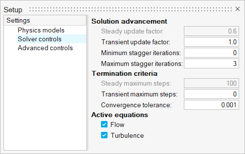

Click the Solver controls setting and set the Maximum
stagger iterations to 3.
Figure 10.

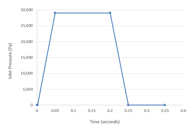

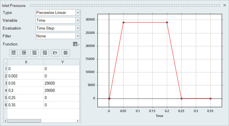

Create a Multiplier Function for the Inlet Pressure
From the Flow ribbon, click the arrow next to the
Setup tool set, then select Multipliers.
Figure 11.
Click
in the
Multiplier Library dialog.
- In the multiplier creation dialog, change the name of the multiplier function to Inlet Pressure by clicking on the top-left corner.
- Set the Type to Piecewise Linear.
- Verify that the Variable is set to Time and Evaluation is set to Time Step.
Click
four
times to add four rows to the bottom of the table.
Enter the table values according to the image below.
Figure 12.

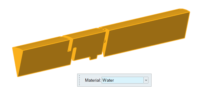

Click anywhere on the pipe geometry.
The entire geometry is highlighted.
Figure 14.
- In the microdialog, select Water from the Material drop-down menu.

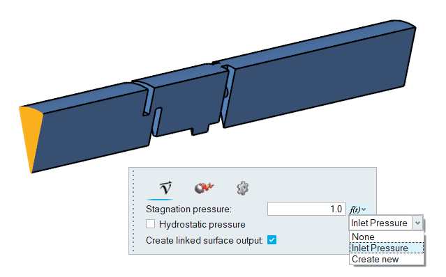

From the Flow ribbon, Pressure
tool group, click the Stagnation Pressure tool.
Figure 15.
- In the modeling window, click on the inlet surface, as shown in Figure 16.
- In the microdialog, enter a value of 1 N/m2 for the Stagnation pressure.
Click the Multiplier function drop-down and select the function
Inlet Pressure from the list.
Figure 16.

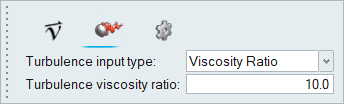

Click the Turbulence icon the microdialog, set the
Turbulence input type to Viscosity Ratio, and the enter a
value of 10 for the Turbulence viscosity ratio.
Figure 17.

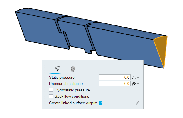

Click the Outlet tool.
Figure 18.
Click the outlet surface shown in the figure below.
Figure 19.
On the guide bar, click
to execute

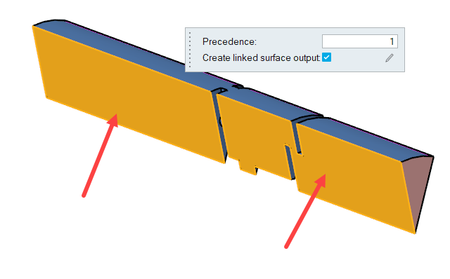

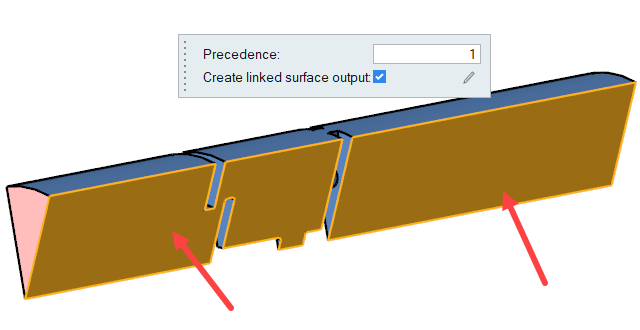

Click the Symmetry tool.
Figure 20.
Select the two surfaces shown in the figure below.
Figure 21.
to execute the command and remain in the
tool.
- In the Boundaries legend, rename Symmetry to Front_symmetry.
Rotate the model and select the other two symmetry faces.

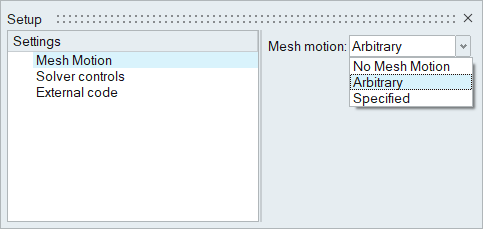

In the Setup dialog, change the Mesh motion to
Arbitrary.
Figure 24.

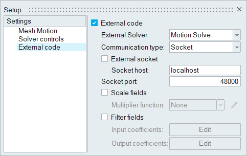

- Click the External code setting and activate the External code option.
- Set the External Solver to MotionSolve and the Communication type to Socket.
- Deactivate the External socket option and set the Socket host to localhost.
Set the Socket port to 48000.
Figure 25.

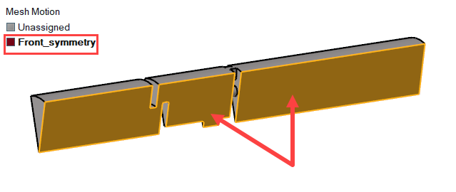

From the Motion ribbon, click the Planar Slip tool.
Figure 26.
- Select the two front symmetry surfaces shown Figure 27.
In the Mesh Motion legend, rename Planar Slip to
Front_symmetry by double-clicking on the name.
Figure 27.

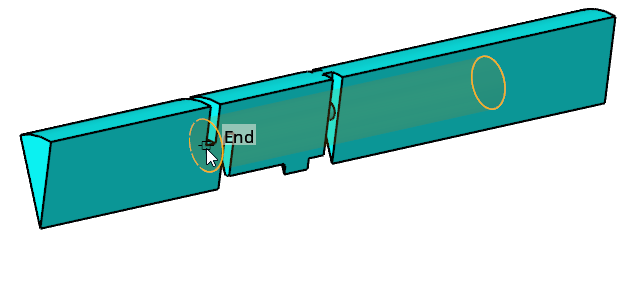

In the modeling window, hover the mouse around the
point shown in the figure below. When the preview cylinder zone is parallel to
the axis of the pipe, click on the model near the point shown below.

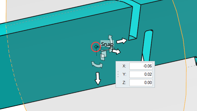

This point will be the center of the front face of the cylinder. In the next few steps you will edit the co-ordinates of this point manually.
Figure 33.
Move the mouse cursor away from the center and then click again.
A preview of the zone should be displayed on the screen along with the manipulator. The manipulator allows you to modify the location and orientation of the zone.
Figure 34.

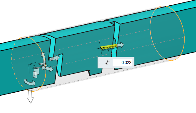

Click the center of the manipulator and enter the following coordinates for the
center (-0.06, 0.02, 0)
Figure 35.
Double-click on the cylindrical surface of the zone and enter
0.022 m as the radius of the cylinder.

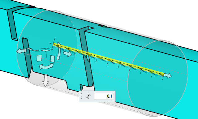

Figure 36.
Double-click on the base of the cylinder and enter 0.1 m
as the height of the cylinder.
Figure 37.

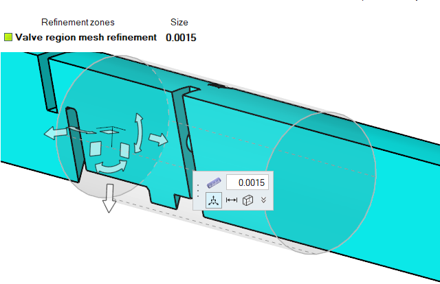

- Click anywhere in the empty space in the modeling window.
- Enter a value of 0.0015 m for the mesh size in the microdialog.
In the Refinement zones legend, rename the zone to Valve region mesh
refinement.
Figure 38.

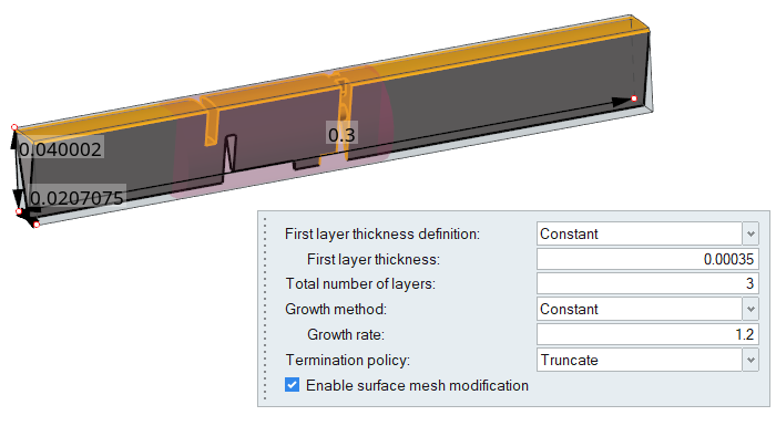

From the Mesh ribbon, click the Boundary Layer tool.
Figure 39.
Right-click in the modeling window and go to .
All the wall surfaces should be highlighted and a dialog for BL specification appears.
Enter the following values in the dialog:
- First layer thickness: 0.00035
- Total number of layers: 3
- Growth method: Constant
- Initial growth rate: 1.2
- Termination policy: Truncate
- Activate Enable surface mesh modification.
Figure 40.

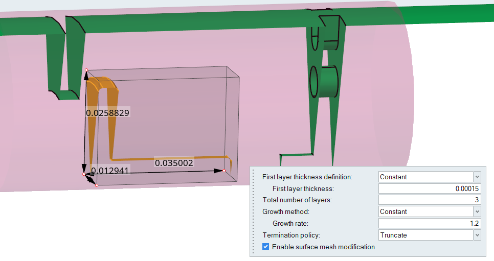

- In the next few steps, you will define the boundary layer mesh control for the valve walls. For convenience, hide the front and back symmetry faces.
- Select the valve wall surfaces using the box selection method.
In the dialog that appears, enter the following values for the BL
specification:
- First layer thickness: 0.00015
Figure 41.

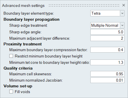

Click the drop-down next to the Mesh Controls tool set and select Advanced.
Figure 42.
In the Advanced mesh settings dialog, change the Boundary
layer element type to Tetra then close the dialog.
Figure 43.

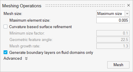

Figure 44.
- In the Meshing Operations dialog, set the Mesh size option to Maximum size and set the Maximum element size to 0.005.
- Deactivate Curvature based surface refinement.
Click Mesh to generate the mesh.
Figure 45.
Once the meshing process has started, the Run Status dialog appears and the application moves to the Solution ribbon.
- Once the meshing is completed, close the Run Status dialog.

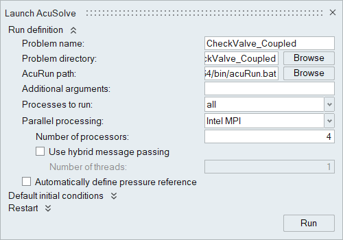

Run AcuSolve
Figure 48.
- Set the Parallel processing option to Intel MPI.
- Deactivate the Automatically define pressure reference option.
Leave the remaining options as default and click
Run to launch AcuSolve.
Figure 49.

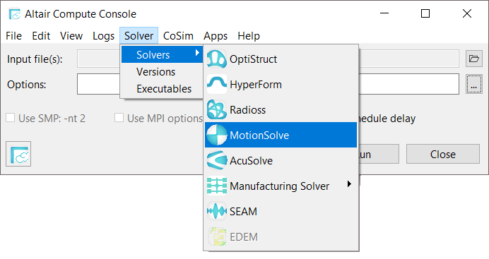

Run MotionSolve

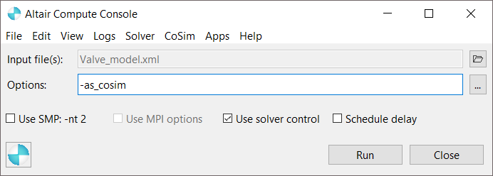

- Run .
Select from the menu bar.
Figure 50.
Click
besides the Input file(s) field, browse to the
location where you saved Valve_model.xml, and open it
For Options, type -as_cosim to indicate coupling between
MotionSolve and AcuSolve.
Figure 51.
- Click Run to start MotionSolve.

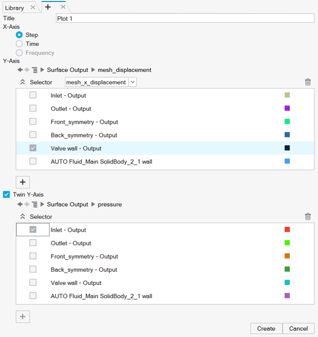

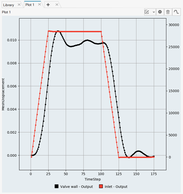

From the Solution ribbon, click the Plot tool.
Figure 52.
Click
next to the Library tab.
Keep the X-axis set to Step. For the Y-axis, click the
tree browser
and select
mesh_displacement under Surface Output.
mesh_x_displacement is selected by default for the coordinate direction. - Check the box for Valve wall - Output under Selector.
- Check the box for Twin Y-Axis.
- Click the tree browser for the second Y-axis and select pressure under Surface Output.
Check the box for Inlet - Output under Selector.
Figure 53.
Click Create.
Figure 54.
Note: The valve motion lags behind the pressure changes at the inlet. Note also the spike around the 37th time step. This represents the collision of the valve stem with the stop and the subsequent rebound of the valve.

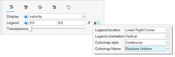

- In the display properties microdialog, set the display to velocity.
- Activate the Legend toggle and set the max velocity to 6.0.
Click
and set the Colormap Name to Rainbow
Uniform.
Figure 56.

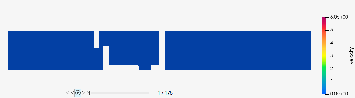

Click
on the guide bar.
Click
at the bottom of the modeling window to view a live animation of the flow.
Figure 57.

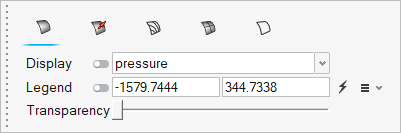

Turn off the Display in the Contour tab of the display
properties microdialog.
Figure 60.

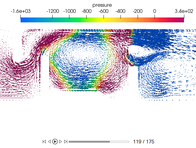

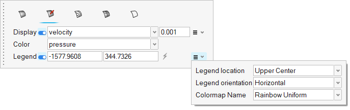

- Click the Vector Display tab.
- Turn the Display on, set the variable to velocity, and the value to 0.001.
- Set the Coloring to pressure.
Activate the Legend toggle and click
to reset the range.
Click
, set the Legend location to Upper
Center, the Legend orientation to
Horizontal, and the Colormap Name to
Rainbow Uniform.
Figure 61.
