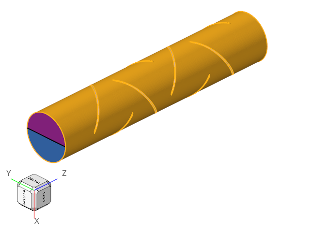

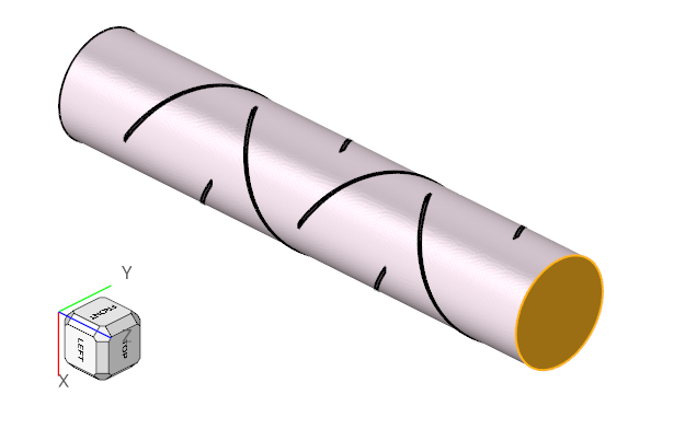

The problem to be addressed in this tutorial is shown schematically in Figure 1. It consists of a mixing tube that contains several swept walls to instigate mixing within the tube. The diameter of the inlet is 0.1 m and the length of the mixing tube is 0.525 m. The fins have a mean diameter of 0.1 m. The maximum thickness of the fins is 0.003 m.
The boundary condition at the inlet is defined to produce a fully developed inlet profile with velocity of 1.0 m/s. One portion of the inlet is defined to contain 100 percent of species_1, while the other inlet is defined to contain 0.0 percent of species_1.
The fluid in this problem is an epoxy resin, which has a density of 1264.0 kg/m3 and a viscosity of 1.49 kg/m-sec.

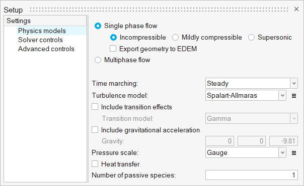

The Setup dialog opens. -
Under the Physics models setting:
- Verify that the Time marching is set to Steady.
- Select Spalart-Allmaras as the Turbulence model.
- Set the Number of passive species to 1.
Figure 5.

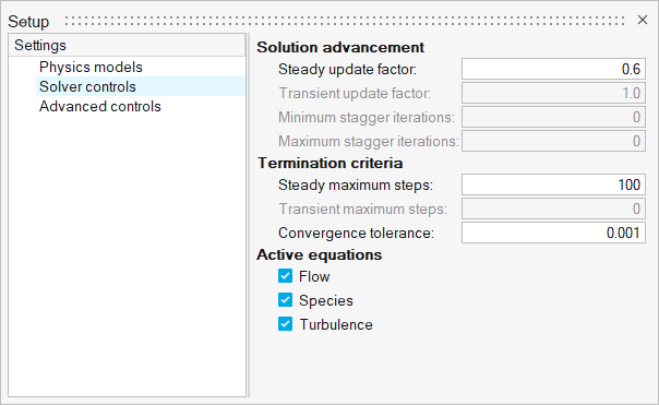

Click the Solver controls setting and verify that the
parameters are set as shown in the figure below.
Figure 6.
- Close the dialog and save the model.

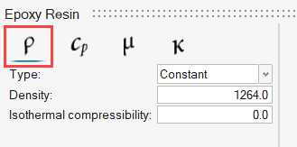

In the Density tab:
- Set the Type to Constant.
- Set the Density value to 1264 kg/m3.
- Set the Isothermal compressibility value to 0

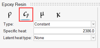

Click the Specific Heat tab and set the Specific heat
value to 2386 J/kg-K.
Figure 9.

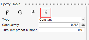

Click the Conductivity tab and set the Conductivity
value to 0.286 W/m-K and Turbulent Prandtl number to
0.91.
Figure 11.

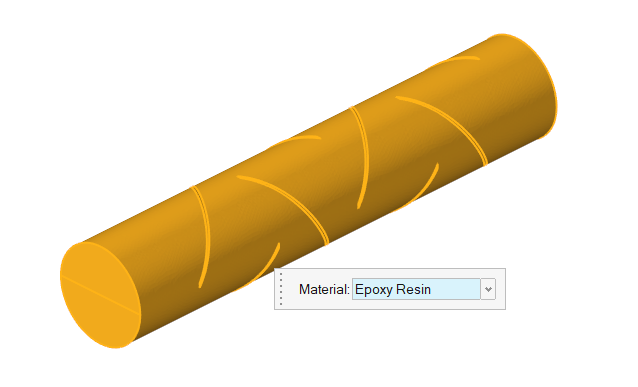

Select the solid model then select Epoxy_Resin as the
fluid medium.

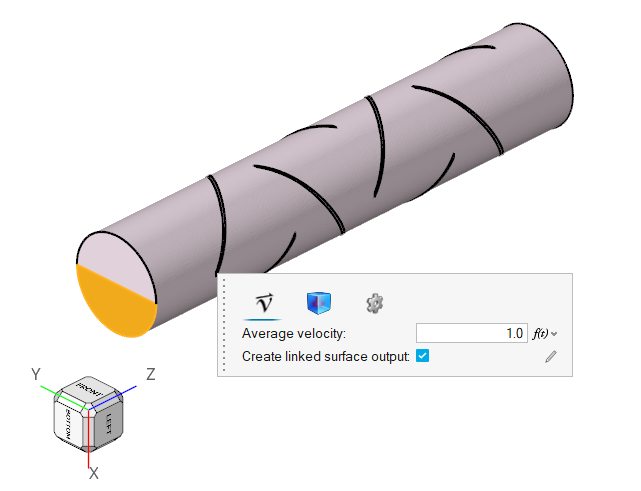

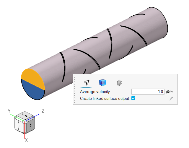

In the modeling window, click the inlet surface
highlighted in the figure below.
Figure 15.
- In the microdialog, set the Average velocity to 1.0 m/s.
Click the Species tab and enter a value of
1.0 for Species 1.
Figure 16.
On the guide bar, click
to execute the command and remain in the
tool.

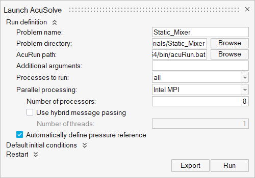

The Launch AcuSolve dialog opens. - Make sure the problem directory is set to the correct location. If not, use the Browse option to select the correct directory.
- Set the Parallel processing option to Intel MPI.
Leave the remaining default options and then click Run
to launch AcuSolve.
Figure 26.

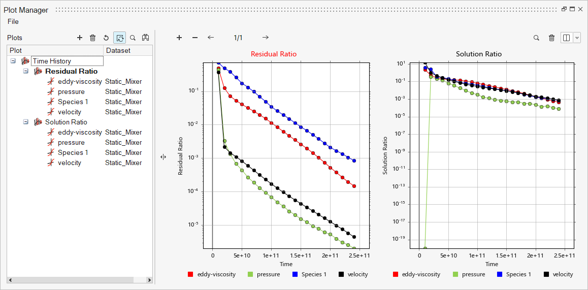

Post-Process With the Plot Tool
From the Solution ribbon, click the Plot tool.
Figure 27.
Observe the residual and solution ratios as the simulation progresses.
Figure 28.

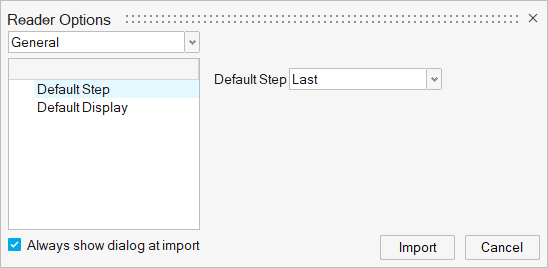

- Open the AcuSolve .log file in your problem directory to load the results for post-processing.
Verify that the default step is set to Last in the
Reader Options dialog and then click
Import.

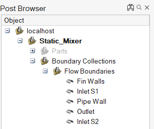

The solid and all the surfaces are loaded in the Post Browser.Figure 31.

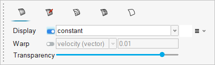

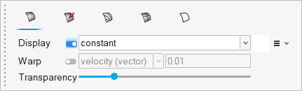

In the Post Browser, right-click Pipe
Wall and select Edit. Set the
transparency to around 80%.
Figure 32.
Similarly, edit the transparency of Fin Walls to around 30% .
Figure 33.

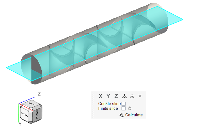

Click the Slice Planes tool.
Figure 34.
Select the x-z plane in the modeling window and then
click Calculate.

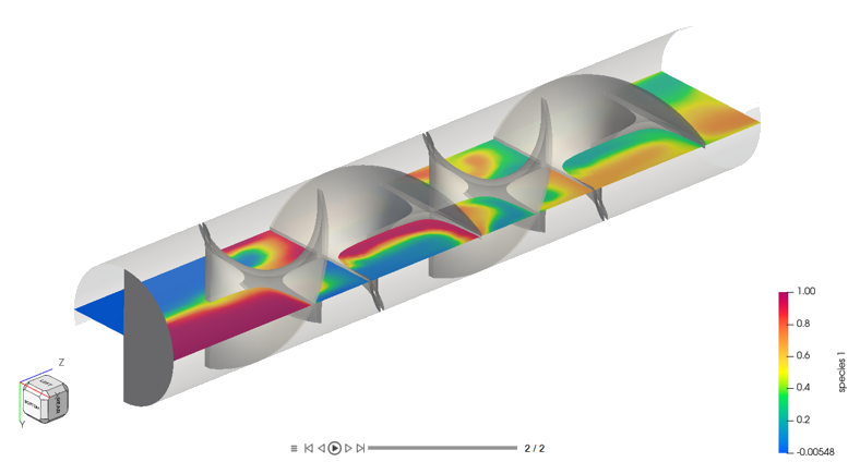

Figure 35.

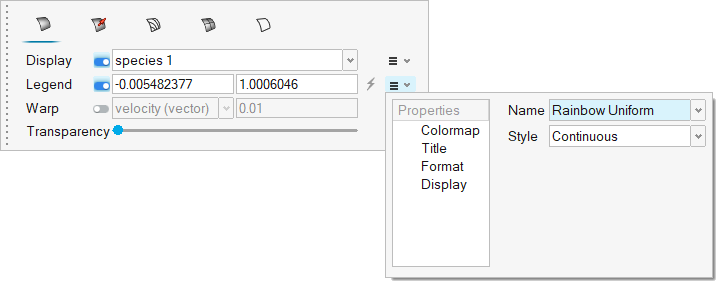

- In the display properties microdialog, set the display to species 1 and activate the Legend toggle.
Click
to reset the legend.
Click
and set the Colormap name to Rainbow
Uniform.
Figure 36.
Click
on the guide bar.
The plot below shows the mixing effectiveness as the maximum value of species 1 is reduced to 0.7 at the outlet, while the minimum value of species 1 is increased to 0.3.Figure 37.

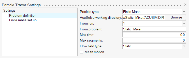

- Click Problem definition and set the Particle type to Finite Mass.
- For the AcuSolve working directory, select the ACUSIM.DIR (flow results) folder in your problem directory.
- Make sure the Flow field type set to Static.
Disable Mesh motion if it not disabled already.
Figure 39.

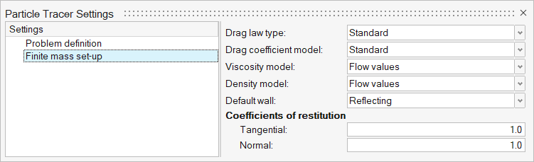

Click Finite mass set-up and leave all the parameters as
shown below.
Figure 40.
- Close the dialog.

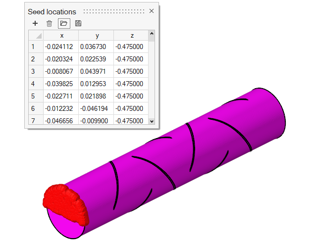

Define Particle Seeds

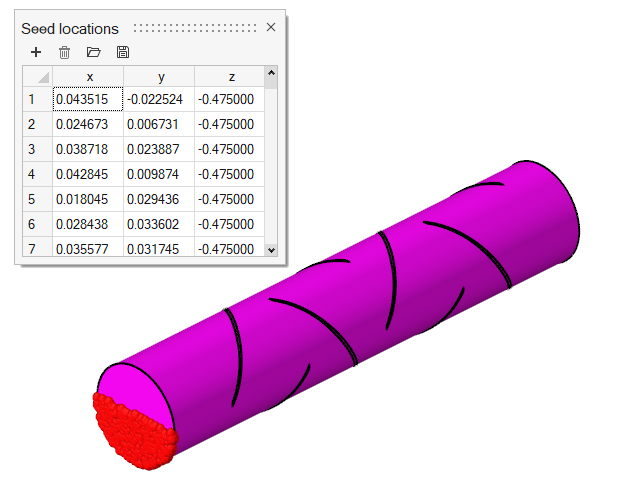

Click the Seeds tool.
Figure 41.
In the Seed location window, click
- Browse to the location where you saved seeds1.csv and seeds2.csv.
Select seeds1.csv file and click
Open.
This accounts for the particles being fed from Inlet S1.
Figure 42.

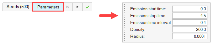

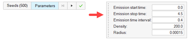

Click Parameters on the guide bar
and enter the following details.
Figure 43.
Click
on the guide bar to execute
the changes.

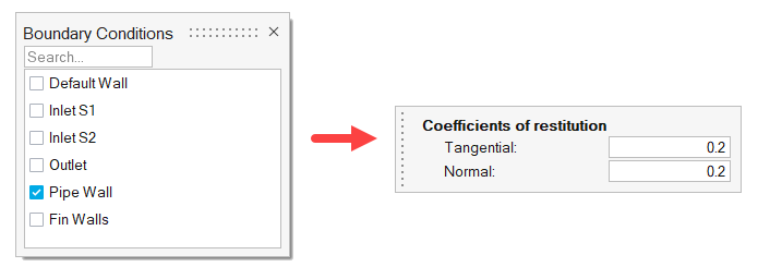

Click the Reflecting tool.
Figure 46.
In the Boundary Conditions window, select the
Pipe Wall and then set the Coefficients of
restitution values to 0.2.

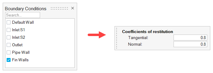

Fin Walls and then set the Coefficients of
restitution values to 0.8.
Figure 48.
Click
the changes.

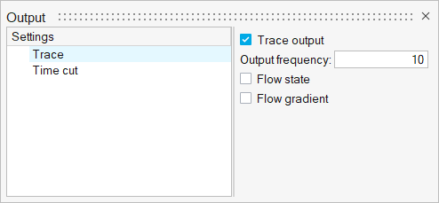

Click the Output tool.
Figure 50.
Check Trace output and enter the values shown
below.
Figure 51.

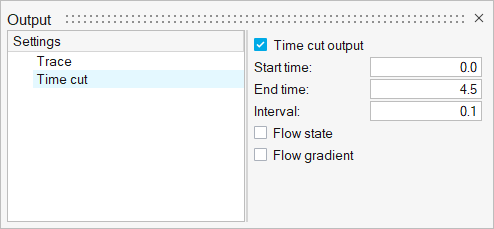

Click the Time cut setting and enter the values shown
below.
Figure 52.
- Close the dialog.

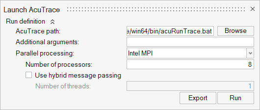

Click the Run tool.
Figure 53.
- Check that acuRunTrace.bat is pointing to the correct path: <installation_directory>\hwcfdsolvers\acusolve\win64\bin\acuRunTrace.bat.
Leave the remaining options as default and click Run to
launch AcuTrace.

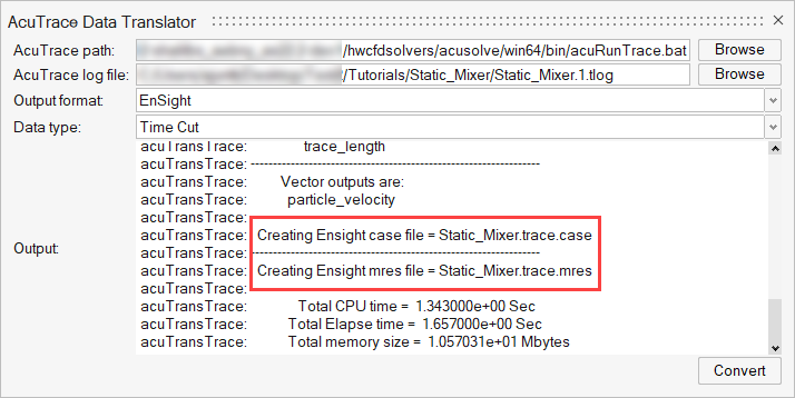

Convert Results for Ensight
Click the Convert tool.
Figure 55.

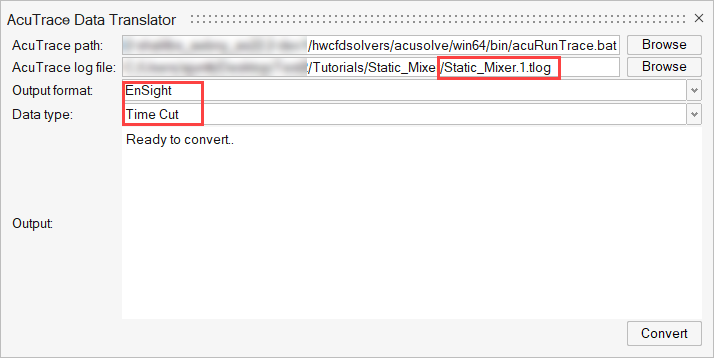

The AcuTrace Data Translator window opens. - Browse to the location where the AcuTrace .log file (*.tlog) is located.
- Set the Output format to Ensight.
Set Data type to Time Cut.
Figure 56.
Click Convert.
Once the conversion is successful, it generates two Ensight result files.
Figure 57.
- Close the dialog.

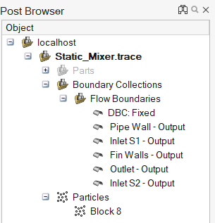

Open the Ensight case file (static_mixer.trace.case) in
Note: A warning opens wherein if some results were previously loaded it will try to remove the results first then load the current results. Click Continue.The solid and all the surfaces along with the Particles are loaded in the Post Browser.
Figure 59.
- In the Post Browser, turn off the display for all surfaces except for Pipe Wall and Fin Walls.
- Set the transparency for Fin Walls to around 30% and the transparency for Pipe Wall to around 80%.

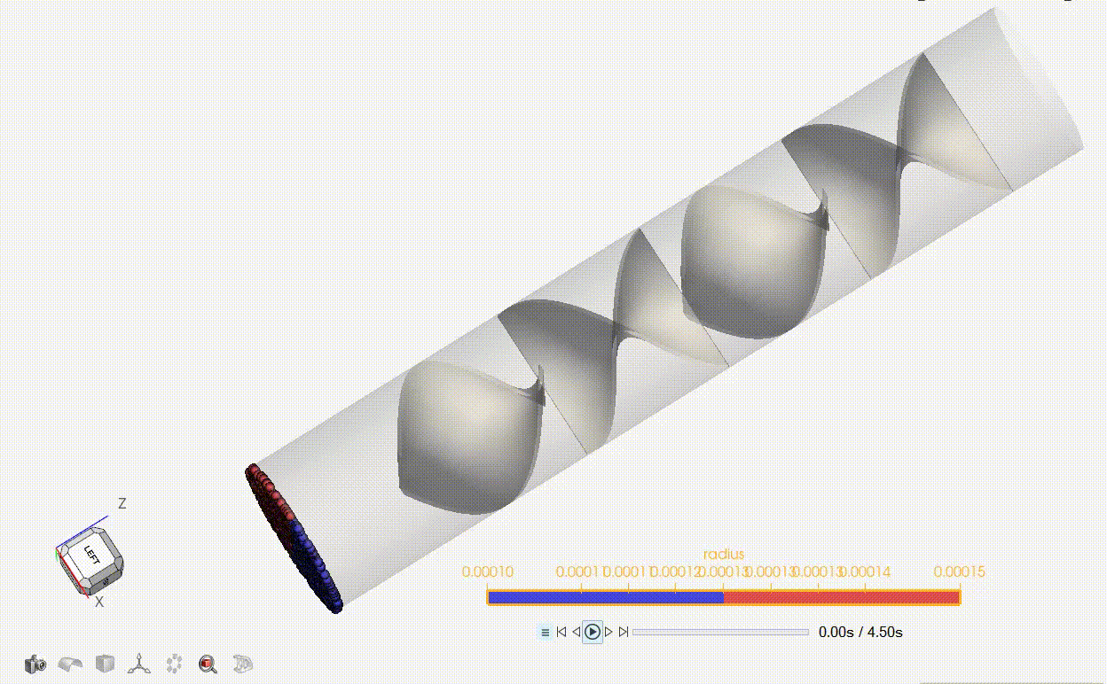

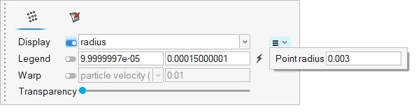

- Right-click Block8 under Particles and select Edit.
Set the display to Radius. Click
and set the point radius to
0.003.
Figure 60.

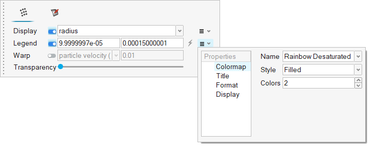

Activate the Legend toggle and click
to refresh the range.
Click
and set the colormap name to Rainbow
Desaturated, the colormap style to
Filled, and the number of colors to
2.
Figure 61.

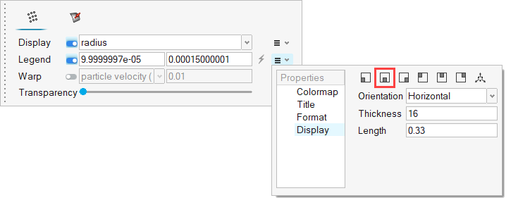

Switch to the Display properties. Set the Orientation to
Horizontal and select the Lower
Center button.
Figure 62.

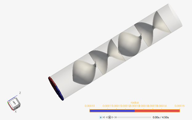

Click the Isometric face on the View Cube to align the
model.
Figure 63.
Rotate the model as shown in below figure such that you can view the particles
movement inside the domain more precisely.
Figure 64.
Click
at the bottom of the modeling window to view a live animation of the flow.
Figure 65.
Save the animation.
