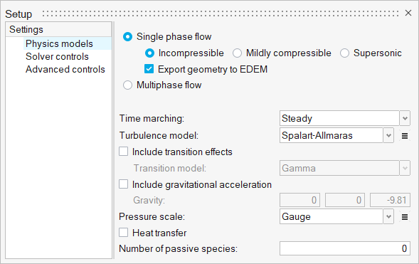

The Setup dialog opens. -
Under the Physics models setting:
- Verify that the Incompressible option is selected under Single phase flow.
- Activate the Export geometry to EDEM check-box.
- Set Time marching to Steady.
- Select Spalart-Allmaras as the Turbulence model.
Figure 6.
- Close the dialog and save the model.

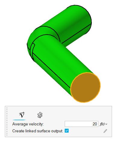

From the Flow ribbon, Profiled
tool group, click the Profiled Inlet tool.
Figure 8.
Click on the inlet face highlighted in the figure below and enter a value of
20 m/s for the Average velocity in the microdialog.

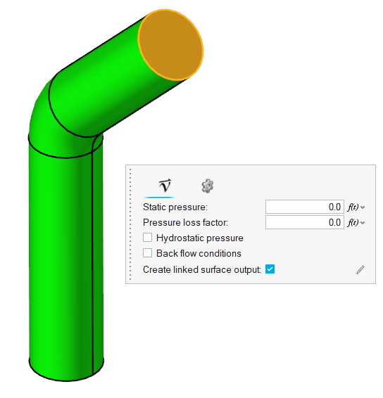

Click the Outlet tool.
Figure 10.
Select the face highlighted in the figure below and then click
on the
guide bar.

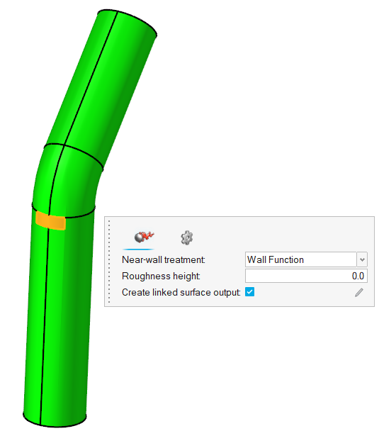

Click the No Slip tool.
Figure 12.
Select the face highlighted in the figure below.
Figure 13.
In the Boundaries legend, double-click Wall and rename
it to Particle_inlet.
You will use this surface as a reference geometry to create a particle factory in EDEM. Hence, you are placing this surface in a different geometry group.

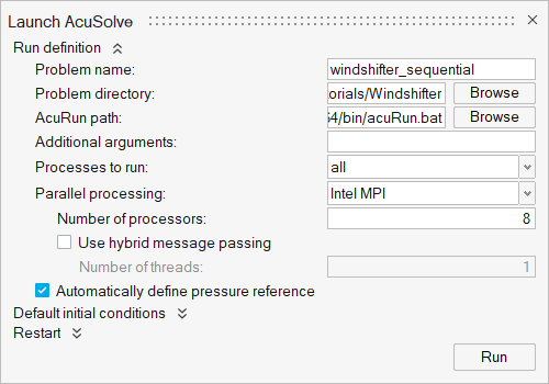

Run AcuSolve
Figure 16.
The Launch AcuSolve dialog opens. - Set the Parallel processing option to Intel MPI.
Click Run to launch AcuSolve.

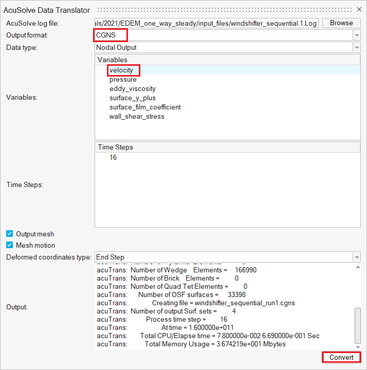

Export Velocity Field Data
From the Solution ribbon, click the
Convert tool.
Figure 18.
The AcuSolve Data Translator dialog opens. - In the dialog, click Browse, navigate to the AcuSolve problem directory, and open the windshifter_sequential.1.Log file.
- Set the Output format to CGNS.
- Select velocity from the list of variables.
Click Convert to export the velocity nodal data in CGNS
format.
Figure 19.
Once the process is successful, the same information is printed in the Output field and a CGNS file is created in the AcuSolve problem directory.

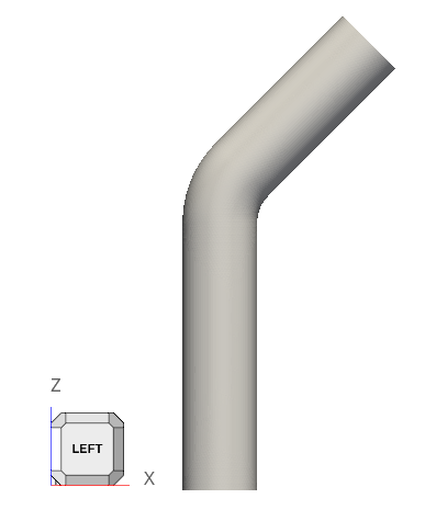

Select the Left face on the view cube to align the model
to the x-z plane.
Figure 20.

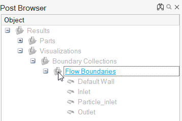

In the Post Browser, turn off the display of the boundary
surfaces by clicking on the icon next to Flow Boundaries.

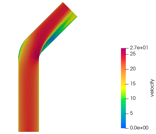

Click the Slice Planes tool.
Figure 22.
- In the modeling window, click on the plane that is parallel to the screen (the x-z plane).
In the slice plane microdialog, click
to
create the slice plane.
- In the display properties microdialog, set the display to velocity and activate the Legend toggle.
Click
and set the Colormap name to Rainbow
Uniform.
Figure 23.
Click
on the guide bar.
Figure 24.

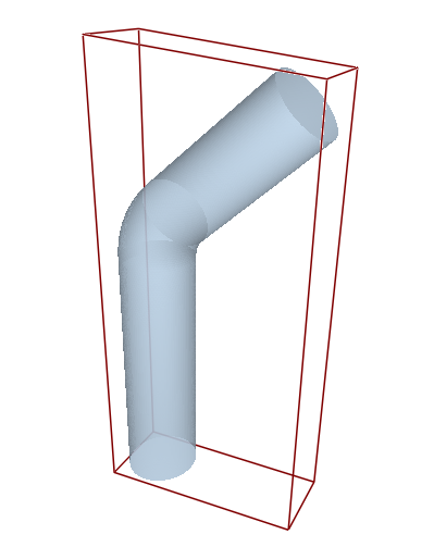

The geometry is loaded.
Click the Environment tab under the Creator Tree,
uncheck Auto Update from Geometry, and then check the box
again to fit the geometry within the boundary.

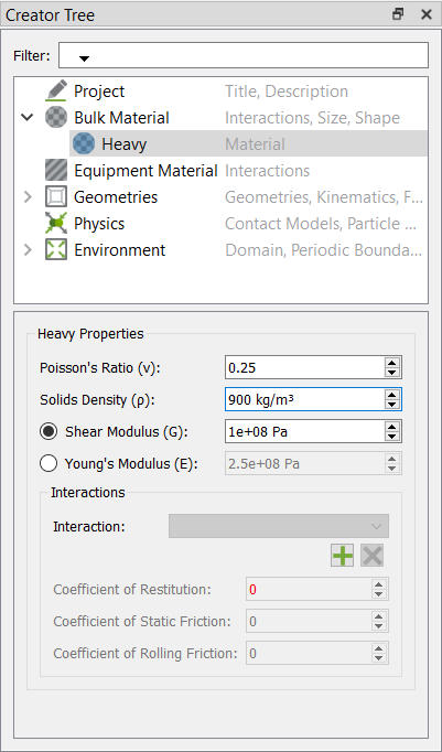

- In the Creator Tree, right-click Bulk Material and select Add Bulk Material.
- Rename the material to Heavy.
In the Creator Tree, set the Solids Density property to
900 kg/m3.
You will use the default values for other properties for this tutorial.

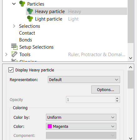

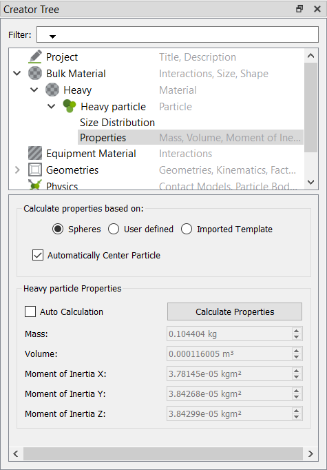

- In the Creator Tree, right click Heavy and select .
- Rename the particle to Heavy particle.

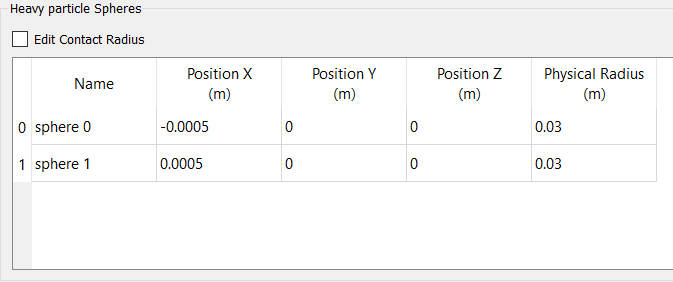

- Under Heavy particle, click Properties.
In the Heavy particle Spheres panel, set the Physical Radius of both the
spheres to 0.03 m and press Enter.
Figure 28.

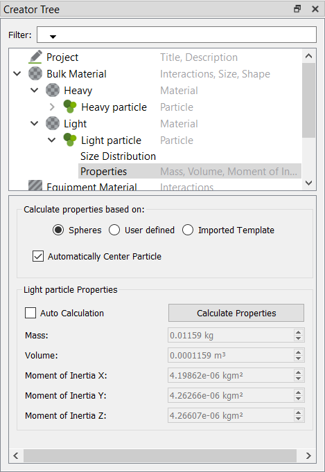

In the Creator Tree, click Calculate Properties.
Figure 29.

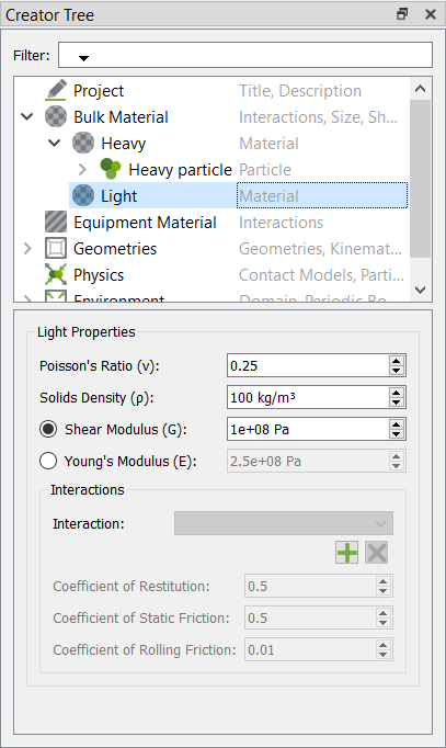

- Rename the material to Light.
100 kg/m3.
Figure 30.

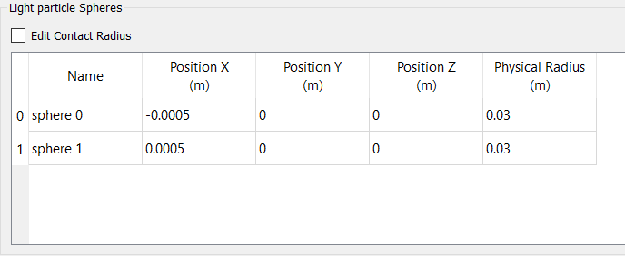

- In the Creator Tree, right click on Light and select .
- Rename the particle to Light particle.
- Under Light particle, click Properties.
In the Light particle Spheres panel, set the Physical Radius of both the
Figure 31.
Figure 32.

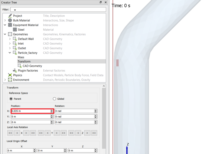

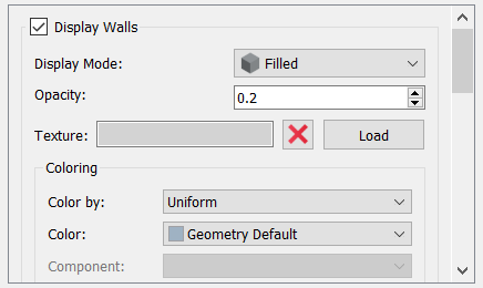

Under Particle_factory, click Transform. Set the
X-Position to 0.035 m
Figure 34.
Note: Set the Opacity value to 0.2 to see the transformed surface location inside the pipe geometry.This is done to make sure that the particles are generated inside the fluid domain.

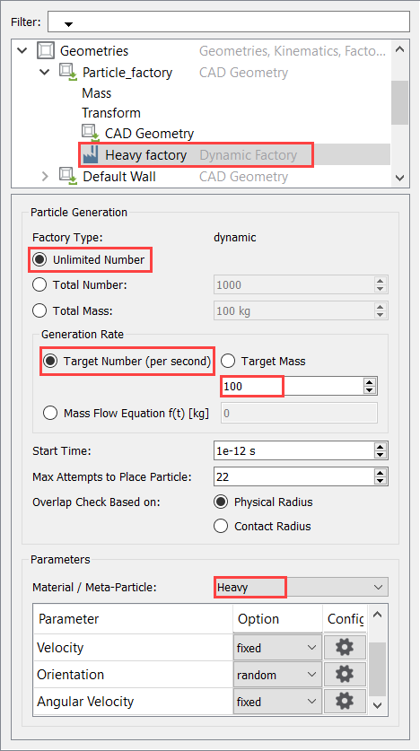

- In the Creator Tree, right-click Particle_factory and select Add Factory.
- Rename the new factory to Heavy factory.
Set the particle generation parameters as shown in the figure below.
Figure 35.
Click
besides Velocity, set the
X-velocity to 1 m/s, and then click OK.

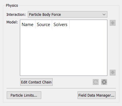

- In the Creator Tree, click Physics.
Click the Interaction drop-down menu and select
Particle Body Force.
Figure 36.
- Click Edit Contact Chain.
- In the dialog, select the Schiller and Naumann Drag model and then click OK.

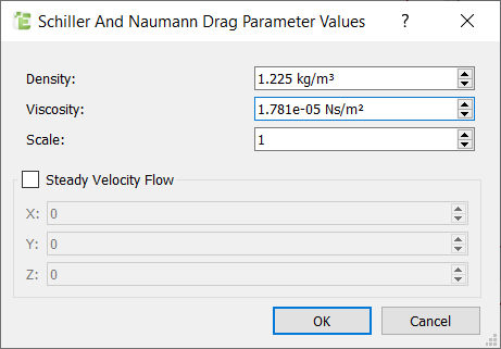

In the Physics tab, click Schiller and Naumann Drag and
then click
In the Schiller and Naumann Drag Parameter Values dialog,
enter the values as shown in the figure below and then click OK.
Figure 37.

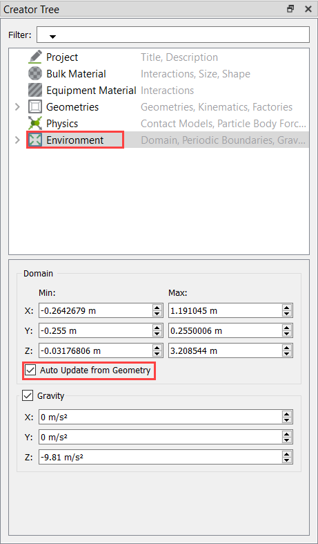

Define the Environment
In this step, you will define the extents of the domain for the EDEM simulation and the direction of gravitational acceleration.
- In the Creator Tree, click Environment.
Activate the checkbox for Auto Update from Geometry (if
not already selected).
When a moving particle touches the bounding faces of the domain (environment), it will be removed from the simulation.
- Activate Gravity and set the z-value to -9.81 m/s2.
- Save the EDEM deck.

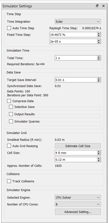

- In the Simulator Settings tab, set the Time Integration scheme to Euler and activate the Auto Time Step checkbox (if not set already).
- Set the Total Time to 1 s and the Target Save Interval to 0.01 s.
Set the Cell Size to 4 R min.
Generally, a value in the range of 3-6 Rmin is recommended as the optimum cell size. The cell size in EDEM doesn’t have any impact on the accuracy of the simulation and affects only the run time.
Set the Selected Engine to CPU Solver and set the Number
of CPU Cores based on availability.
Figure 39.

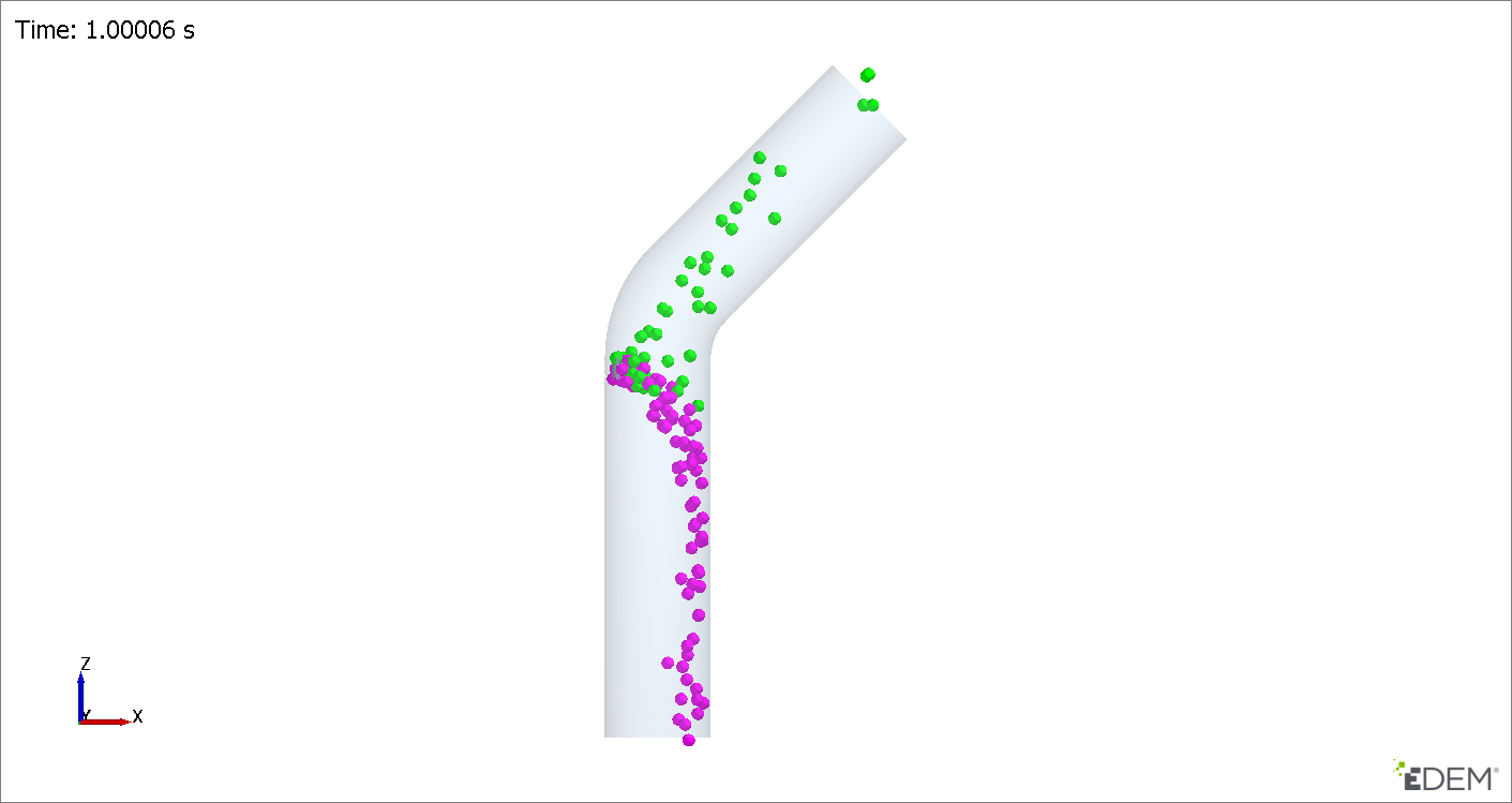

Once the simulation settings have been defined, click
to start the EDEM simulation.
Analyze the Results
Once the EDEM simulation is complete, click

- In the Analyst Tree, expand and then click Default Wall.
Verify that the Display Mode is set to Filled and set
the Opacity to 0.2.
Figure 40.
- In the Analyst Tree, expand Particles and click Heavy particle.
Change the display color to Magenta.
Figure 41.
Click Light particle and set the display color to
Green.
Figure 42.
On the menu bar, set the time to
0 by clicking:
Figure 43.
Set the View plane to + Y.
Figure 44.

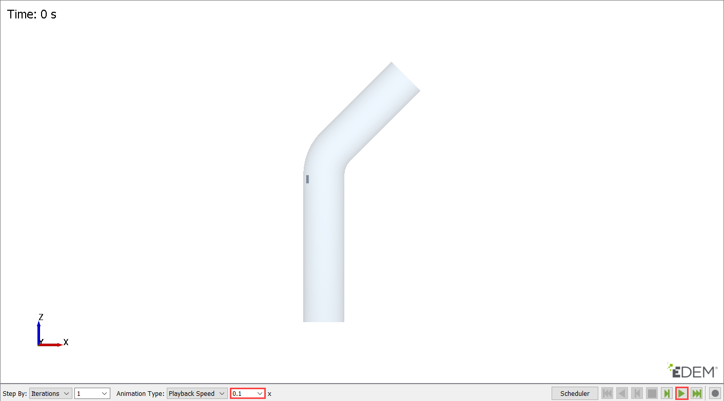

In the Viewer window, set the Playback Speed to 0.1x
then click on the play icon to play the particle flow animation.
Figure 45.
Figure 46.
Observe that the lighter particles (green) get carried by the fluid and escape the domain through the outlet at the top and the heavier particles (magenta) stay inside the domain for a longer time while some of them fall through the bottom of the pipe.
