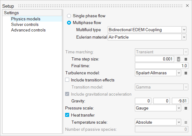

The Setup dialog opens. - Under the Physics models setting, select the Multiphase flow radio button.
- Change the Multifluid type to Bidirectional EDEM Coupling.

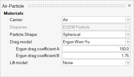

- In the microdialog, click EDEM Bidirectional Material in the top-left corner and change the name to Air-Particle.
- Set the Carrier field to Air (if not set already).
Set the drag model and the drag coefficients as shown in the figure
below.
Figure 6.

- In the Setup dialog, set the Eulerian Material to Air-Particle.
- Set Time step size and Final time to 0.001 and 1, respectively. Select Spalart-Allmaras for the Turbulence model.
- Verify that Gravity is set to 0, 0, -9.81.
Activate the Heat transfer checkbox.
Figure 7.

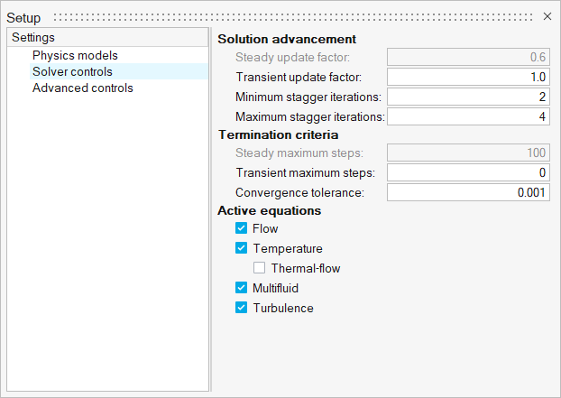

Click the Solver controls setting and set the Minimum
and Maximum stagger iterations to 2 and
4, respectively.
Figure 8.

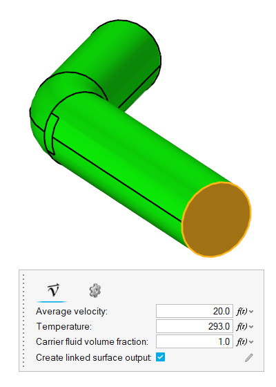

From the Flow ribbon, Profiled
tool group, click the Profiled Inlet tool.
Figure 10.
Click on the inlet face highlighted in the figure below. In the microdialog, enter a value of 20 m/s
for the Average velocity, 293 K for Temperature, and
1.0 for the Carrier fluid volume fraction.

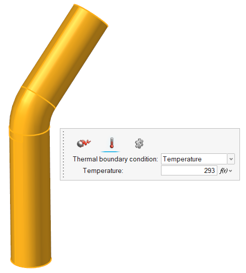

Figure 14.
- Select all the faces except the inlet and outlet faces.
In the microdialog, click the
Temperature tab and set the parameters as shown in
the figure below.
Figure 15.

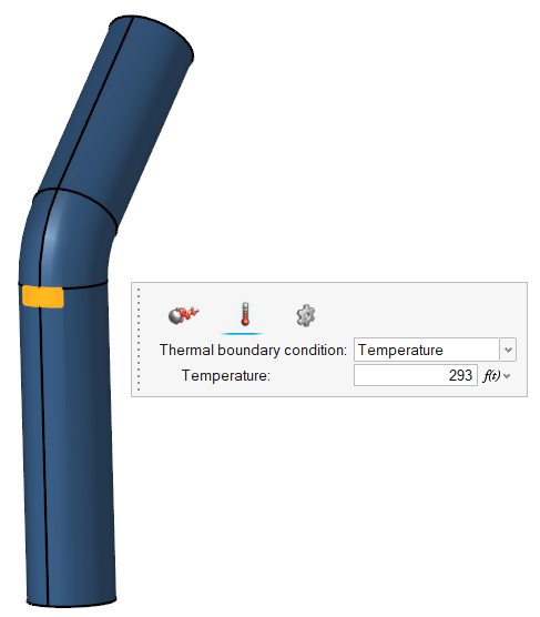

Select the face highlighted in the figure below. In the microdialog, click the Temperature tab
and set the parameters as shown.
Figure 16.

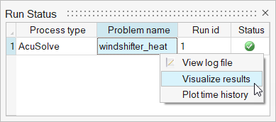

The Run Status dialog opens. Once the run is complete, the status is updated and you can close the dialog.Tip: Right-click on the mesh job and select View log file to view a summary of the meshing process.

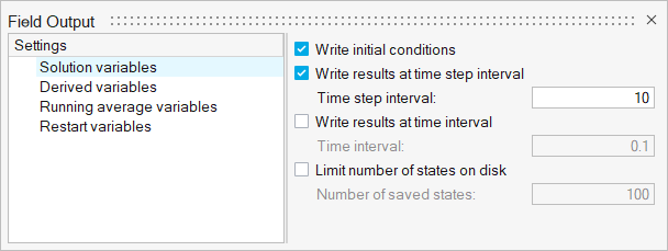

From the Solution ribbon, click the Field tool.
Figure 19.
The Field Output dialog opens. - Check the box for Write Initial Conditions.
Set the Time step interval to 10.
Figure 20.

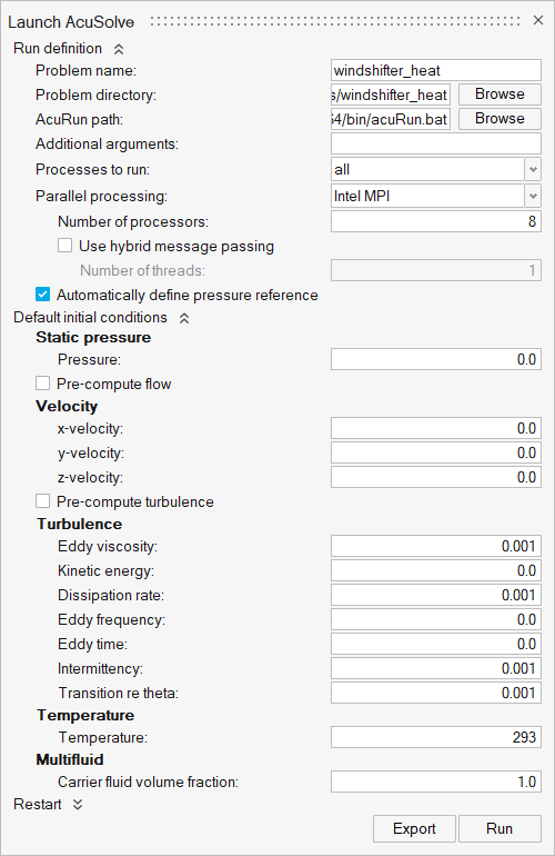

Export the Solver Deck
- From the menu bar, go to .
- Name the file windshifter_heat and make sure that AcuSolve (*.inp) is selected as the file type.
- Click Save.

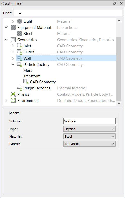

- Right-click on the Wall geometry section in the Creator Tree and select Merge Geometry(s).
- In the Merge Geometry dialog, select the Particle Inlet then click OK.
Click on the Wall geometry section, set the Type to
Physical, and the Material to
Steel (if not set already).
Figure 29.
- In the Creator Tree, click the Inlet section and change the Type to Virtual.
- Similarly, change the Type to Virtual for the Outlet and Particle_factory sections.

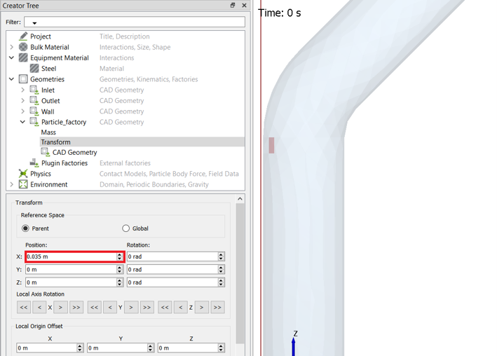

Under Particle_factory, click Transform. Set the
X-Position to 0.035 m
Figure 30.
Note: Set the Opacity value to 0.2 to see the transformed surface location inside the pipe geometry.This is done to make sure that the particles are generated inside the fluid domain.

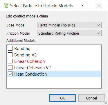

- Set the Interaction drop down to Particle to Particle and click Edit Contact Chain.
In the dialog, activate Heat Conduction and click
OK.
Figure 31.

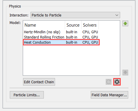

In the Physics tab, click Heat Conduction then click
Figure 32.

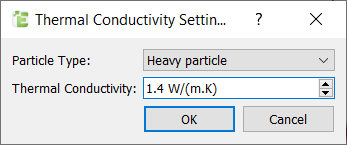

In the dialog, set the Thermal conductivity of both Heavy and Light particles
to 1.4 W/mK then click OK.

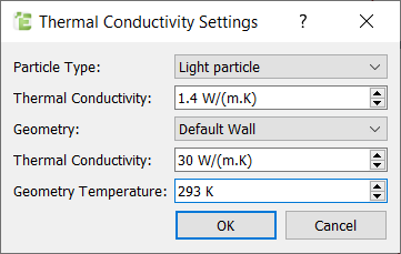

- In the Physics tab, change the Interaction to Particle to Geometry and click Edit Contact Chain.
- In the dialog, activate Heat Conduction and click OK.
In the dialog, set the thermal conductivity of the particles to
1.4 W/mK and the conductivity and temperature of the
wall to 30 W/mK and 293 K,
respectively. Click OK.

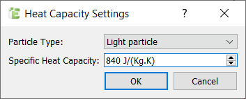

In the Physics tab, click Temperature Update then click
In the dialog, set the specific heat capacity for both the particle types to
840 J/kgK then click OK.
Figure 35.

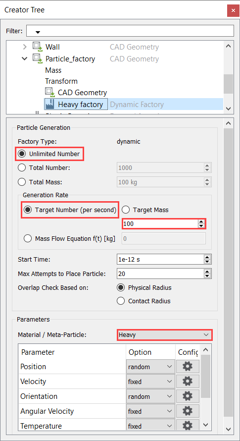

- In the Creator Tree, right-click on Particle_factory and select Add Factory.
- Rename the new factory to Heavy factory.
Set the particle generation parameters as shown in the figure below.
Figure 36.

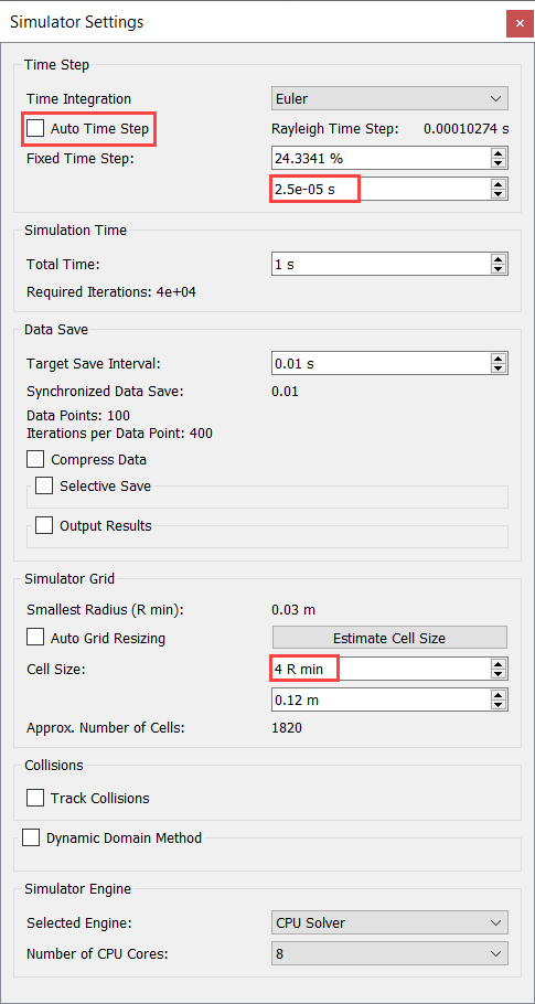

Define the Simulation Settings
Click
in the top-left corner to go to
the EDEM Simulator tab.
- In the Simulator Settings tab, set the Time Integration scheme to Euler and de-activate the Auto Time Step checkbox.
Set the Fixed Time Step to 2.5e-5 s.
Note: Generally, a value of 20-40% of the Rayleigh Time Step is recommended as the time step size to ensure stability of the DEM simulation.
- Set the Total Time to 1 s and the Target Save Interval to 0.01 s.
Set the Cell Size to 4 R min.
Generally, a value in the range of 3-6 Rmin is recommended as the optimum cell size.
Set the Selected Engine to CPU Solver and set the Number
of CPU Cores based on availability.
Figure 37.
- Once the simulation settings have been defined, save the model.

The Launch AcuSolve dialog opens. - Set the Parallel processing option to Intel MPI.
- Expand Default initial conditions, uncheck Pre-compute flow and set the velocity values to 0. Uncheck Pre-compute Turbulence.
- Set the Temperature to 293 K.
Click Run to launch AcuSolve.
Figure 41.

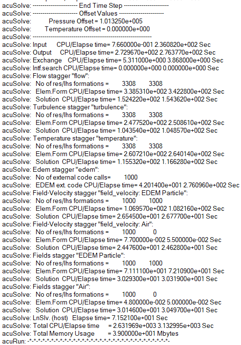

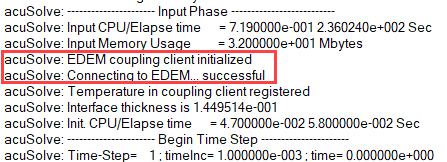

Once the AcuSolve run is launched, the Run Status dialog opens. -
In the dialog, right-click on the AcuSolve run and
select View log file.
If the coupling with EDEM is successful, that information is printed in the log file.
Figure 42.
Once the simulation is complete, the summary of the run time is printed at the end of the log file.Figure 43.

In HyperMesh CFD, right-click on the AcuSolve run in the Run Status
dialog and select Visualize results.
Figure 44.

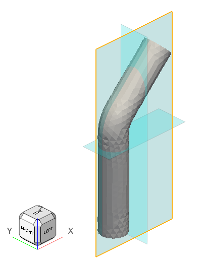

Click the Slice Planes tool.
Figure 45.
Select the x-z plane as highlighted in the figure below.
Figure 46.
In the slice plane microdialog, click
to
create the slice plane.

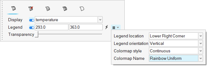

- In the display properties microdialog, set the display to temperature and activate the Legend toggle.
- Change the bounds of the legend to 293 and 363.
Click
and set the Colormap name to Rainbow
Uniform.
Figure 47.

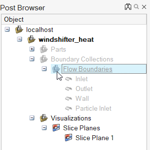

In the Post Browser, turn off the visibility of
Flow Boundaries by clicking on its icon.
Figure 48.

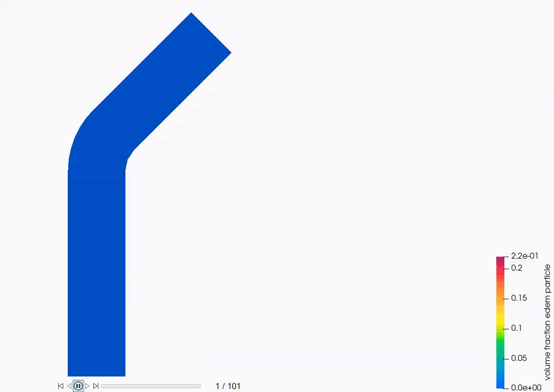

- To plot the volume fraction edem particle variable, right-click on Slice Plane 1 in the Post Browser and select Edit.
- In the display properties microdialog, change the display variable from temperature to volume fraction edem particle and the legend bounds to 0 and 0.2190.
Click
on the guide bar.
Click
to start the animation.
Figure 51.

- In the Analyst Tree, expand and then click Wall.
Verify that the Display Mode is set to Filled and set
the Opacity to 0.2.
Figure 52.

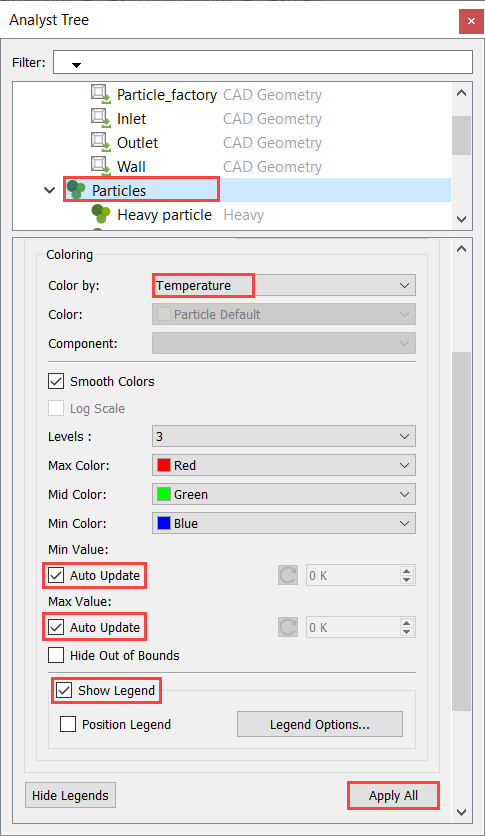

- In the Analyst Tree, click Particles.
- Set the coloring to Temperature.
- Activate the Auto Update checkboxes for both the Min and Max Value.
- Activate the Show Legend checkbox.
Click Apply All.
Figure 53.

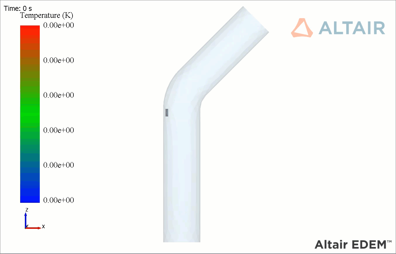

On the menu bar, set the time to
0 by clicking:
Figure 54.
Set the View plane to + Y.
Figure 55.
In the Viewer window, set the Playback Speed to 0.1x and
then click
to play the particle flow animation.
Figure 56.
