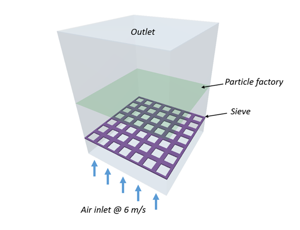

AcuSolve-EDEM bidirectional coupling is used to model the interaction between the fluid and particles. In this tutorial, non-spherical drag force models are used to accurately predict the drag forces on the particles by taking the shape of particles into consideration. The length scale used for factoring in the shape of the particles is the aspect ratio. Bar shaped particles with an aspect ratio of 2.75 and spherical particles with aspect ratio 1 are used for this simulation. The Rong drag model is used in conjunction with the Holzer-Sommerfeld non-spherical drag coefficient model.
| Particle Type | Density (kg/m3) | Size (m) | Number of particles |
| Bar | 200 | 0.022/0.008 (L/D) | 100 |
| Sphere | 1500 | 0.008 (D) | 200 |

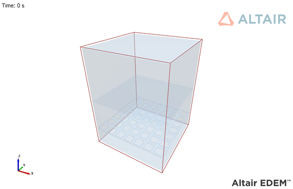

In the dialog, browse to your problem directory and open the
sieve.dem file.
The geometry is loaded.

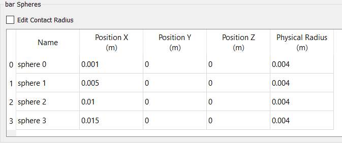

In the bar Spheres panel, set the Physical Radius and the XYZ positions as
shown in the figure below.
Figure 5.

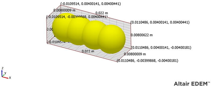

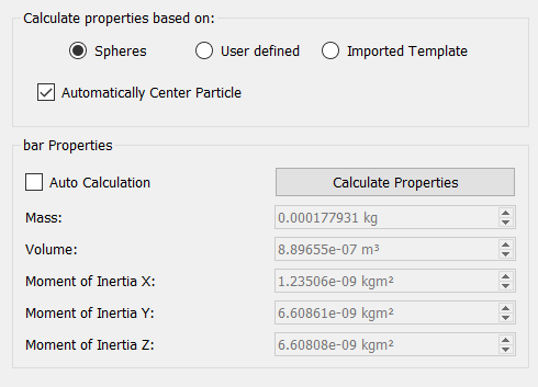

Note: When defining non-spherical shapes, you need to make sure that the principal axis of the particle is aligned with the x-axis, as shown in the figure below. The principal axis definition for some standard shapes is explained later in this tutorial.Figure 6.

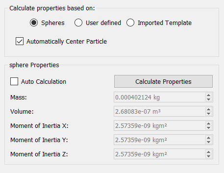

In the Creator Tree, click Calculate Properties.
Figure 7.
Note: Since the "Automatically Center Particle" option is active, EDEM will internally adjust the positions of the spheres in the particle. Although you might see minor changes in the location of the spheres, the overall dimensions of the particle stay the same. - Right-click Bulk Material and select Add Bulk Material.

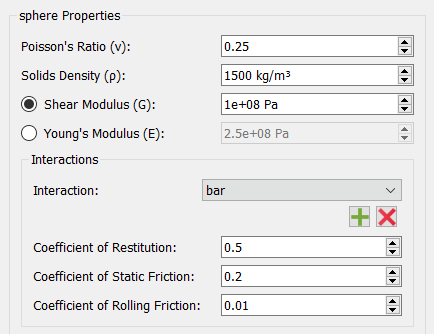

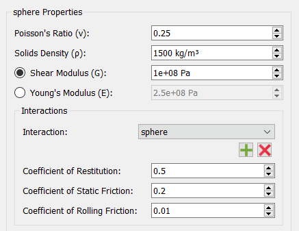

- Rename the material to sphere.
- Set the Solids Density property to 1500 kg/m3.
Click
below Interaction to define the
interaction properties for collisions with sphere particles. In the dialog,
select sphere and then click OK.
Set the interaction coefficients as shown in the figure below.
Figure 8.

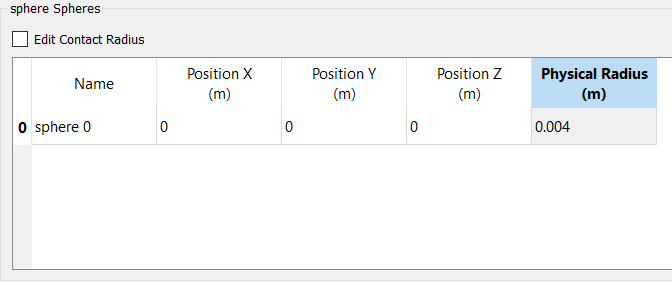

In the sphere Spheres panel, set the Physical Radius of the sphere to
0.004 m and then press Enter.
Figure 10.

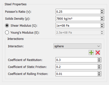

- Right-click Equipment Material and select Add Equipment Material.
- Rename the material to Steel.
- Set the Solids Density property to 7800 kg/m3.
Click
interaction properties for collisions with bar particles. In the dialog, select
bar and then click OK.
Figure 12.
Click
again to define the interaction
properties for collisions with sphere particles. In the dialog, select
Figure 13.

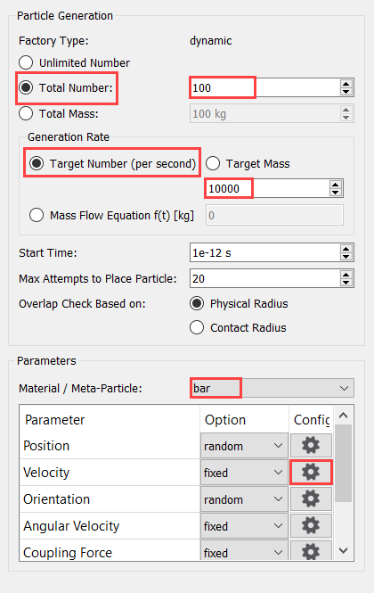

- Right-click factory and select Add Factory. Name it bar factory.
Set the particle generation parameters as shown in the figure below.
Figure 15.
Click
besides Velocity, set the
Z-velocity to -1 m/s, and then click OK.

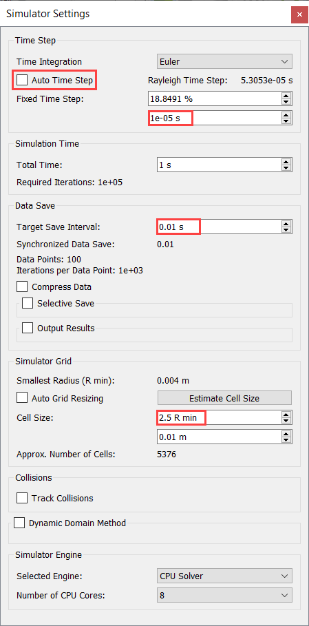

In the Simulator Settings tab, set the Time Integration scheme to
Euler and de-activate the Auto Time
Step checkbox.
Note: The Auto time step should never be used for AS-EDEM bidirectional coupled simulations.
Set the Fixed Time Step to 1e-5 s.
Note: Generally, a value of 20-40% of the Rayleigh Time Step is recommended as the time step size to ensure stability of the DEM simulation. When setting the time step for the DEM model, make sure that the CFD time step is an integer multiple of DEM time step. In this case, the CFD time step is 1e-3, which is 50 times the DEM time step. This ensures that the physical time in both the solvers match at the end of each data exchange interval. Also, the recommended range for the CFD-to-DEM time step ratio is 50-200 for most cases.
- Set the Total Time to 1 s and the Target Save Interval to 0.01 s.
Set the Cell Size to 2.5 R min.
Generally, a value in the range of 2-6 Rmin is recommended as the optimum cell size.
Set the Selected Engine to CPU Solver and set the Number
of CPU Cores based on availability.
Figure 16.

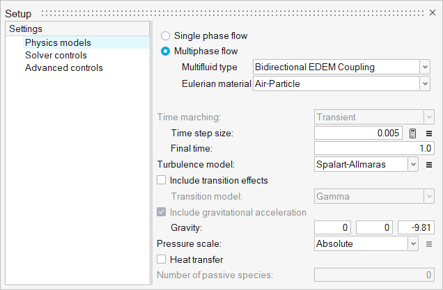

The Setup dialog opens. - Under the Physics models setting, select the Multiphase flow radio button.
- Change the Multifluid type to Bidirectional EDEM Coupling.

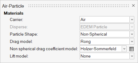

- In the microdialog, click EDEM Bidirectional Material in the top-left corner and change the name to Air-Particle.
- Set the Carrier field to Air (if not set already).
- Set the particle shape to Non-Spherical.
- Set the drag model to Rong.
Set the Non spherical drag coefficient model to
Holzer-Sommerfeld.
Figure 20.

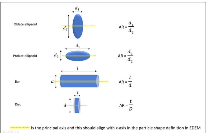

Note: The volumes entered here should be obtained from EDEM under particle properties. There might be slight variation in the volume values that you may see in your EDEM model but that is fine.Here the aspect ratios are calculated based on the ratio of the length to diameter of the particles. The AR of 2.75 and 1 are for bar and sphere-shaped particles respectively. The volume of the particles can be obtained from EDEM under the particle properties. If the simulation has particles of a single shape, then the volume field can be set to zero.
The image below explains the aspect ratio definition for some standard non-spherical particle shapes.Figure 22.

- In the Setup dialog, set the Eulerian Material to Air-Particle.
- Set Time step size and Final time to 0.005 and 1, respectively. Select Spalart-Allmaras for the Turbulence model.
- Verify that Gravity is set to 0, 0, -9.81.

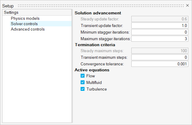

Click the Solver controls setting and set the Maximum
stagger iterations to 3.
Figure 24.

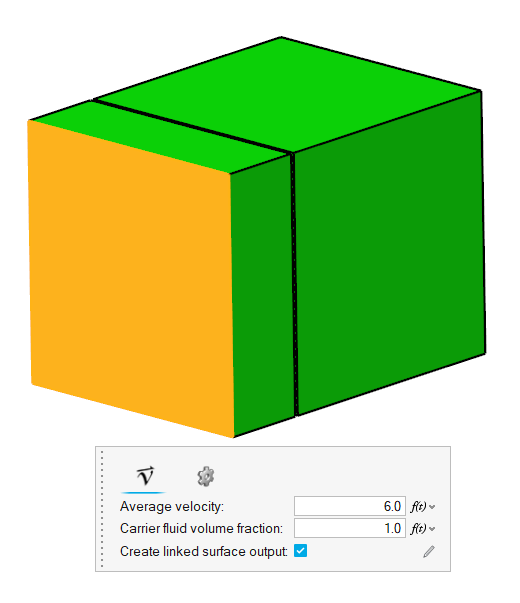

From the Flow ribbon, Profiled
tool group, click the Profiled Inlet tool.
Figure 26.
Click on the inlet face highlighted in the figure below. In the microdialog, enter a value of 6 m/s
for the Average velocity and 1.0 for the Carrier fluid
volume fraction.
Figure 27.

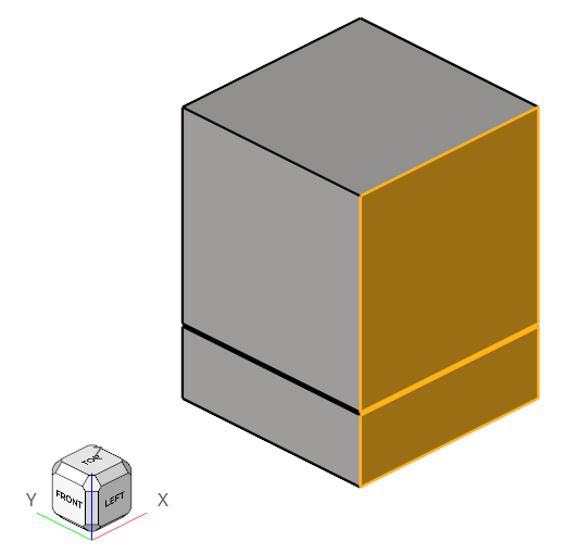

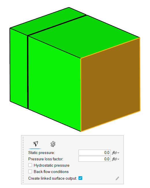

Click the Outlet tool.
Figure 28.
Select the face highlighted in the figure below then click
on the
guide bar.

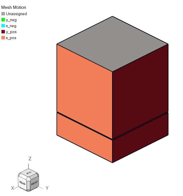

Repeat steps 2-4 to create three more planar slip boundary conditions for the
surfaces with the maximum y-coordinates, and the minimum and maximum
x-coordinates. Name these groups y_pos,
x_neg, and x_pos
respectively.
Once the four planar slip conditions are defined, the Mesh Motion legend should look like the one shown below.

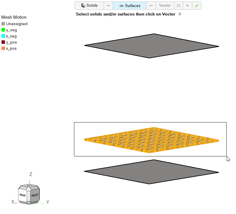

- In the Mesh Motion legend, right-click Unassigned and select Isolate.
- On the guide bar, change the active selector to Surfaces.
Using box selection, select all the sieve surfaces as shown in the figure
below.
Ensure that you are not selecting the inlet or outlet faces.
Figure 35.

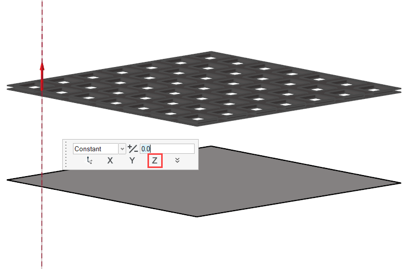

- Click Vector on the guide bar.
- Click anywhere on the sieve surfaces in the modeling window.
In the microdialog, click Z to
align the axis to the global z axis.
Figure 36.

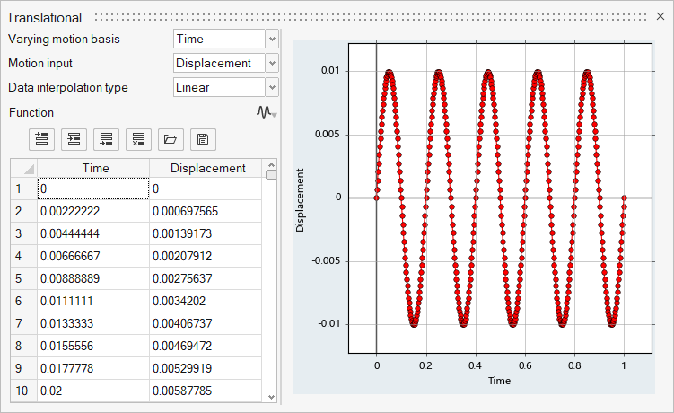

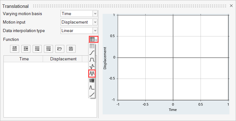

In the microdialog, change the type to
Time-varying and click the plot icon.
Figure 37.

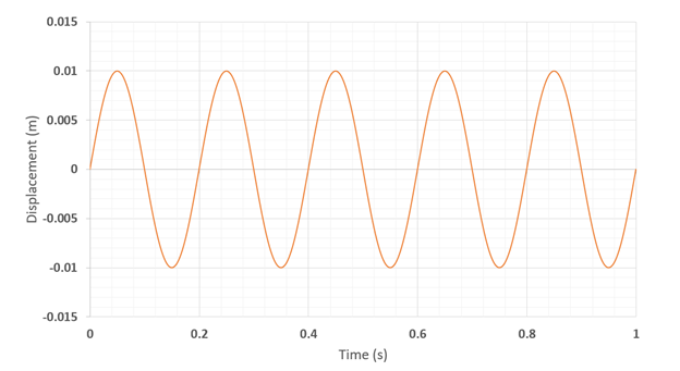

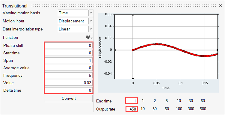

In the new plot dialog, click the drop-down beside the table icon for function
specification and select the oscillating option.
Figure 38.
Enter the values for the sine function as shown in the figure below.
Figure 39.
Click Convert to transform the sine function into an
array for the multiplier function.
The motion profile for the translation motion should look like the one shown below.
Figure 40.

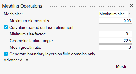

The Meshing Operations dialog opens. -
Set the Mesh size to Maximum size and change the Maximum
element size to 0.03.
Figure 42.
Click Mesh.
The Run Status dialog opens. Once the run is complete, the status is updated and you can close the dialog.Tip: Right-click on the mesh job and select View log file to view a summary of the meshing process.

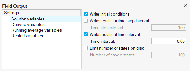

Define Nodal Outputs
Once the meshing is complete, you are automatically taken to the Solution ribbon.
From the Solution ribbon, click the Field tool.
Figure 43.
The Field Output dialog opens. - Check the box for Write Initial Conditions.
- Uncheck the box for Write results at time step interval
- Check the box for Write results at time interval.
Set the Time step interval to 0.05.
Figure 44.

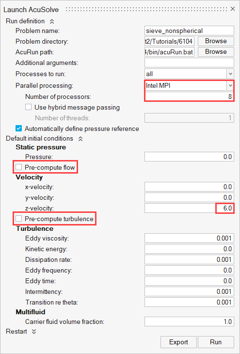

The Launch AcuSolve dialog opens. - Set the Parallel processing option to Intel MPI.
- Expand Default initial conditions, uncheck Pre-compute flow and set the z-velocity value to 6. Uncheck Pre-compute Turbulence.
Click Run to launch AcuSolve.
Figure 48.

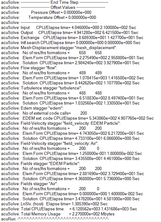

Once the AcuSolve run is launched, the Run Status dialog opens. -
In the dialog, right-click on the AcuSolve run and
select View log file.

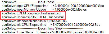

If the coupling with EDEM is successful, that information is printed in the log file.
Figure 49.
Once the simulation is complete, the summary of the run time is printed at the end of the log file.Figure 50.

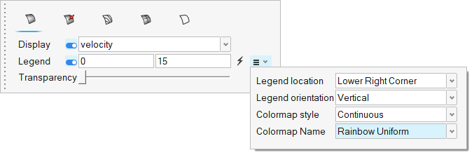

- In the display properties microdialog, set the display to velocity and activate the Legend toggle.
- Change the bounds of the legend to 0 and 15.
Click
and set the Colormap name to Rainbow
Uniform.

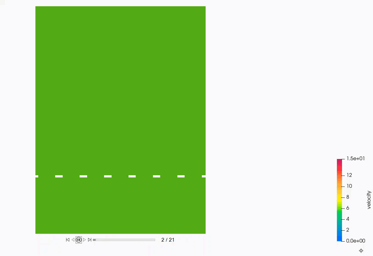

Select the Left face on the view cube to align the model
to the x-z plane.
Figure 56.
Click
on the animation toolbar to view the animation of
the velocity contour.
Figure 57.

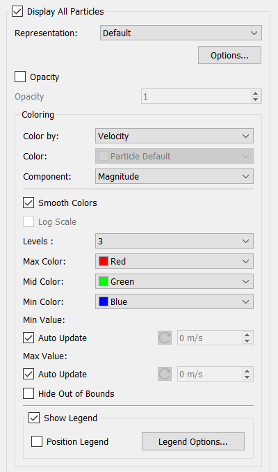

- In the Analyst Tree, click Particles.
- Set the coloring to Velocity.
- Activate the Auto Update checkboxes for both the Min and Max Value.
- Activate the Show Legend checkbox.
Click Apply All.
Figure 59.

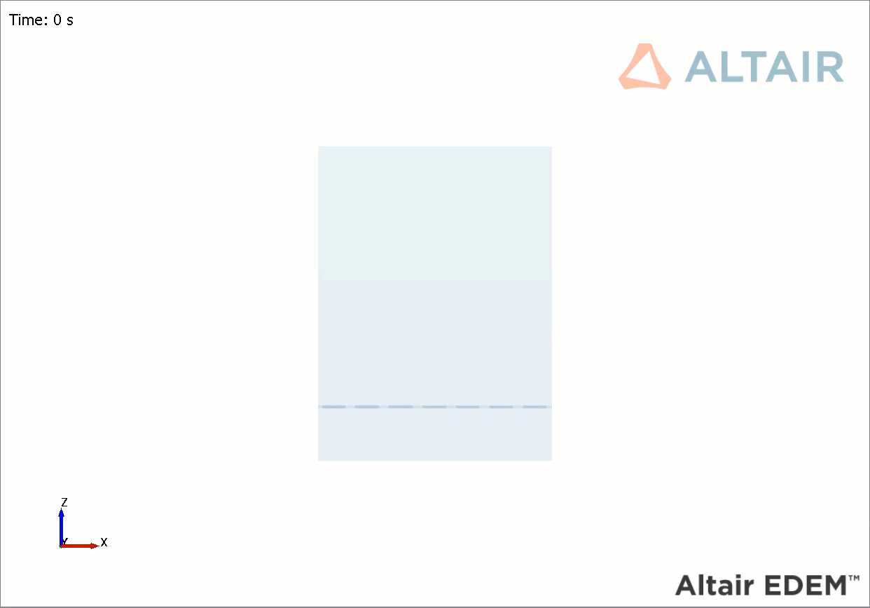

On the menu bar, set the time to
0 by clicking:
Figure 60.
Set the View plane to + Y.
Figure 61.
In the Viewer window, set the Playback Speed to 0.1x and
then click
to play the particle flow animation.
Figure 62.
Observe that the lighter bar shaped particles are blown away by the incoming fluid while the heavier particles fall through the sieve openings.
