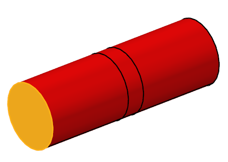

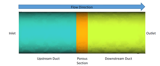

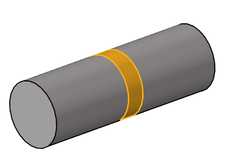

The problem to be addressed in this tutorial is shown schematically in the figure below. It consists of a cylindrical channel with a porous medium in the flow section. As the flow passes through this section, a pressure drop is observed. In this simulation, an inlet velocity will be assigned to the flow and pressure drop across the porous medium will be calculated. The length of the porous section is 0.06 m and the fluid is air with a density of 1.225 kg/m3 and a molecular viscosity of 1.781e-5 kg/m-s. The inlet velocity of the flow is 0.2 m/s.
In AcuSolve, a porous media problem can be solved using one of two methods: the superficial velocity method and physical velocity method. In this tutorial, we adopt the superficial velocity method, which provides good representation of the pressure drop through a porous media. However, it cannot predict the velocity increase in the porous region since the velocity in the porous region remains the same as those outside of the porous zones. The more accurate representation of velocity inside the porous region can be obtained using the physical velocity method, which solves the continuity and momentum equation inside the porous media using the intrinsic averaging method.

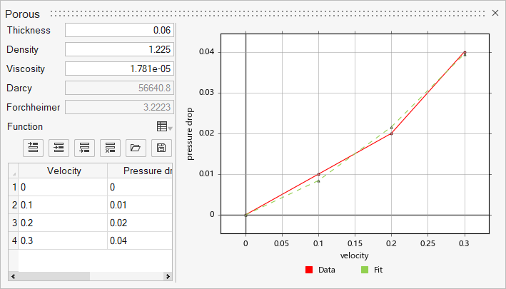

In this tutorial, you will utilize the porous coefficient calculator to calculate the Darcy coefficient and the Forchheimer coefficient after curve fitting of the array data of pressure drop vs velocity. The pressure drop across the porous region can be simplified as the permeability is not included in the curve fitting.
ΔP Δx = C D μ V x + C p ρ V x 2 ∼B V x +A V x 2 MathType@MTEF@5@5@+= feaagKart1ev2aaatCvAUfeBSjuyZL2yd9gzLbvyNv2CaerbuLwBLn hiov2DGi1BTfMBaeXatLxBI9gBaerbd9wDYLwzYbItLDharqqtubsr 4rNCHbGeaGqiVu0Je9sqqrpepC0xbbL8F4rqqrFfpeea0xe9Lq=Jc9 vqaqpepm0xbba9pwe9Q8fs0=yqaqpepae9pg0FirpepeKkFr0xfr=x fr=xb9adbaqaaeGaciGaaiaabeqaamaabaabaaGcbaWaaSaaaeaacq qHuoarcaWGqbaabaGaeuiLdqKaamiEaaaacqGH9aqpcaWGdbWaaSba aSqaaiaadseaaeqaaOGaeqiVd0MaamOvamaaBaaaleaacaWG4baabe aakiabgUcaRiaadoeadaWgaaWcbaGaamiCaaqabaGccqaHbpGCcaWG wbWaa0baaSqaaiaadIhaaeaacaaIYaaaaOGaeSipIOJaamOqaiaadA fadaWgaaWcbaGaamiEaaqabaGccqGHRaWkcaWGbbGaamOvamaaDaaa leaacaWG4baabaGaaGOmaaaaaaa@50FC@
The figure below shows the Darcy and Forchheimer coefficient calculator after providing the velocity (m/s) and pressure drop (Pa) data in addition to the thickness (m) of the porous medium zone, density (kg/m3) and viscosity (kg/m-s) of air.
The Darcy coefficient C D MathType@MTEF@5@5@+= feaagKart1ev2aaatCvAUfeBSjuyZL2yd9gzLbvyNv2CaerbuLwBLn hiov2DGi1BTfMBaeXatLxBI9gBaerbd9wDYLwzYbItLDharqqtubsr 4rNCHbGeaGqiVu0Je9sqqrpepC0xbbL8F4rqqrFfpeea0xe9Lq=Jc9 vqaqpepm0xbba9pwe9Q8fs0=yqaqpepae9pg0FirpepeKkFr0xfr=x fr=xb9adbaqaaeGaciGaaiaabeqaamaabaabaaGcbaGaam4qamaaBa aaleaacaWGebaabeaaaaa@37B3@ and Forchheimer coefficient C p MathType@MTEF@5@5@+= feaagKart1ev2aaatCvAUfeBSjuyZL2yd9gzLbvyNv2CaerbuLwBLn hiov2DGi1BTfMBaeXatLxBI9gBaerbd9wDYLwzYbItLDharqqtubsr 4rNCHbGeaGqiVu0Je9sqqrpepC0xbbL8F4rqqrFfpeea0xe9Lq=Jc9 vqaqpepm0xbba9pwe9Q8fs0=yqaqpepae9pg0FirpepeKkFr0xfr=x fr=xb9adbaqaaeGaciGaaiaabeqaamaabaabaaGcbaGaam4qamaaBa aaleaacaWGWbaabeaaaaa@37DF@ are then calculated based on the curve fit coefficients

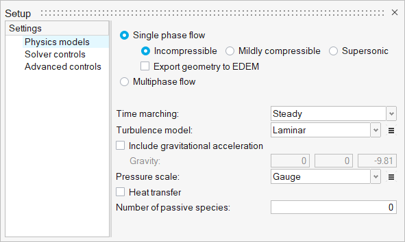

  2. Under the Physics models setting:
    1. Set Time marching to Steady.
    2. Select Laminar as the Turbulence model.

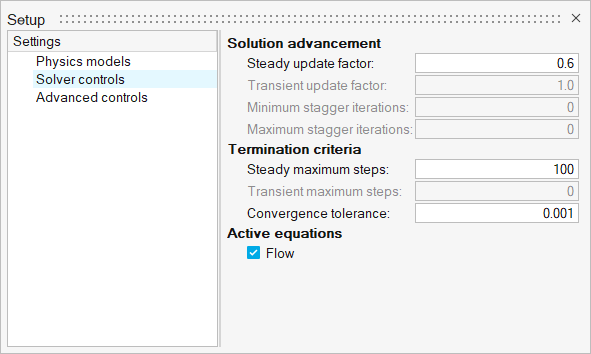

  3. Click the Solver controls setting.
  4. Confirm that the Steady update factor and the Steady maximum steps are set to 0.6 and 100, respectively.

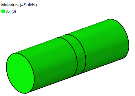

Assign Material Properties
  1. From the Flow ribbon, click the Material tool.
    Figure 8.
  2. Verify that the material Air is assigned to the model's three solids.
    Figure 9.

  5. In the microdialog, click the coefficient calculator and enter the following values for the coefficient calculator.
    • porous zone thickness = 0.06 (m)
    • air density = 1.225 kg/m3
    • air viscosity = 1.781e-05 kg/m-sec
    Figure 12.

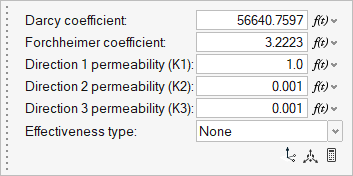

  6. Close the coefficient calculator and confirm the values of the Darcy coefficient and Forchheimer coefficient. Enter permeability values for the three directions as shown in the figure below
    Figure 13.

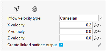

  1. From the Flow ribbon, click the Constant tool.
    Figure 15.
  2. Select the inlet face.
    Figure 16.
  3. In the microdialog, set the velocity parameters as shown below.
    Figure 17.

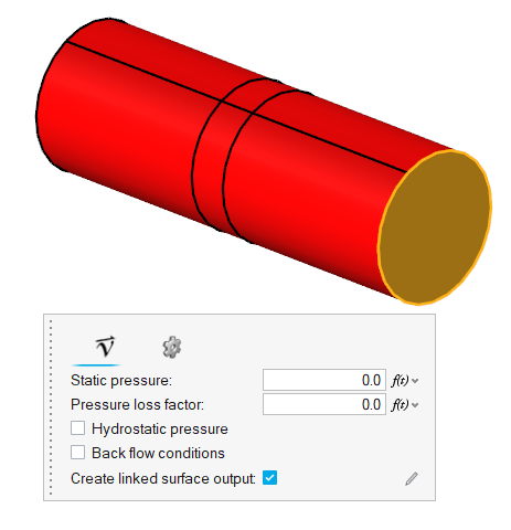

  5. Click the Outlet tool.
    Figure 18.
  6. Select the outlet face.
    Figure 19.
  7. Accept the default parameters then click on the guide bar.

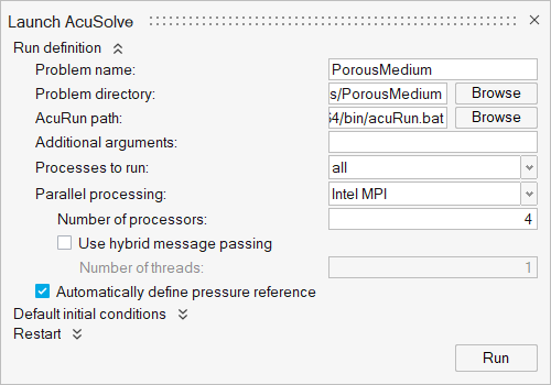

  1. From the Solution ribbon, click the Run tool.
    Figure 22.
  2. Set the Parallel processing option to Intel MPI.
  3. Optional: Set the number of processors to 4 or 8 based on availability.
  4. Leave the remaining options as default and click Run to launch AcuSolve.

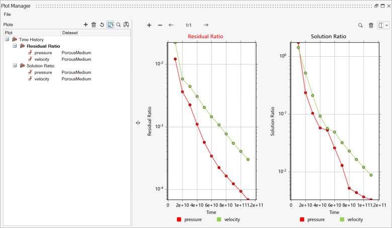

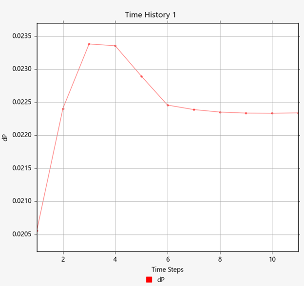

Post-Process with the Plot Tool
  1. In the Run Status dialog, right-click on AcuSolve run and select Plot time history to launch the Plot Manager.
    Figure 24.

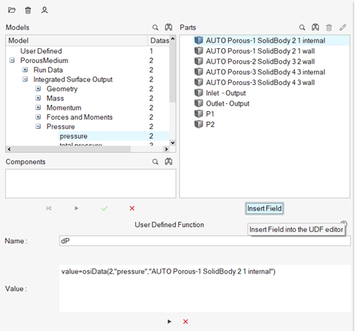

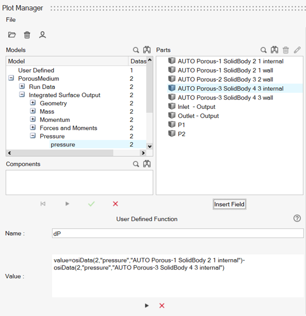

  2. Click to create a new plot.
  3. Click under the Model panel to create a user defined function.
  4. In the Data Tree, expand Integrated Surface Output > Pressure then select pressure.
  5. In the Name field, enter dP.
  6. In the Value field, type value=.
  7. Under Parts, choose AUTO Porous-1 SolidBody_2_1 internal then click Insert Field to insert the field as part of the value, as shown below.
    Figure 25.
  8. Type - at the end of the user defined function value.
  9. Under Parts, choose AUTO Porous-3 SolidBody_4_3 internal then click Insert Field to insert the field as part of the value.
  10. Click to add the user defined function.
    Figure 26.
  11. Click the x axis to switch to Time Steps.
    Figure 27.
    The pressure drop across the porous inlet (AUTO Porous-1 SolidBody_2_1 internal) and porous outlet (AUTO Porous-3 SolidBody_4_3 internal) surfaces is 0.0223 Pa.
