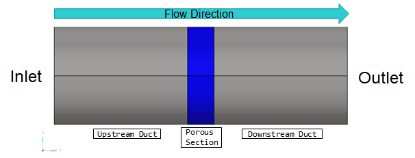

The problem to be addressed in this tutorial is shown schematically in the figure below. It consists of a cylindrical channel with a porous medium in the flow section. As the flow passes through this section, a pressure drop is observed. In this simulation, an inlet velocity will be assigned to the flow and pressure drop across the porous medium will be calculated. The length of the porous section is 0.06 m and the fluid is defined as air fluid with a density of 1.225 kg/m3 and a molecular viscosity of 1.781e-5 kg/m-s. The inlet velocity of the flow is 0.2 m/s.
The porosity is defined as the ratio of the volume of fluid to the total volume. With the superficial velocity approach, the porosity is set to 1 and the flow velocity is calculated as if there is no obstruction to the flow. When using the porous medium with physical velocity, the porosity of the volume is considered when calculating the flow velocity. This allows for a more physical representation of the flow within these components. In this tutorial, you will use a porosity value of 0.5.

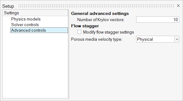

- Click the Advanced controls setting.
Confirm that the Porous media velocity type is set to
Physical.
Figure 7.

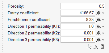

In the microdialog, enter the following values for the
coefficients.
Figure 12.

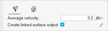

In the microdialog, set the average velocity to
0.2.
Figure 16.

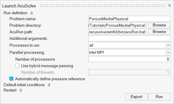

- Set the Parallel processing option to Intel MPI.
Leave the remaining options as default and click
Run to launch AcuSolve.
Figure 22.

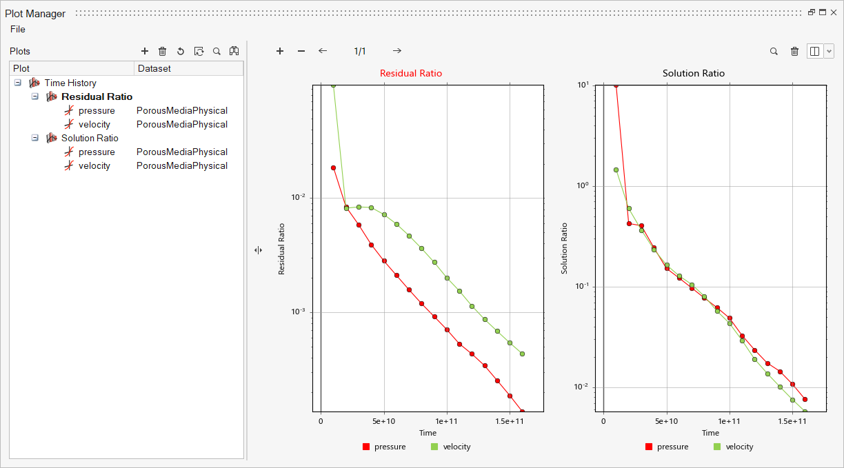

In the Run Status dialog, right-click on AcuSolve run and select Plot time
history to launch the Plot Manager.
Figure 23.

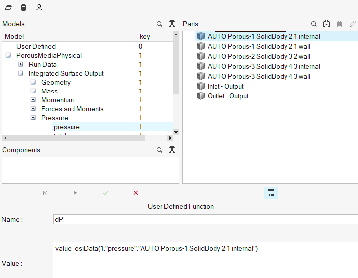

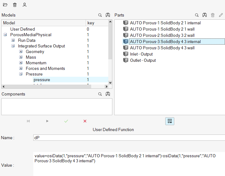

- Right-click User Defined under the Model panel to create a user-defined function.
- In the Data Tree, expand and then select pressure.
- In the Name field, enter dP.
- In the Value field, type value=.
Under Parts, choose AUTO Porous-1 SolidBody_2_1 internal
and then click
to insert the field as part of the value, as shown
below.
Figure 24.
- Type - at the end of the user-defined function value.
Under Parts, choose AUTO Porous-3 SolidBody_4_3 internal
and then click
to insert the field as part of the value.
Click
to add the user-defined function.
Figure 25.

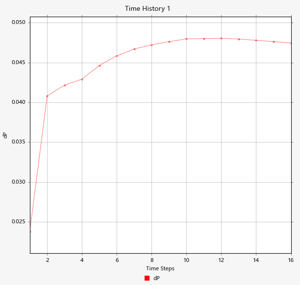

Click the x axis to switch to Time Steps.
Figure 26.
The pressure drop across the porous inlet (AUTO Porous-1 SolidBody_2_1 internal) and porous outlet (AUTO Porous-3 SolidBody_4_3 internal) surfaces is 0.047 Pa.
