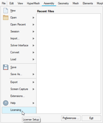

Access Managed Altair Licensing from the License Setup Dialog
  1. Open the License Setup dialog using one of the following options:
    • If you have configured your license, navigate to File > Licensing.
    • If you have not configured your license, the License Setup dialog shown in the next step displays automatically when you start the application.

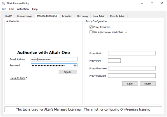

Access Managed Altair Licensing from the Altair License Utility
Tip: If you have HyperWorks, any product of the Inspire Suite, SimLab, or SimSolid installed on your machine, use the method (License Setup dialog) described in the previous section.
  1. Start the Altair License Utility.
    • On Windows, this is located in the start menu under Altair 2025.
      You can also start it directly from:
      <ALTAIR_INSTALL_PATH>\security\bin\win64\gui\almutil_gui.exe (usually C:\Program Files\Altair\2025\security\bin\win64\gui\almutil_gui.exe).
    • On Linux, you can start it directly from:
      <ALTAIR_INSTALL_PATH>/altair/security/bin/linux64/gui (by default /root/2025/altair/security/bin/linux64/gui).
  2. Click the Managed Licensing tab.
  3. In the Authorization section, enter your Altair One credentials (E-mail Address and Password).
  4. Click Sign In.
    Figure 3.
    A message displays that the authorization was successful.
    Figure 4.
  5. Click OK.
  6. Close the Altair License Manager Utility.
