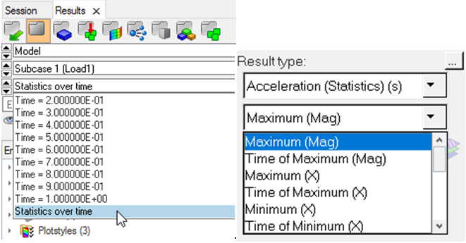

- Acceleration Statistics are
supported for Direct and Modal Linear Transient Analysis types.
Only H3D output is supported for Acceleration Statistics.
The following statistics over time are output for Transient Analysis when STATIS or OSTATIS is specified with Acceleration.- Statistics
- Supported Acceleration Result Types
- Minimum and Time of Minimum
- X-component, Y-component, Z-component
- Maximum and Time of Maximum
- Magnitude, X-component, Y-component, Z-component
- Absolute Maximum and Time of Absolute Maximum
- Arithmetic Mean, Root Mean Square (RMS), Variance, and Standard Deviation
The acceleration statistics can be viewed in HyperView after loading the H3D file, under Statistics over time option at the end of the timestep list in the Results Browser. Then, various statistics can be chosen from the sub-menu under Acceleration (Statistics) (s).Figure 1.
