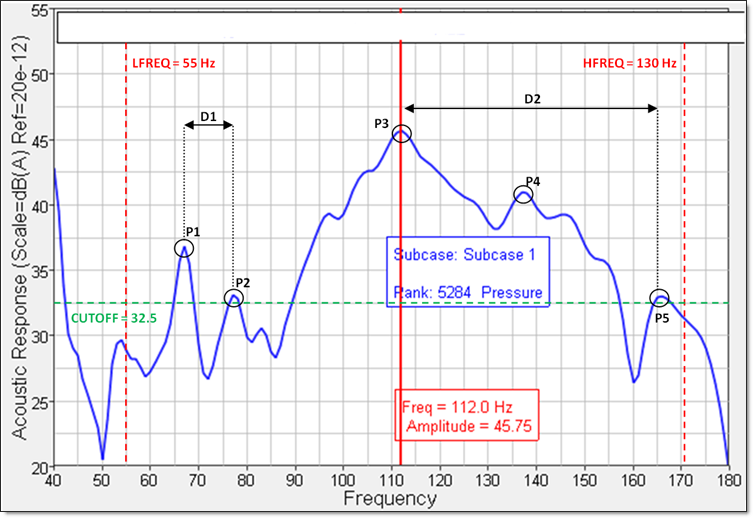

- The following example shows how the
different criteria work in identifying peaks.
Figure 1. Plot of the Acoustic Response versus Frequency
Figure 1 shows a plot of the Acoustic Response versus frequency for a chosen degree-of-freedom. The total frequency range can be reduced to the frequency range of interest by defining LFREQ and HFREQ. The search area can be further reduced by defining CUTOFF such that low magnitude peaks can be ignored. In the remaining region, 5 peaks (P1, P2, P3, P4, and P5) can easily be identified. Should NPEAK be set to 4, the resulting frequency set would consist of the frequencies corresponding to the peaks P4, P2, P1, and P3, with P5 being omitted.
In order to ensure that peaks are neither too far apart nor too close together, the FAR and NEAR criteria, respectively, may be used.
In the above example, should a value of 50HZ be defined for FAR, P4 would be selected in addition to the other peaks because D2 (~54 Hz) is greater than 50Hz, and so an additional peak is required to satisfy the FAR criterion.
Similarly, should a value of 15Hz be defined for NEAR, then P2 will be omitted, as D1 (~11 Hz) is less than 15Hz.
