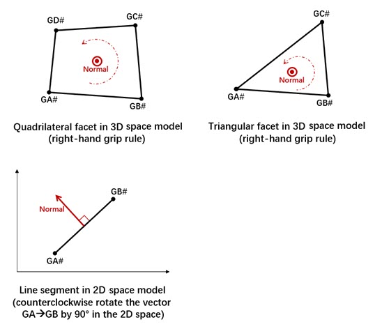

| NORMAL | Identifies the normal direction for a
face of the surface. The normal of a face of a surface may be different from the
normal of the underlying elements.
| FACE | Flag indicating that the surface is composed of 3-noded or 4-noded polygons (facets) for a 3D space model, or, 2-noded line segments (facets) for a 2D space model. | |
| GA#, GB#, GC#, GD# | Grid point identification numbers at the
corners of the facet.
No default (Integer > 0) |

For HEXA Elements Grid point identification number at a corner of the desired face that is diagonally opposite GA. PENTA elements Quad faces: Grid point identification number at a corner of the desired face that is diagonally opposite GA. Tria faces: Leave blank. TETRA elements Grid point identification number at the corner opposite the desired face. PYRA elements Quad faces: Leave blank Tria faces: GA and GB must specify the grids on the edge of the face that borders the quadrilateral face, and the grids must be ordered so that they define an inward normal using the right-hand rule. CQUAXI, CTAXI, CTRIAX6, CQPSTN, and CTPSTN elements GA and GB should specify the corner grids on the line segment. - For the “FACE” format, the normal direction of a
facet is defined as:
