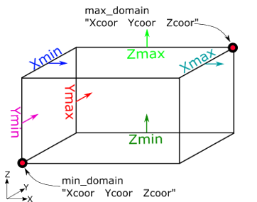

- If both min_domain and max_domain are not specified in the configuration file, the code will automatically detect the minimum and maximum dimensions of the case and create a bounding box automatically. This is useful when operating with closed geometry, such as a gearbox. To simulate a sloshing/splashing case where the fluid is not constrained within solid walls, or if there are periodic or inlet boundary conditions associated with the domain, it is necessary to manually prescribe the size of the domain (bounding box). [ndim, min_domain, max_domain]
- Each of the six bounding planes is
marked in a separate color, with the colored arrow showing the surface
normal of the boundary. The direction of these surface normals in the sketch
has no influence on the code execution, they are provided to help visualize
the domain. The two red dots at the opposite corners of the domain are
minimum and maximum extent of the domain. [BC_min, BC_max]
Figure 1. Sketch of nanoFluidX domain boundaries
