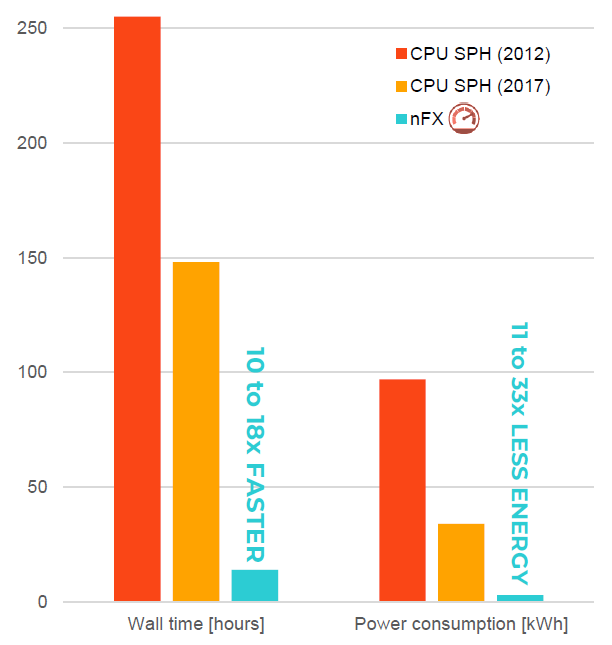

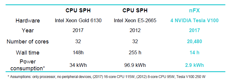

Why GPUs?
- Real DCT gearbox case
- 13.5 million particles
- Extremely complex geometry
- 3000 rpm
- 3.4 seconds of physical time
- Pre processing: 2 days
