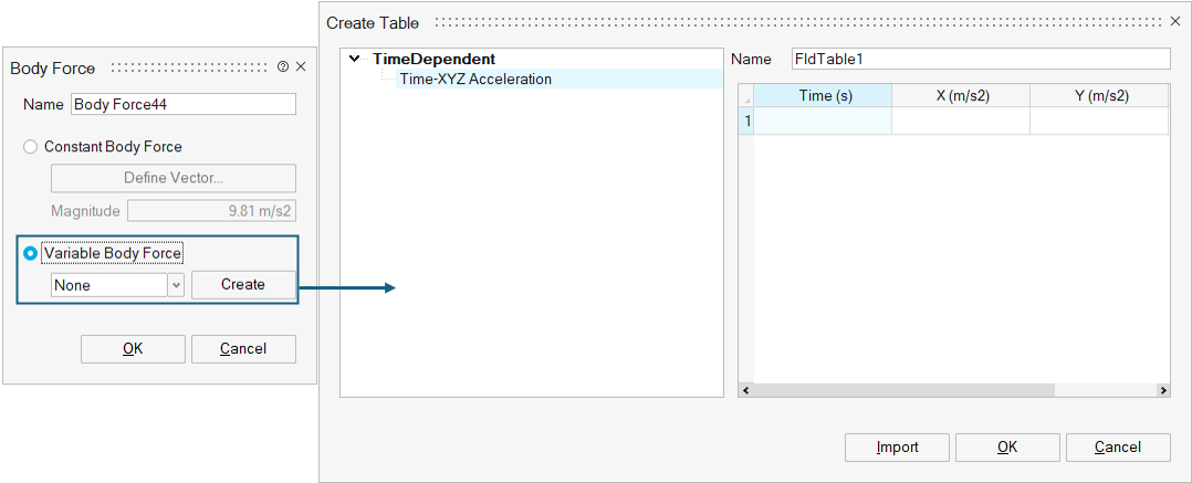

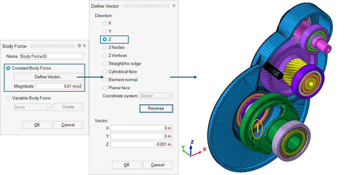

Body Force
Analysis ribbon > Boundary Conditions > Body Force

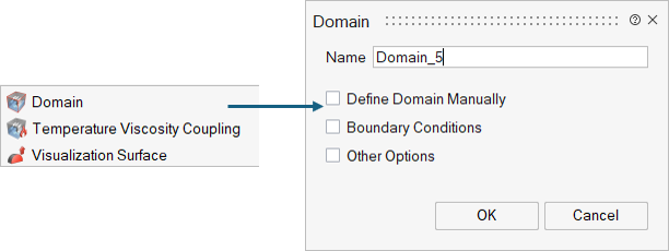

Domain
Analysis ribbon > Boundary Conditions > Domain
- Define Domain Manually
If the simulation has an open boundary, or if there are periodic boundary conditions associated with the domain, it is necessary to manually prescribe the size of the domain (bounding box). In this case the padding around the particles should be set to 3*dx.
- Boundary Conditions
These domain parameters are used to define the boundary conditions at minimum and maximum boundary. Boundary options supported are Periodic and Simple Outlet (default).
- Other Options
A free text box where additional parameters can be specified.

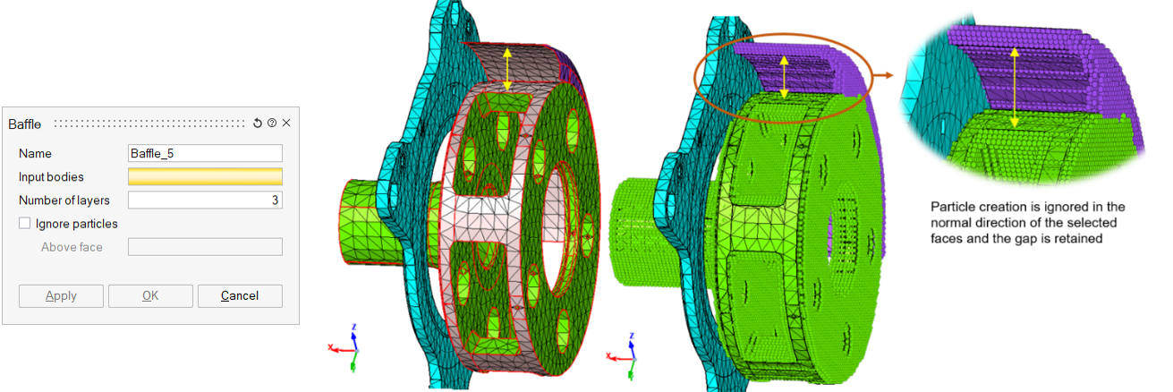

Baffle
Analysis > Boundary conditions > Baffle
