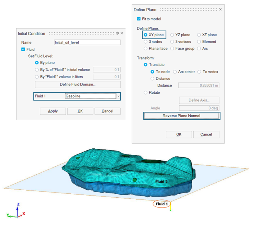

Initial Condition
Analysis > Boundary Conditions > Initial Condition
Initial condition is used to define and create the fluid (liquid and gas) regions inside the container. This is useful when the CAD or FE model does not have a separate body for the fluids. The fluid option will be displayed based on single-phase (one fluid) and multiphase (two fluids) options in the Solution panel.
The fluids can be generated using By plane, By % of "Fluid1" in total volume, or By "Fluid1" volume in liters.

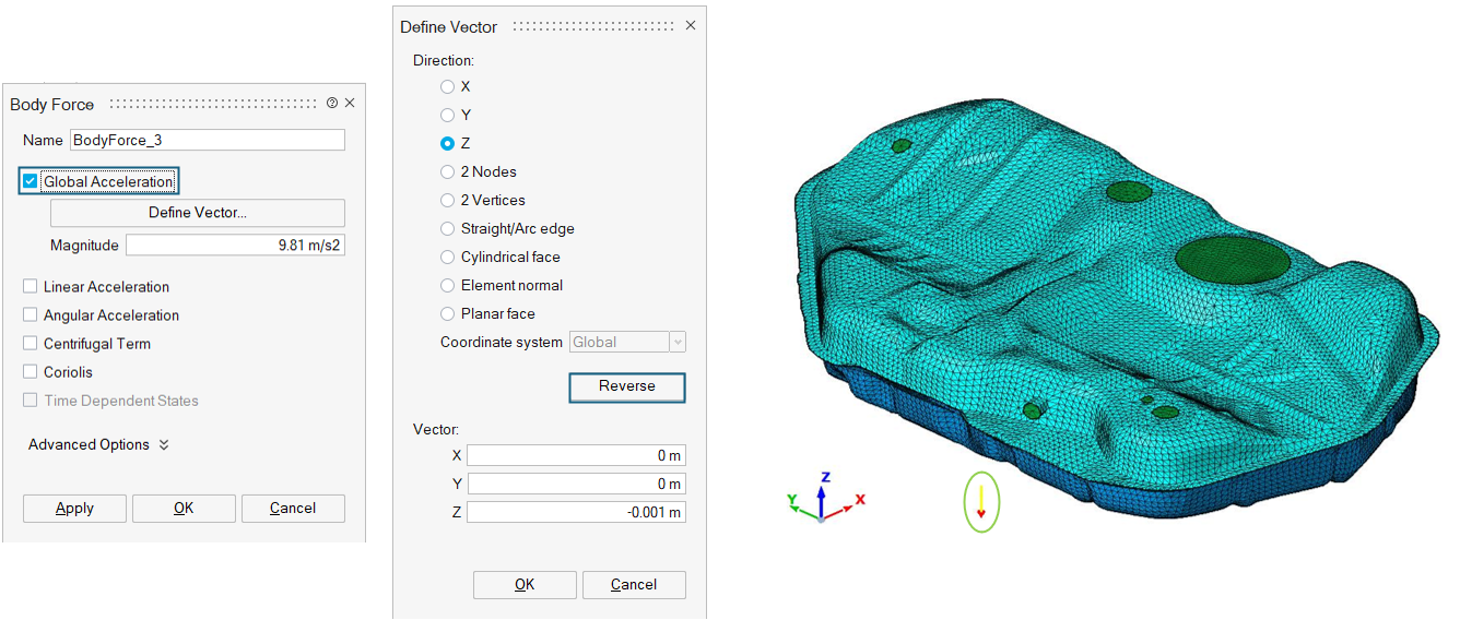

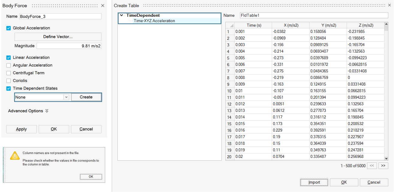

Body Force
Analysis > Boundary Conditions > Body Force
This option is used to define body force for a simulation. For Global Acceleration, the vector and magnitude must be specified. By default, the magnitude is 9.81 m/s2. It can be specified in the desired direction using a vector.
For the Time Dependent body force with different acceleration terms, a time versus acceleration table must be established. This table can be defined within the Create Table window or imported from an external source in the form of a predefined *.txt file.
