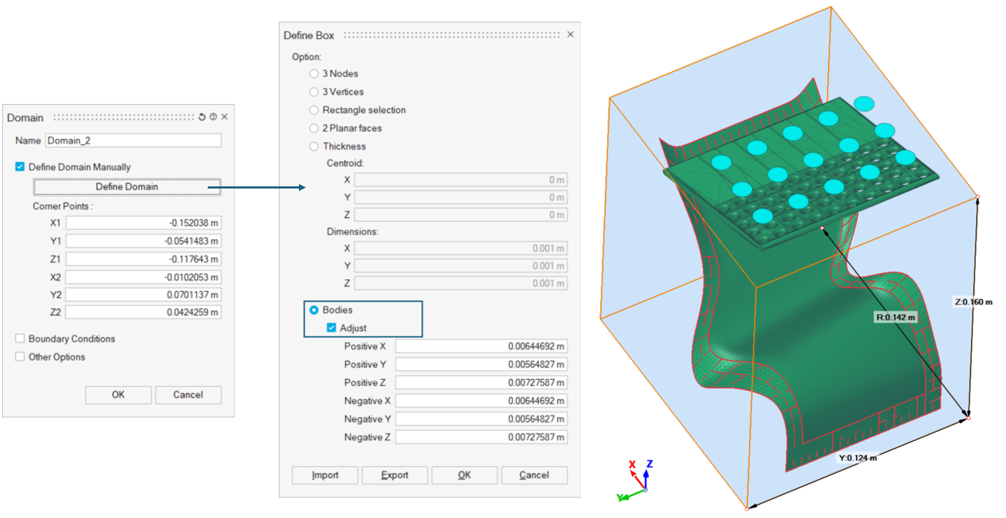

This tool is used to define the domain and global parameters of the nanoFluidX case. For a typical drivetrain simulation. If the simulation is of a closed geometry (such as a gearbox) nanoFluidX will automatically calculate the domain dimensions, so it does not need to be specified.
For other cases, especially those with open boundaries, the domain size and/or reference values should be specified.
- Define Domain Manually
If the simulation has an open boundary, or if there are periodic boundary conditions associated with the domain, it is necessary to manually prescribe the size of the domain (bounding box). In this case the padding around the particles should be set to 3*dx.

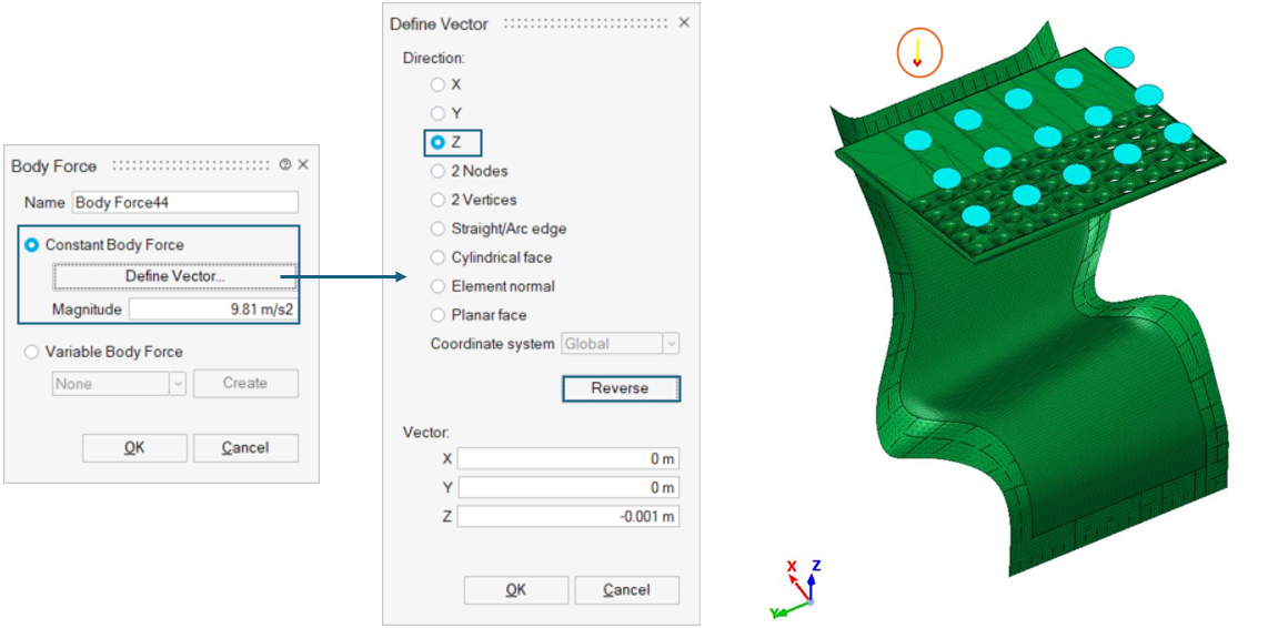

Body Force
Analysis > Boundary Conditions > Body Force
For Variable Body Force a time versus acceleration table will be defined. Define the table in the Create Table window or import a predefined table (*.txt-file).

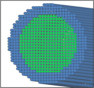

Inlet stencil is created for the inlet region which behaves as a source of particles and will be exported as a .txt file for the inlet region containing the x-, y-, and z- coordinates of the particles which are to be inserted into the domain.
The spacing of the stencil must match the dx value used for the rest of the simulation.Figure 4.

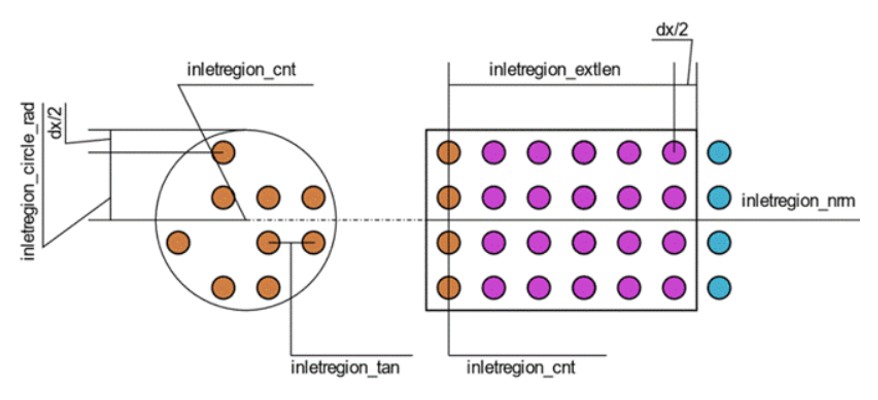

As the fluid particles leave the extension, the distance between fluid-fluid particles and fluid-wall particles are not similar. This results in a pressure rise on the side where fluid particles are closer to the wall. Depending on the severity of the misalignment, this may result in undesired secondary flows.
- Inlet Extension
The extension imposes the inlet velocity and ensures the distance between different spawn layers remaining at dx. As a result, extension is an important component of the Inlet region.
The extension covers up to half dx, further in each direction than the definitions given in the *.cfg to ensure all spawned Inlet region particles are covered. The fluid particles within the extension have the same velocity as the inlet region. It is important that the spawn area is not disturbed by other fluid particles. The extension only applies to the fluid phase specified for that specific inlet region.

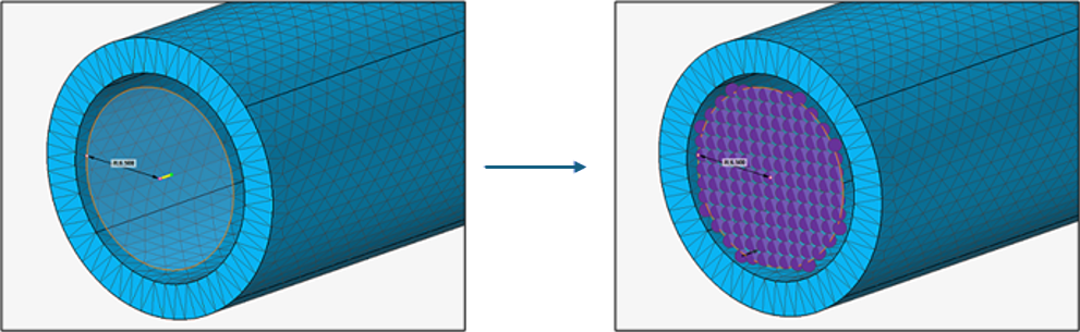

Define Inlet in SimLab
In SimLab, inlet region can be created inside the domain by using combination of inlet shapes and inlet types. After the inlet name is defined, from the material selection menu, users can define which fluid phase is going to be used for the inlet. Inlet shape can be rectangular, circular or custom. For Inlet Type, Constant or Time dependent inflow can be defined based on Velocity, Mass or Volume flow.
