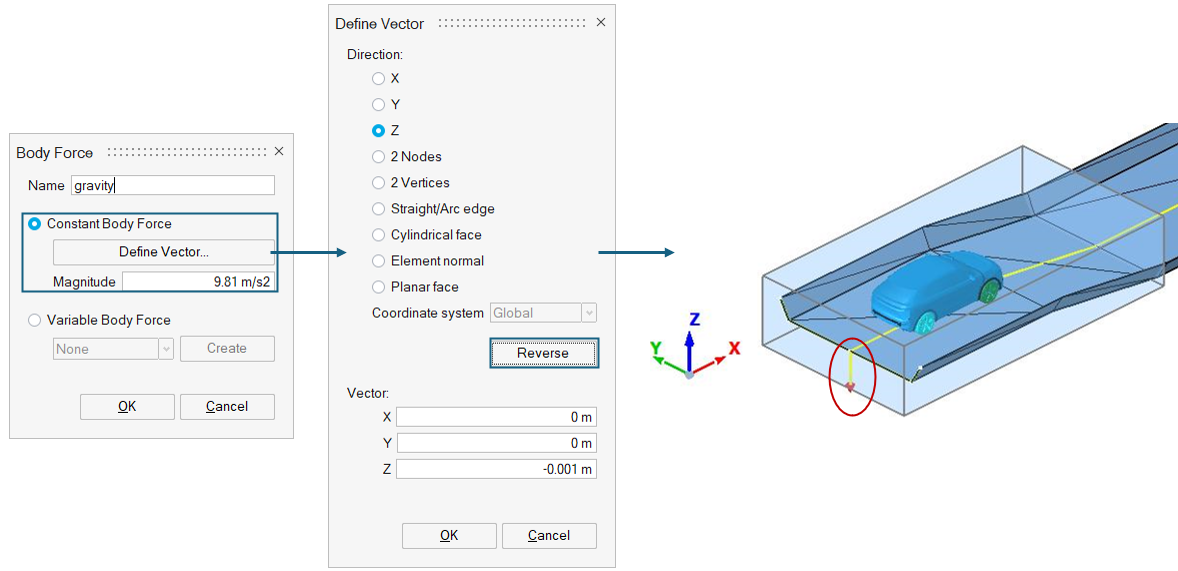

This option is used to define body force for simulation. For Constant Body Force, the vector and magnitude must be specified. By default, the magnitude is 9.81 m/s2. It can be specified in the desired direction using a vector.

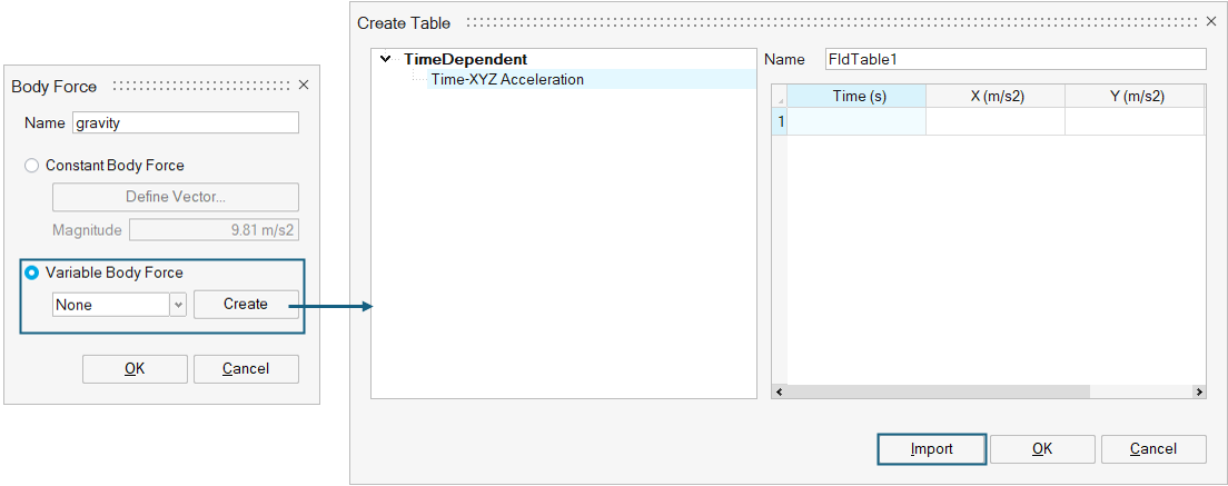

For Variable Body Force a time versus acceleration table will be defined. Define the table in the Create Table window or import a predefined table (*.txt-file).
