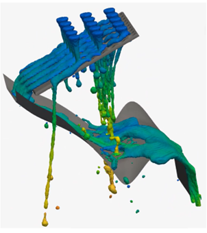

- The model is referred to as Custom Drain.
- The arbitrary geometry includes a complex shape sheet with a thicker perforated plane under an angle.
- The edges of the plate are rounded, such that contact angle effects can be observed.
- Above the perforated plate, a shower is created, and water is poured at a specific flow rate.
- The dimensions of the case are: 12.9 x 11.3 x 14.6 cm. It is discretized by 0.5 mm resolution.
- The case takes 1.5h on a NVIDIA A2000 GPU (laptop) for 5s of physical time.
