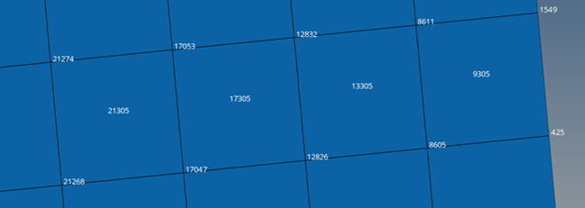

- For faces of 3D elements: Inlet velocity is applied to the element face defined via grids G1, G2, and G3 for triangular faces and via grids G1, G2, G3, and G4 for quadrilateral faces. The inlet velocity is applied in the normal direction of the faces. For quadrilateral faces, the nodes G1, G2, G3, and G4 should be input in either clockwise or counterclockwise order (the Grid order on INLTVEL should not be arbitrary).Note: The counterclockwise ordered input below.
Figure 1. 3D face example
INLTVEL 4 9305 0.2 8605 425 1549 8611 INLTVEL 4 13305 0.2 12826 8605 8611 12832 INLTVEL 4 17305 0.2 17047 12826 12832 17053 INLTVEL 4 21305 0.2 21268 17047 17053 21274
