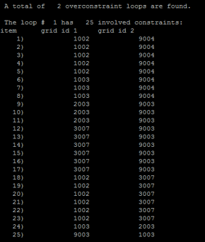

- Over-constraint check information is
printed in the .out file when JOINTG
degrees of freedom are over-constrained. This is currently only available when
the JOINTG entry is in the model, and if multiple constraints
apply on the same degree of freedom. These multiple enforced constraints create
a loop, which is now printed in the .out file, allowing you
to identify such grid points. In Figure 1, a loop can be seen as:2003 → 9003 → 1003 → 2003
