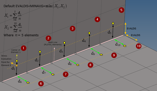

| EVALDIS | Evaluation distance in
Joint Line method. 2
(Real ≥ 0.0) |

- The distance at which the stresses
are evaluated for a particular weld is defined by EVALDIS.
The stresses are actually evaluated at the element corners (based on STRESS
output request or PARAM,CNST4FAT), and then the stresses are
interpolated to the stress evaluation point (Figure 1) for each element. This stress
is used in further fatigue calculations.
