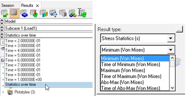

After loading the H3D file, the Stress Statistics in HyperView can be viewed.
Various statistics can be chosen from the sub-menu under Stress Statistics(s).Figure 1.
Stress Statistics output is also supported for Neuber Stresses. For Neuber stresses, the supported components for statistics output are Maximum, Time of Maximum, Arithmetic Mean, RMS, Variance, and Standard Deviation.
