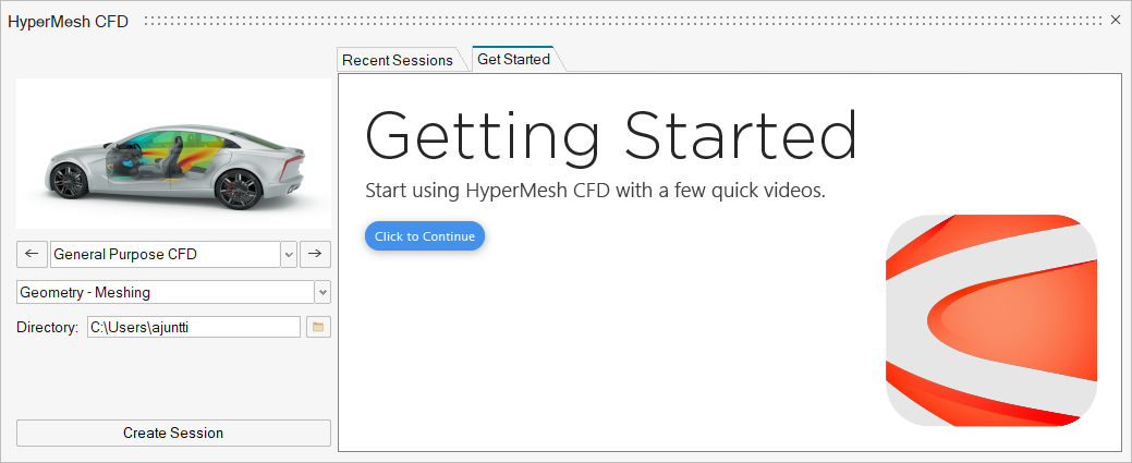

- Startup dialog
- Upon invoking the application or starting a new session, a startup
dialog is shown that allows you to select solutions of interest, the
default modeling environment, and the startup/project directory.
The getting started tab takes you to the help documentation.
Double-click on a file in the recent files tab to open it.

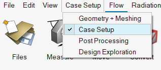

- Environments
- Environments are collections of tools based on modeling tasks. A modeling environment switcher is available on the menu bar. Selecting an environment populates relevant ribbons and tools. If data transfer is required across modeling environments, a data transfer tool is invoked to ask you about appropriate selections. Each solution can have different modeling environments.
