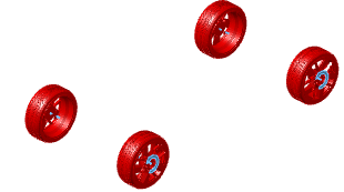

Wheels
When modeling a wheel, a wall boundary condition is prescribed, and – when the Rotating wheels option is enabled () – a rotational velocity – based on the distance from the axis of rotation to the ground – is applied. Once you select the parts forming the wheel assembly, parameters like the center of rotation, axis of rotation, and angular velocity (in RPM) are computed automatically (these may be overwritten by the user by disabling “Auto Calculate” – see step 6). If multiple parts are selected, the parts will be grouped into one or more wheels. For example, if you select the brake disc, the rim and the tire of the left front wheel, all three parts will be identified as wheel_1. If you also select the rim and the tire of the left rear wheel, those parts will be grouped into wheel_2.
Identification
To view only the parts that make up the wheels, you will need to hide the rest
of the parts.
- In the , select the Wheels assembly.
- Right-click and select Isolate from the context menu or press I to isolate the wheel geometry.
From the Setup ribbon, click the Identify
Parts tool.
From the secondary tool set, click the Create Wheel
tool.
Select all Wheels parts.
Figure 3.
- Click on the parts now identified as wheels in the Model Browser.
- In , ensure that Auto Calculate is enabled.
- Press Esc or right-click in empty space to exit the tool once all the wheels have been identified.
