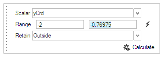

Y-Clip Vehicle Front Axle Center | Right
From the Post ribbon, click on the Scalar
Clip tool.
Figure 3.
The Scalar Clip guide bar opens. -
From the Scalar Clip guide bar, set the entity
selector to Boundary Groups, then click
on the vehicle.
Figure 4.
The Vehicle boundary group is highlighted, and the Scalar Clip guide panel opens.. - Select yCrd from the Scalar drop-down.
Set Range from -2.0 to
-0.82434.
Note: The value of -0.82434 pertains to the y-midpoint of the front-left tire. You may calculate this value from the data contained in Wheel_Tire_Front_Left.csv, which was created following the steps in the Save Boundary Information section.
- Select Outside from the Retain drop-down.
- Press the Calculate button.
- From the Scalar Clip guide bar, press the green check mark button to accept.
- Rename the new clip as Y-Clip Vehicle Front Axle | Right and hide the clip.
