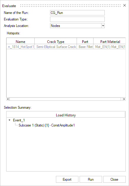

Use the Run Analysis tool to set up and launch the evaluation.
From the Evaluate tool group, click the
Run Analysis tool.
The Evaluate dialog opens.Figure 2.
- Optional: Change the name of the run.
- Review the selected parts, hotspot name and loadcase.
Click Run.
