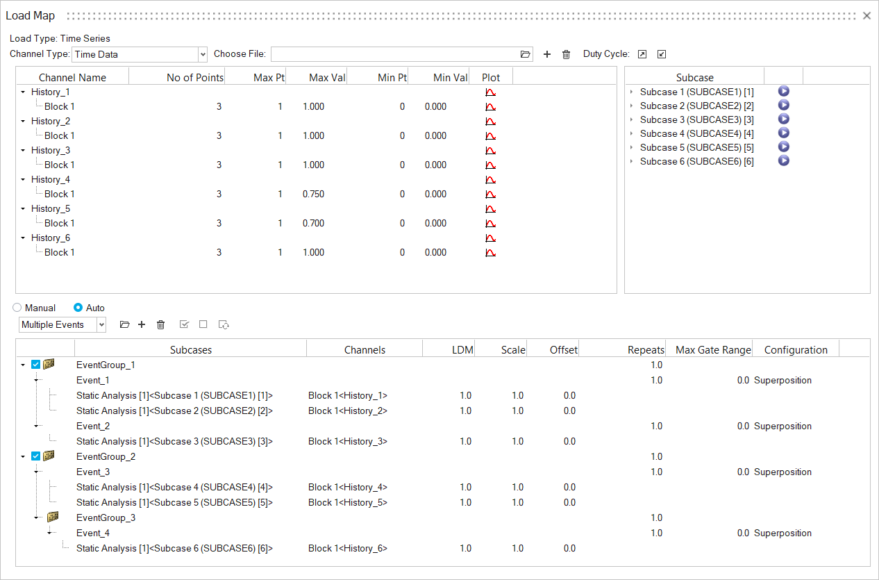

Create Event Group
Events groups can be created to combine required event combinations. See Figure 6.

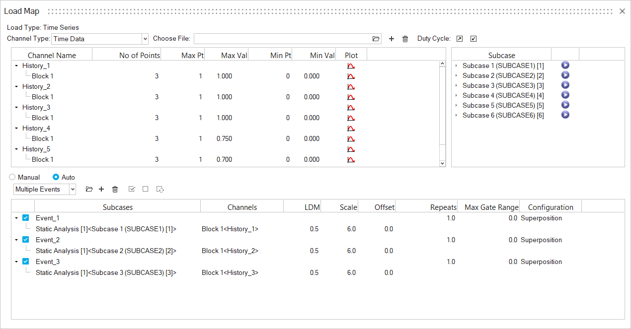

Example of HyperLife Duty Cycle with Events. as seen in _____
<?xml version="1.0" encoding="UTF-8"?>
<HyperLifeInput profile="CrackGrowth" version="2024.1.0.31-HYLCG">
<LoadMap typeofloading="Time Series">
<Channel>
<tabfat id="1" type="Time Data">D:/History_1.csv</tabfat>
<tabfat id="2" type="Time Data">D:/History_2.csv</tabfat>
<tabfat id="3" type="Time Data">D:/History_3.csv</tabfat>
<tabfat id="4" type="Time Data">D:/History_4.csv</tabfat>
<tabfat id="5" type="Time Data">D:/History_5.csv</tabfat>
<tabfat id="6" type="Time Data">D:/History_6.csv</tabfat>
</Channel>
<FatigeEvents>
<Event Configuration="superposition" Gate="0" id="1" name="Event_1">
<Fatload LDM="0.5" Offset="0" Scale="6" block="1" resultfile="" sim="1" subcase="1" tabfatId="1" tabfatName=""></Fatload>
</Event>
<Event Configuration="superposition" Gate="0" id="2" name="Event_2">
<Fatload LDM="0.5" Offset="0" Scale="6" block="1" resultfile="" sim="1" subcase="2" tabfatId="2" tabfatName=""></Fatload>
</Event>
<Event Configuration="superposition" Gate="0" id="3" name="Event_3">
<Fatload LDM="0.5" Offset="0" Scale="6" block="1" resultfile="" sim="1" subcase="3" tabfatId="3" tabfatName=""></Fatload>
</Event>
</FatigeEvents>
<Fatseq>
<Fatevnt EventId="" EventName="Event_1" Repeats="1" Status="true"></Fatevnt>
<Fatevnt EventId="" EventName="Event_2" Repeats="1" Status="true"></Fatevnt>
<Fatevnt EventId="" EventName="Event_3" Repeats="1" Status="true"></Fatevnt>
</Fatseq>
</LoadMap>
</HyperLifeInput>
Example of HyperLife Duty Cycle with Event Groups, as seen in Figure 6.
<Channel>
</Channel>
<FatigeEvents>
<Fatload LDM="1" Offset="0" Scale="1" block="1" resultfile="" sim="1" subcase="1" tabfatId="1" tabfatName=""></Fatload>
<Fatload LDM="1" Offset="0" Scale="1" block="1" resultfile="" sim="1" subcase="2" tabfatId="2" tabfatName=""></Fatload>
</Event>
<Fatload LDM="1" Offset="0" Scale="1" block="1" resultfile="" sim="1" subcase="3" tabfatId="3" tabfatName=""></Fatload>
</Event>
<Fatload LDM="1" Offset="0" Scale="1" block="1" resultfile="" sim="1" subcase="4" tabfatId="4" tabfatName=""></Fatload>
<Fatload LDM="1" Offset="0" Scale="1" block="1" resultfile="" sim="1" subcase="5" tabfatId="5" tabfatName=""></Fatload>
</Event>
<Event Configuration="superposition" Gate="0" id="4" name="Event_4">
<Fatload LDM="1" Offset="0" Scale="1" block="1" resultfile="" sim="1" subcase="6" tabfatId="6" tabfatName=""></Fatload>
</Event>
</FatigeEvents>
<FatigueEventGroups>
<EventGroup id="1" name="EventGroup_1">
<Fatevnt EventId="" EventName="Event_1" Repeats="1"></Fatevnt>
<Fatevnt EventId="" EventName="Event_2" Repeats="1"></Fatevnt>
</EventGroup>
<EventGroup id="2" name="EventGroup_2">
<Fatevnt EventId="" EventName="Event_3" Repeats="1"></Fatevnt>
<Fatgrp EventId="" EventName="EventGroup_3" Repeats="1"></Fatgrp>
</EventGroup>
<EventGroup id="3" name="EventGroup_3">
<Fatevnt EventId="" EventName="Event_4" Repeats="1"></Fatevnt>
</EventGroup>
</FatigueEventGroups>
<Fatseq>
<Fatgrp EventId="" EventName="EventGroup_1" Repeats="1" Status="true"></Fatgrp>
<Fatgrp EventId="" EventName="EventGroup_2" Repeats="1" Status="true"></Fatgrp>
</Fatseq>
</LoadMap>
</HyperLifeInput>
