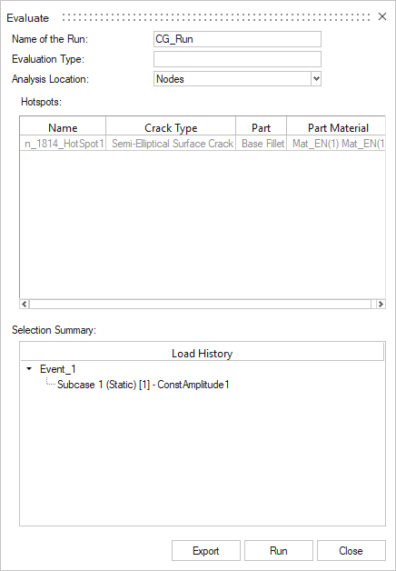

From the Evaluate tool group, click the Run Analysis tool.
The Evaluate dialog opens.
- Enter a name for the run.
Click Run.
Result files are saved to the home directory and the Run progress bar appears in the status bar.

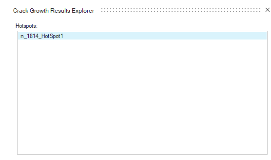

- Once the run is complete, click the Evaluate icon.

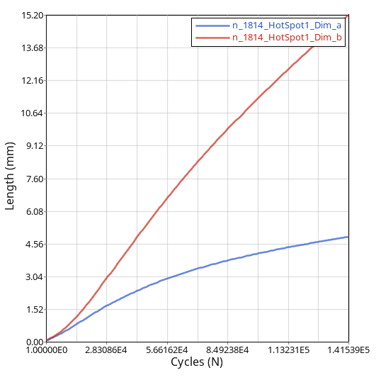

Use the Results Explorer to select the hotspot and review its rate of crack
growth.
Figure 3.
