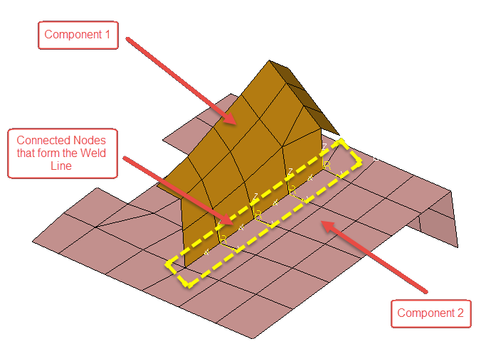

The current version of HL-WC supports one type of weld connection modelling:
- node2node
- In this method of weld modelling, the plate components are connected using
common nodes known as shared edges. For automatic detection of
node2nodewelds, the below conditions must be met.
- The connected shells must share the same nodes at the weld line.
- The connected shells must be organized in different components.
