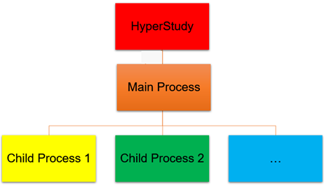

This phenomenon happens when the main process launched by HyperStudy is terminated before child processes created by the main process.
HyperStudy expects the process hierarchy to be maintained. Hence, all child processes must finish prior to the main process for the solver job to be complete.
Warning: run (#), model (m_#), Execute (pid = #) process group has not finished completely after 2000 ms. Attempt to wait an additional 600000 ms before killing the remaining processes.
The main process or solver has finished, but it left child processes behind that are still running.

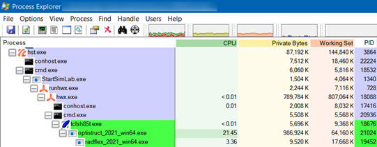

Figure 2 shows an example case from Process Manager: HyperStudy (hst.exe) invokes SimLab (StartSimLab.exe is the main process) and SimLab calls OptiStruct (optistruct_2021_win64.exe) to solve a numerical analysis. OptiStruct process becomes one of the child processes.
